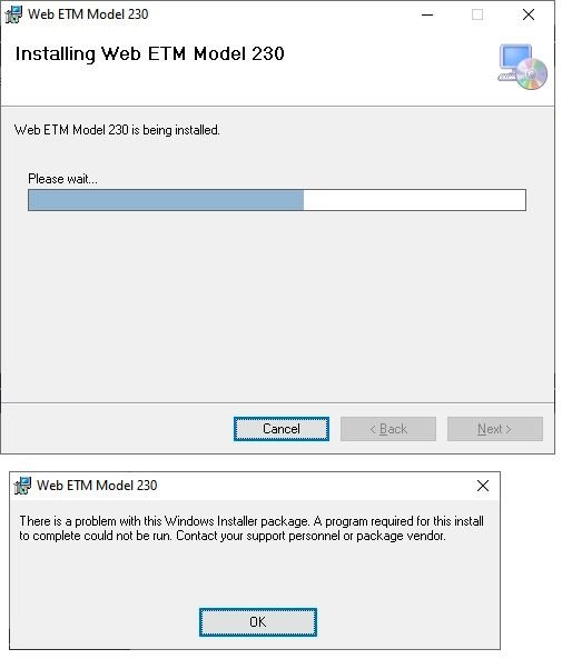

Originally Posted by bobterry99
The file you download is "Setup Web ETM Model 230.msi", and it is self-opening. It's like a .zip file in that regard, but it also installs the application "Web ETM Model 230" on your PC. Once installation completes you will have a shortcut in your Windows Start menu to launch the application.
In the course of downloading or opening drawings you will likely get a message cautioning you not to, since the source of the application (me) is unknown to Microsoft. I guarantee that I bundled no malware with this application, so it is safe to override Windows Defender or whatever anti-malware software you may be using.
Hi Bob, I am running on win 10, but can't complete the app, is it an obvious fix?
