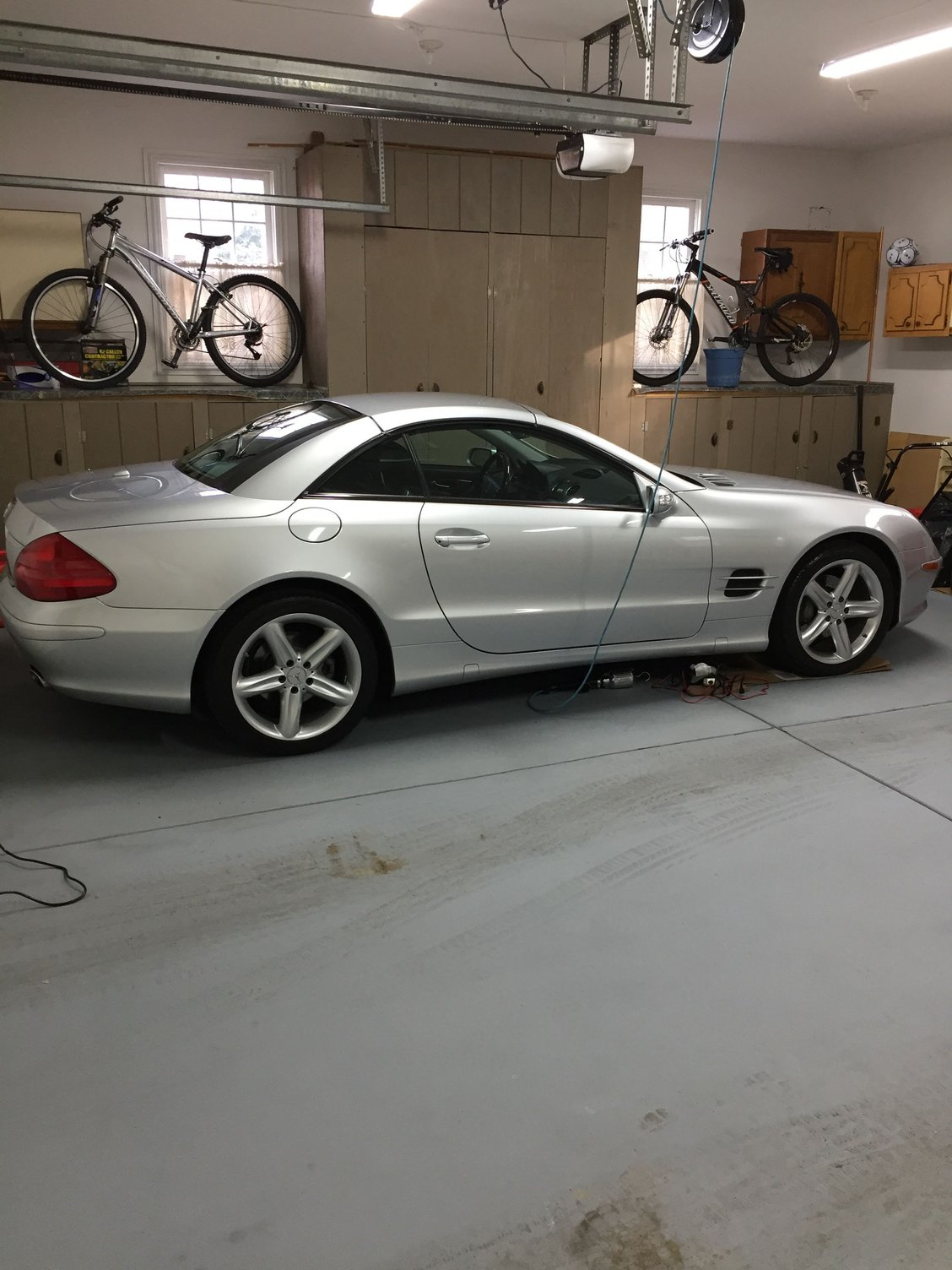

Bought my 04 SL600 V12 twin turbo 2 years ago with 87K miles. Since then I have had the trans serviced, rear differential serviced, SBC fluid and brake fluids changed, a hose to the intercooler system began to leak so we replaced every coolant hose on the car as they were 14 years old, all new coolant, a few oil changes, then the driver side coil pack went bad. Removed that and had it rebuilt by Clark the guy in California, while that was out I also removed the passenger side coil pack and took out all 24 spark plugs which appeared to be original from the factory. All new and correct spark plugs (NGK Iridium as prescribed in owner manual) and runs like a champ. I took out the ECU and sent it to Kleemann for a tune as they had a special going on for around $600 and they reported back that the RennTech folks had already been there and i should have over 630HP already with no other mods! Put the ECU back in and contacted the Previous owner who confirmed that he had in fact done the RennTech ECU tune as well as the intercooler pump upgrade. So I went to my local exhaust shop that's full of motor-heads and removed the little mufflers at the rear of the car. The day I first got this car it was amazingly fast, it seemed like someone had stolen an engine off a Boeing 747 and stuck it under the hood. I got a carbon fiber rear spoiler and matching carbon fiber-look sticker material for the two panels each side of the back window as the black pieces there had been in the hot Arizona sun. no-where else on the car showed any wear from intense sunlight. The car had been in Arizona almost all its life having been purchased new in Brooklyn New Yourke, USA and living there a few years. The car has been rained upon one time in my possession for about 15 minutes. I figure this car has close to 700HP and looks as new, runs as new. For SL's - First I had a R107 1980 450SLC then a 1991 R129 500SL, then this R230, with a whole pile of W124s and W140 and W202 in between, with an ML W163 and W220 and X164 SUV in there too. I certainly do as much as I can on these cars, the coilpacks and spark plugs were actually pretty easy to do maintenance on. With new spark plugs now I doubt the second coilpack will go bad, it's my belief that when plugs wear that causes the coilpack to quit. The only thing that's nearly due to get serviced would be the ABC fluid, I'll have that done or do it myself by springtime. This car covered about 3000 miles the first year, so I am trying to use it more often but only if there is no rain, and certainly not snow!! Hell of a car that cost $136,000 new and still looks like new and there is almost nothing anywhere that is faster! Just have to Always be careful with this much power. LOL

Oh and I also bought genuine AMG tail lights assemblies for almost $800, crazy I know, and have yet to put those on the car..

Originally Posted by tonylinc
Always wanted a V12TT in proper German silver. Nice car!
You said this was an AZ car, which means temps under the hood will be extreme when you stop. I know...I lived in PHX for 7 years.
Good that you replaced the coolant hoses. Expect all the vacuum hoses under the hood will go as well before long. Fortunately, there are not many. I recommend the silicone hoses to replace them.
