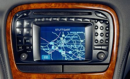

If on the other hand you have one of the earlier SL models (2003 -2004), which had the Comand 2.0 with a 4:3 screen. Those units were integrated, and the navigation processor was in the head unit.
Here is what the Comand 2.0 looks like:

Right ok - I have the 2003 model, r230. What next?

What happens when you press NAV? Do you get a message of sorts? Does it say something like "No Navigation disc", or "Insert Navigation Disc"?
If not, or if you just get a compass, then most likely there is no navigation processor, so you'd have to replace head unit with one that has navigation. You will also need an antenna with a FAKRA connector.
Needless to say, you will also need some map discs, which are on CD for this system, so they cover relatively small portions, which means you'll have to have multiple CDs to cover a larger portion of the EU. But let me say this, the latest maps available for this system are way out of date, 2008 I think are the latest available.
My suggestion is to buy an aftermarket radio and do a complete revamp of the entertainment system.
