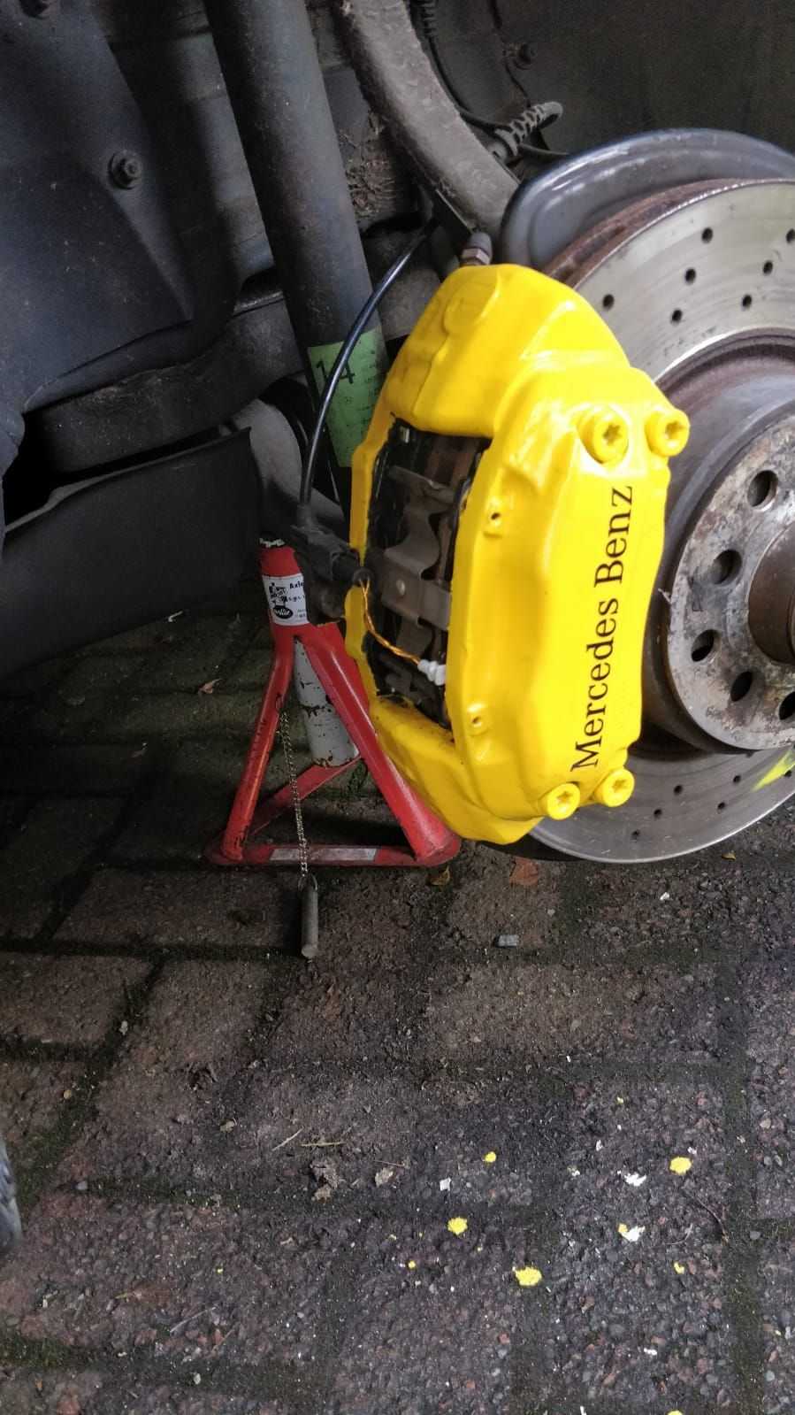

How do you reset the 'Brake Service' warning after changing pads and sensor?
My dash last week showed 'Brake Service visit workshop', I had already replaced the rear pads in the summer so I checked the front pads and could see they were worn down and needed to be replaced.
Bought some Brembo pads and a new Bosch wear pad sensor and fitted them (so easy by the way !). I could see that the old sensor had been worn to trigger the dash warning so fitted the new sensor.
However despite changing for new sensor the dash warning is still there. I know the sensor is good as if I change this for another one that I had the message remains. Also if I do not push the sensor all the way into the plug then I get a second error on the dash stating the 'Wear pad sensor' so I know I have plugged it in correctly.
I have tried the reset by pressing the gas pedal for 10 secs with the key on then switching it off and removing the key but no joy (unless I am doing this wrong?)
Anyone know how to reset the dash message?
P.S whilst I had the wheel off I decided to paint the calipers with new decals and also changed a track rod arm as it was worn.

  8. Switch on ignition through window to position 2
  9. Switch off ignition, wait 1 - 5 secs then switch back on position 2
  10. Rotate rear wheel.How if the car is in PARK?, you cannot press brake as stated in step 5!!?
  11. Rotate front wheel swiftly and evenly in running direction 1 -2 revolutions (observe 3 flashing lights) No lights flashed for me
Have I missed something here? How do I rotate the rear wheels without pressing the brake and moving the gear shift?
thttps://youtu.be/4B3wX5-cYng hanks
I'll take a stab at this.
This procedure is intended to have ALL 4 wheels off the ground (use stands, or crates or something). When you place a car in PARK (P), it doesn't block the wheels, it blocks the transmission, which locks your drive shaft in place. However, because your drive shaft is connected to the rear wheels through a differential, the wheels can still be turned, it's just that when you turn one wheel in one direction, the other wheel turns in the opposite direction. But if one wheel is blocked, the you won't be able to turn the opposite one. Does this make sense?
So, in your case, since one half of the car had the wheels on the ground, you couldn't turn the rear wheel.
Step 5 states "(brake pedal must not be pressed from now on)"

im currently in asda car park in level ground to try again !
So with all the wheels off the ground I can now turn the rear wheels thanks. I did the procedure about 5 times but it didn't change anything unfortunately.
I believe I have followed the procedure correct as when I turn the rear wheel and front wheel they automatically brake after a couple of turns, then release etc, however I did not get the three tail light flashes to indicate it was successful.

The only thing I can tell you is to carefully read the entire procedure, and make sure you follow the timing correctly. If you miss the timing, it won't work. Start from the beginning, and follow all the steps as described. Read the little sections market with an "I" as those are important pieces of information. I'm sure you'll get it right.

Whenever Ive done brake jobs on my cars with SBC brakes Ive just removed the plug from the SBC ECU attached to the pump. Take seconds.
Any error messages clear after a few brake pumps but I dont normally get a message.

So I got my icarsoft and tried to clear the service warning light, but it didnt work sadly. I ran the test and it advised that all was good and the results came back even on all pads.. Tried to clear any historic faults but no joy.
