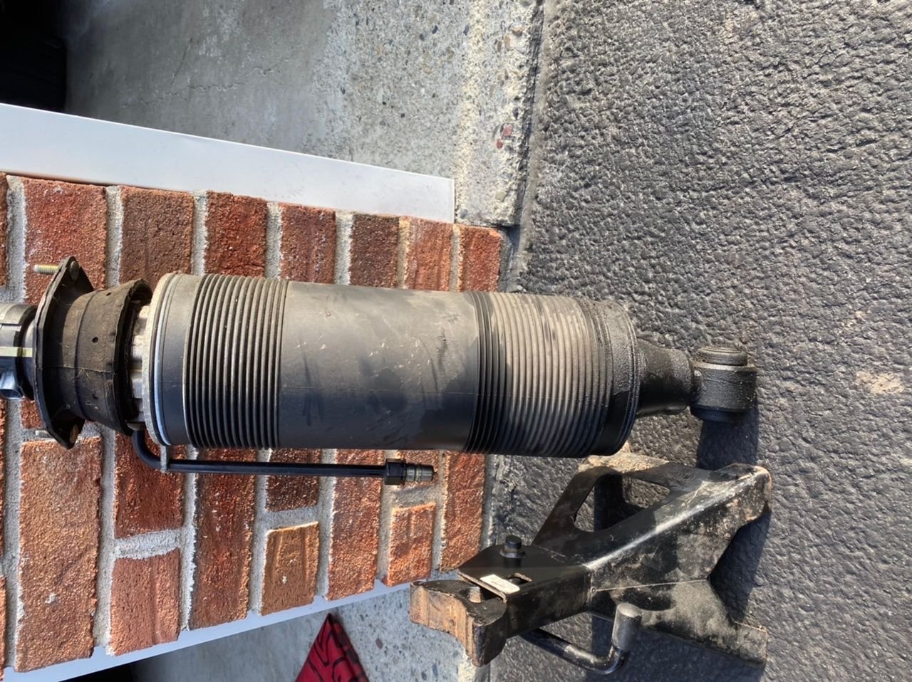

Old Apr 12, 2020 | 10:04 PM
Jay04SL's Avatar
Joined: Mar 2012
Posts: 120
Likes: 16
2004 SL500 // 2015 S550
This was my old OEM strut. Leaky at bottom but never fully gave out. Was dripping from the control arm though.
Old Apr 13, 2020 | 08:54 AM
George993's Avatar
Joined: Dec 2015
Posts: 502
Likes: 145
From: Tampa Bay, FL
2014 E350 Wagon, 2009 SL550 no ABC
Jay04SL Congrats on the job well done!
But I'm surprised with your comment: "I had to drop the exhaust at three points to clear removal of the inner control arm bolt towards the rear." Sorry if that point of my instructions was not clear, but I never had to touch the exhaust - if we are talking about the same bolt, it came out easily after:
1) Disconnecting the stabilizer bar as shown on the photo titled "
This is the stabilizer bar (left) disconnected at the hub (right)" above
2) Pushing the stabilizer bar down by hand from the outer side, as it pivots on the inner (at the car center) side and clears the arm bolt for withdrawal
There should only be a total of 5 nuts to remove - 2 for the suspension and 3 (one at the bottom and two at the top) for the strut itself. All 5 easy to access and easy to undo unless the car is rusty. Or perhaps your car is different than mine 2003 SL500? In any case the job is completed so in one sense it does not matter for this case, but for the benefit of others and to keep it as simple as possible - could you please elaborate exactly why you had to do it? Thanks!
How hard is it to remove the dust boot from the shock? I have this job on my to do list but to be honest im not looking forward to it. I dont seem to have circlip pliers either.
