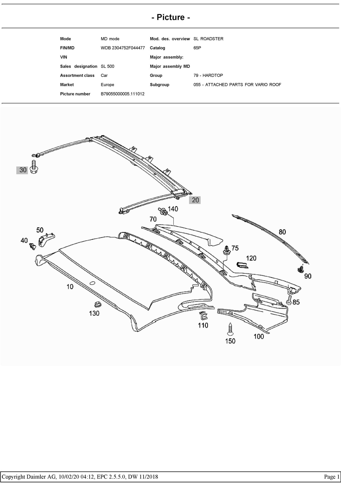

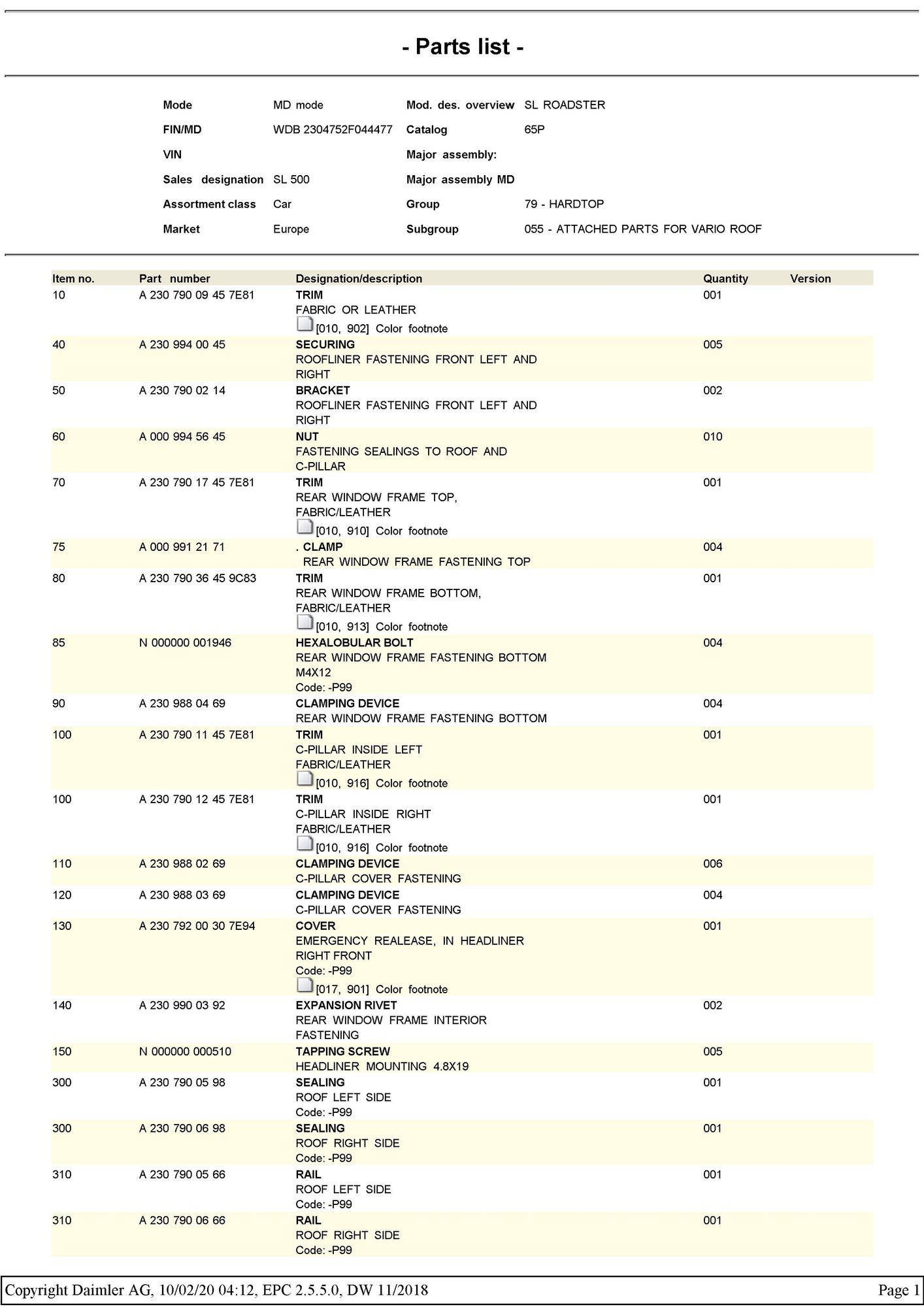

See if this helps:
http://benzbits.com/r230/roof/LiningPartsDiagram.pdf
http://benzbits.com/r230/roof/LiningPartsList.pdf

There are some u-shaped plastic pieces that are glued to the headliner and plastic push fasteners (like on a door panel) that push into holes in the roof. The u-shaped pieces are not available separate from the headliner. The push fasteners are #75 in the diagram above.
