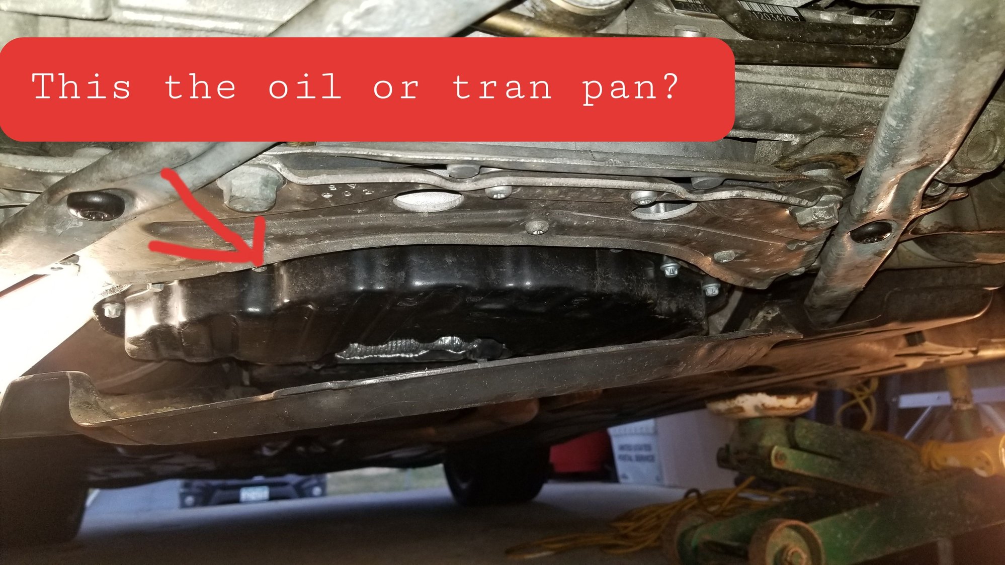

I've removed the two frontmost panels (see pic) and I'm not seeing a drain bolt. There is a sheet metal type pan further back just where the 2nd and 3rd panel (which I haven't removed) meet. I'm wondering if that is it or if it's the tranny pan. Seems a little far back for an oil pan but this is my first MeBe and I know they do things different. That third panel is going to take a little work to get off as I can't get under there when it is on ramps. So I don't want to do it if I'm just spinning my wheels. See attached pics.

Took that 3rd panel off and the oil pan bolt was viewable and accessible. Man they put the oil pans far back in these cars.

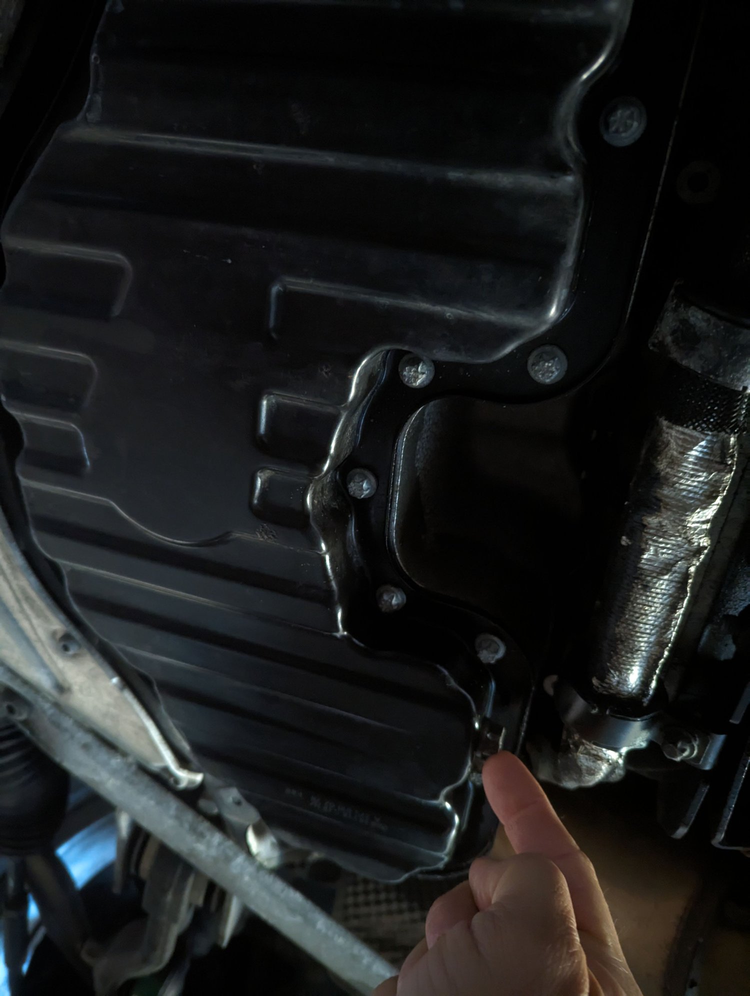

To answer your original red-arrow question most directly, you have pictured the oil pan, and the drain plug faces the rear of the car, the side opposite of that shown, on the passenger side of the rear of the pan. So yes, you may need to remove one more panel to access that. As for ramps, Autozone ramps will not work (not tall enough). I made custom ramps from 2x10s and other 2xscraps to get a 10-inch ramp height (pictured). Thankfully, I have never driven it off the ramps, so be very careful at your own risk. I just drained and changed my '05 SL600 oil now, and for years I had no idea if there was a drain plug or where it was. I actually had to see it on a lift for the first time, so you are in like company! When they are well-maintained, your SL600 will drive just about as close to a modern-day Bentley Continental GTC V12 as you can get, so enjoy!!!

For any future DIY'ers, my finger is on the drain plug in the following picture. You will need a 13mm socket to remove it, and just in case you want to make your life easier, a fumoto valve will not fit this location because the drain plug is in too tight a position. If anyone solves that challenge - please let us know!.
My finger is touching the 13mm drain plug in this photo (no room for Fumoto though...).
