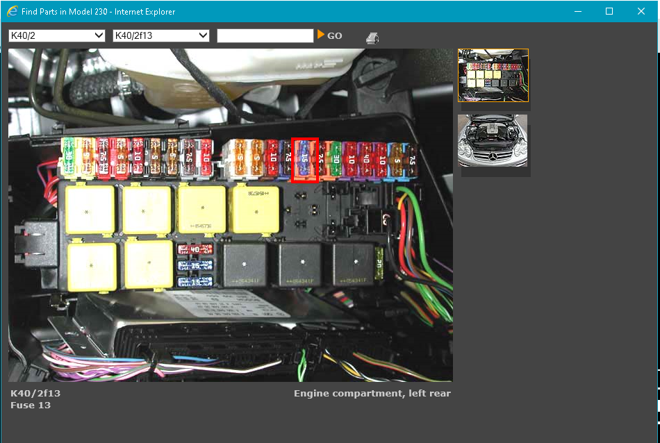

It seems both your front and rear ABC valve blocks are defective or are in need of a rebuild, but if this were the case I would expect the chassis to begin rising the moment you turned the engine on. So I suggest the following test.
Start the engine. Press the rid height button three times to restore the chassis level to its normal position. Switch the engine off. Remove the blue15-amp fuse from the main fuse box (picture) to remove power from the ABC controller. Drive the car and see if the level changes; if it doesn't, then you have an issue with the ABC controller or one of its sensor inputs.
