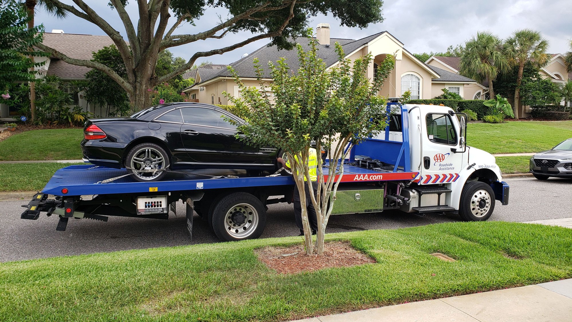

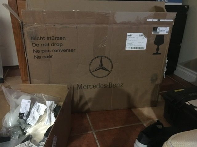

I did re-calibrate today, and spent some time with my SDS and the car. Got everything I wanted done. Car still raises in the rear when turned off.
Unfortunately, ran into an issue when I pulled the car out of my garage... My radiator gave out. Fluid everywhere. Ordered a new radiator and sent it on a tow truck to my warehouse, where I would have help and tools to install a new radiator.
I am still stumped on the ABC but wont be able to do any testing until I get around to replacing the radiator. Hopefully next week.
Still open to ideas about the ABC issue.
