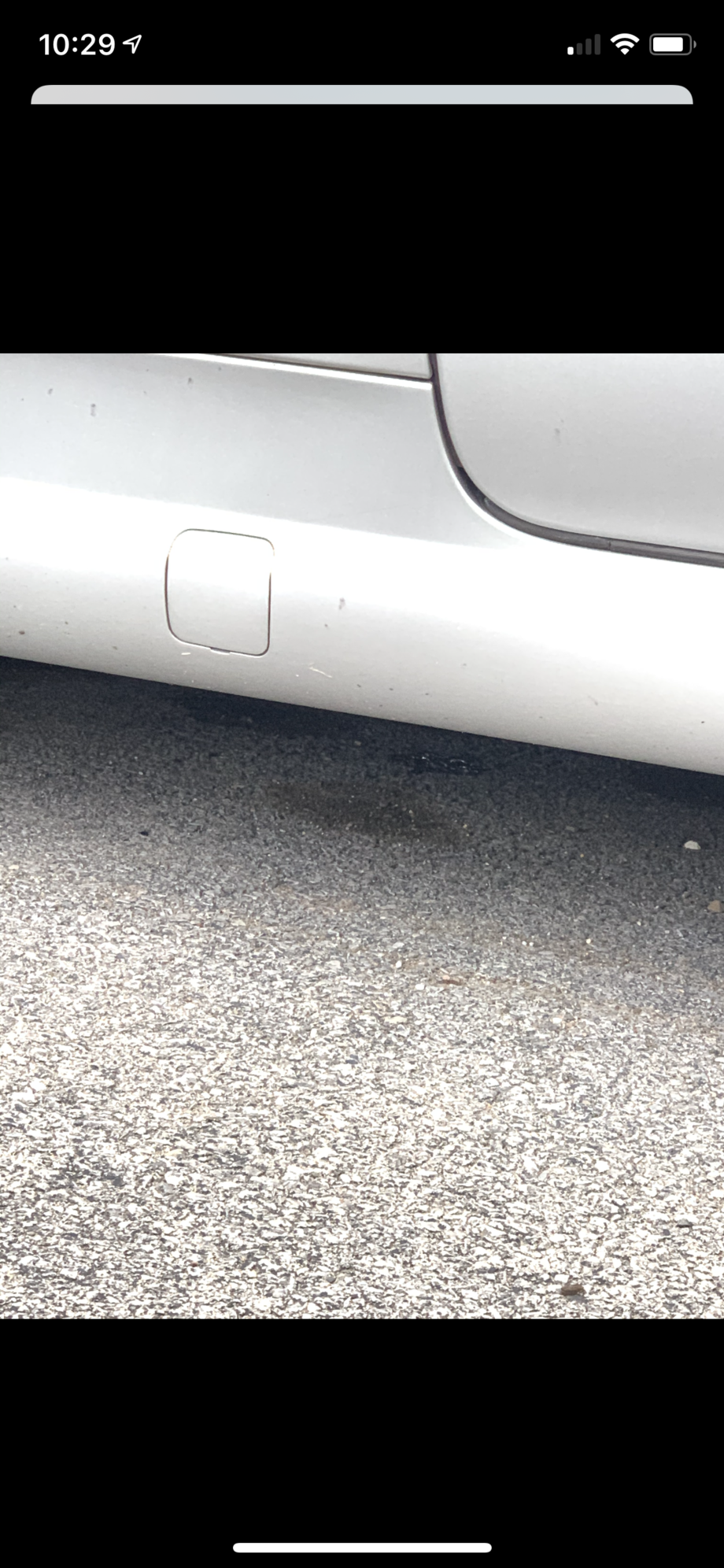

I noticed tiny spots in my driveway recently and assumed it was my pilot connector bushing on the tranny. But I wanted to check a little more with a camera and now see tons of oil.
Last night after a drive I pulled in the driveway and this was the size of the puddle that dripped freshly. It’s now about double the size. It’s by the door and past the wheel about a foot into the width of the car

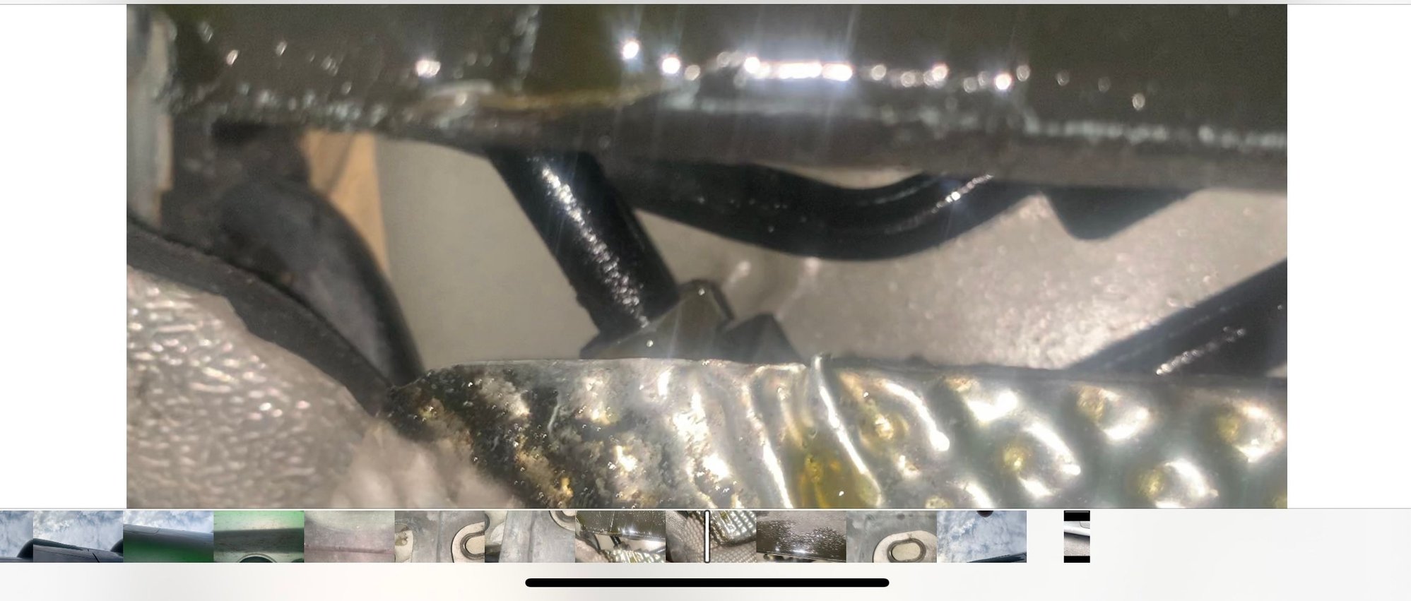

In this video it actually looks like an abc hose is soaked? Is there one that’s in that spot? I don’t have my transmission cover on so you can see clearly
Could this actually be ABC fluid?

Yes, that is ABC fluid.
DO NOT DRIVE THE CAR until you figure out where the leak is coming from.
I assume your car is model year 2006 or older. You need to remove the front wheel well lining to get to the pulsation damper / pressure valve assembly located behind the fender.

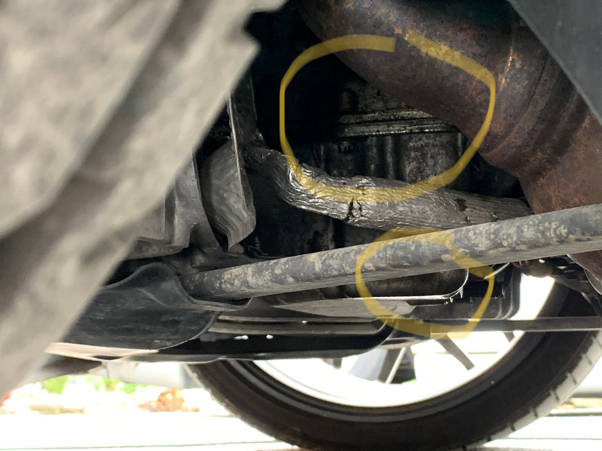

What is this? I just looked under the car and see the same oil there. Drip trail down there

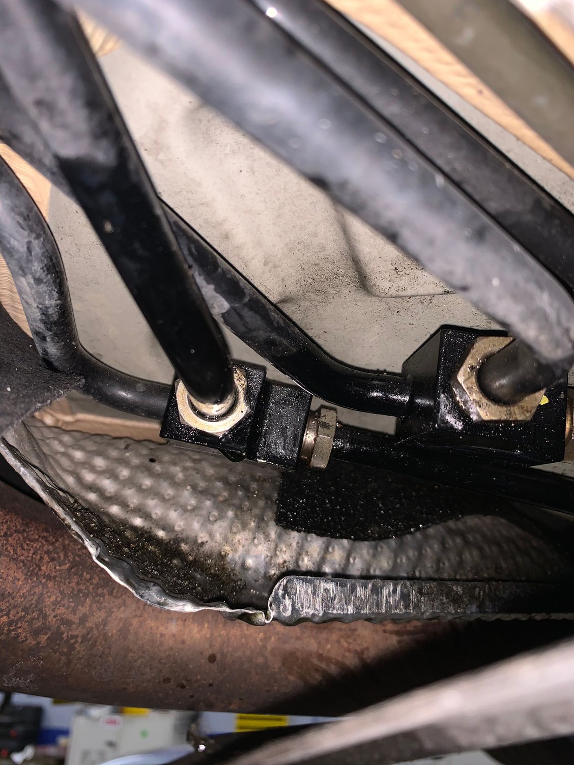

Looks like those block is leaking.
Ordering a new hose, part is $130 labor much more!

Have ABC lines been replaced on this car in the past?
The metal lines with the square blocks welded to them are connected directly to the front valve block.
When those lines are replaced, it of course is necessary to unscrew the two lines attached to each of the square blocks. The first thing I would do is have all four of the lines unscrewed from the blocks and then retightened and property torqued.
The problem you might be having could be caused by the threaded fittings that hold those lines to the blocks not being tight enough or they were cross threaded by a careless mechanic when the lines were replaced.
I wouldn’t replace any parts before checking this.

Hi Sivi,
Thanks for the input. I literally held off for now to see my options. The mechanic at the shop actually suggested that the fitting might be loose and he tried to tighten it but it was tight to no avail.. we started the car on the lift and it had a very slow drip. He said I can still drive it but watch the fluid level. Good it’s not a hose. In the past perhaps before my ownership. But the leak is new so I wouldn't think it's something recently.
Do you think that full throttle sealer can fix this?
I was quoted 6 hours of labor because he said the hose goes all the way to the front of the engine.

I know right! I'm scratching my head. Do you mean hose 340(red)?
we started the car on the lift and it was clearly coming right out of the nut(yellow circle)

Did your mechanic unscrew that line and check the threads?

negative, just tried to tighten it and it wouldn't move.

Have them bust it loose and retighten, it might have been cross threaded. It will take all of 5 minutes.

wish they tried that when I was there! Place is an hour drive from my house..There’s no reason it should be leaking in that area right? Is that area pressurized? Could I do it myself? Don’t think there are any seals in there or rings like he mentioned. I just took the car and drove back home washed it and put it under a cover -,-

That particular line/fitting is under high pressure when the engine is running.
I’m concerned your mechanic didn’t have enough common sense to try this while you were there. How much further away is a larger city that might have better shop?

Well good news..The leak is fixed!!
I took it to a guy here locally and he was able to disconnect and reconnect it and we added a bit of teflon as another extra measure- leak no more!!
It was super strange and he has never has seen that either..literally coming out of the bolt.
In the process we inspected other lines on the car and found some seepage on the hose near the pulsation dampener behind the front wheel well. Will order the part and replace.
