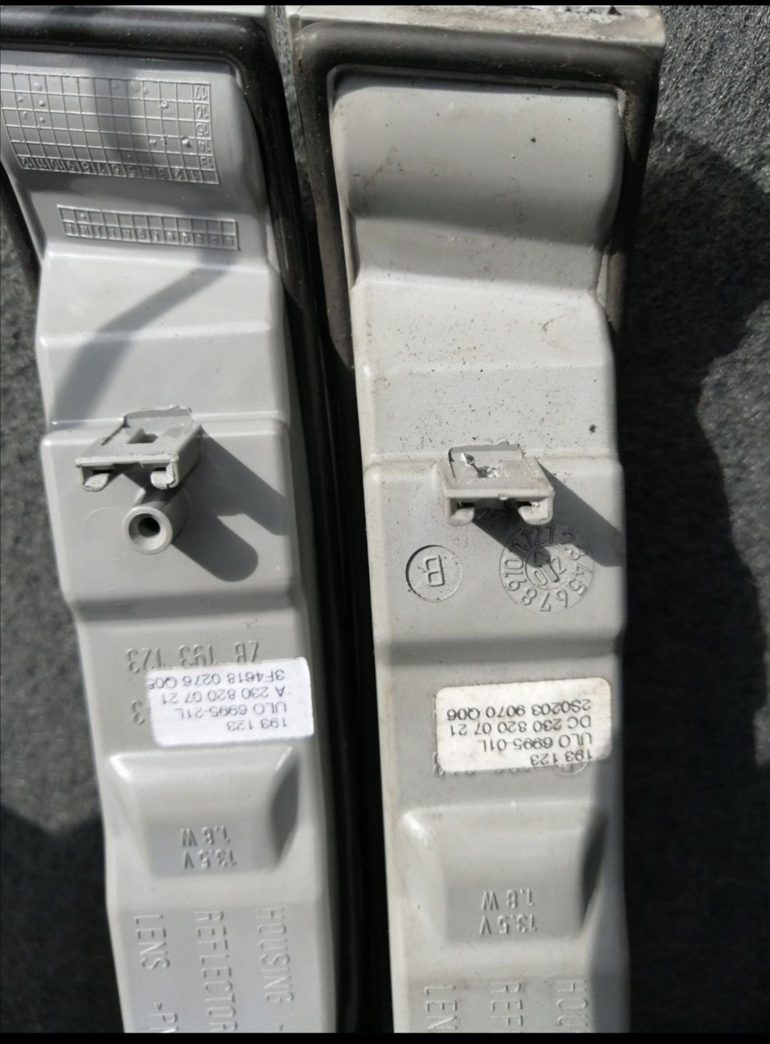

New on the left old on right.

Interesting that they didn't change the P/N and that they kept the mounting for the clip even though they don't include it.
I re used the old clip. I've no idea why I took that picture, I must have puzzled over why they were different too.
