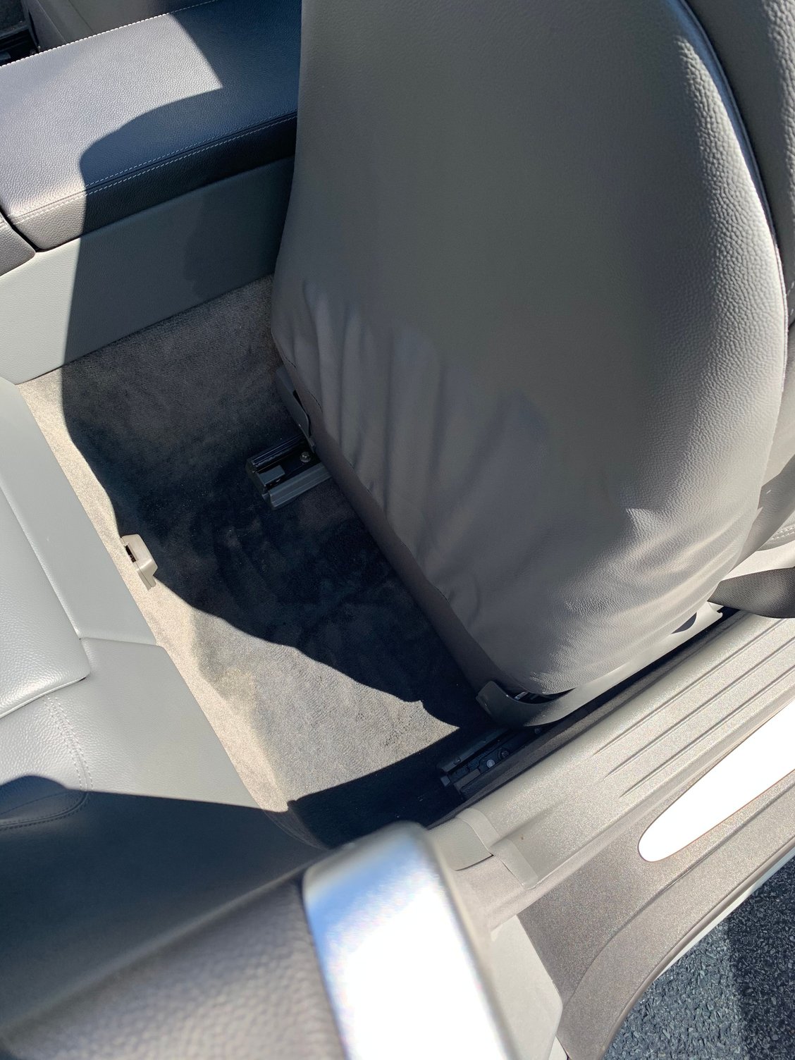

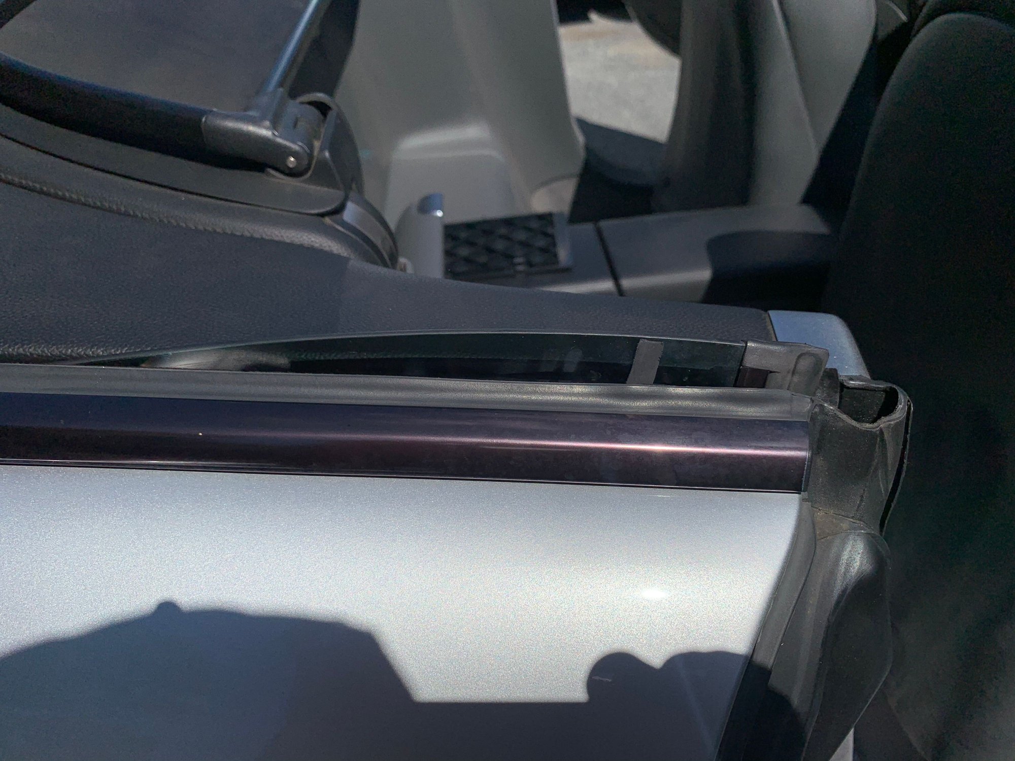

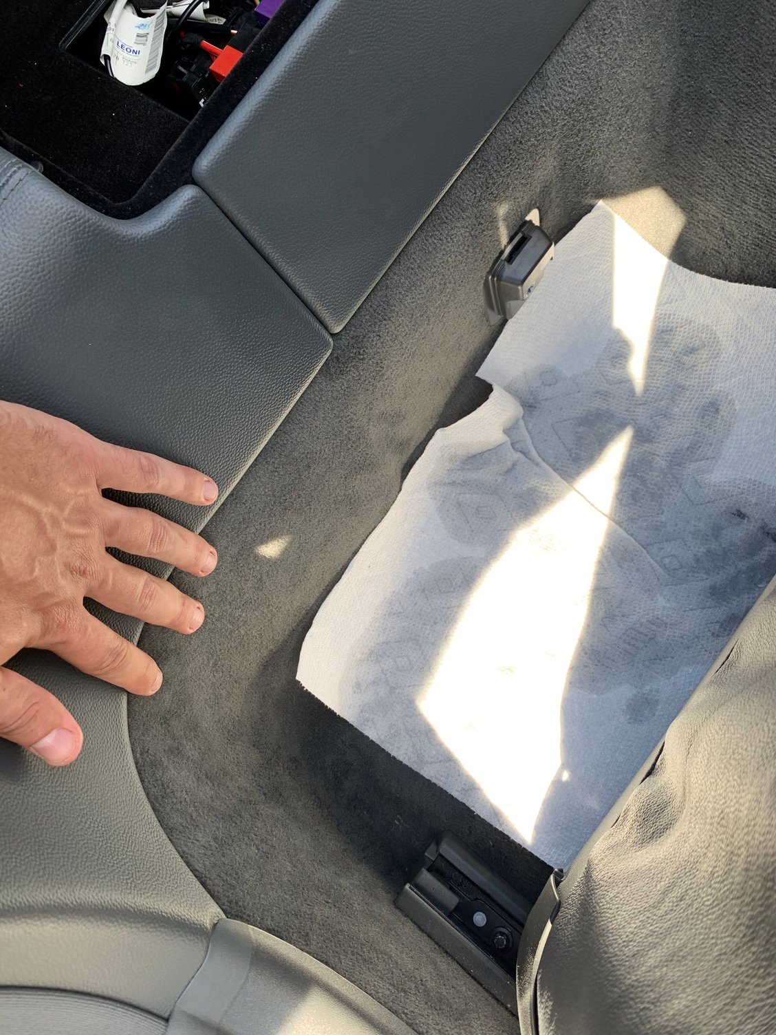

Hey boys, last night my alarm randomly started going off and I had to hit unlock and lock.I just opened my car and noticed the passenger seats were wrinkly..I inspected the car and turns out water got in somehow!!!
At first I thought it was the front and the reed valve. The front is dry and carpets dry. Water somehow made it to the back of the car.
My roof is dry, my trunk is dry. I’m stumped, could it be this tiny window seal?
anyway I’m drying it right now with a vac, towels and I’m putting a dehumidifier in there.
The rear sam had moisture in the area but no water. I’m stumped does anyone have any ideas how to prevent this in the future.
could it have been this little seal sticking up?!
how did my seats get like that so quick?
Help? Thank You

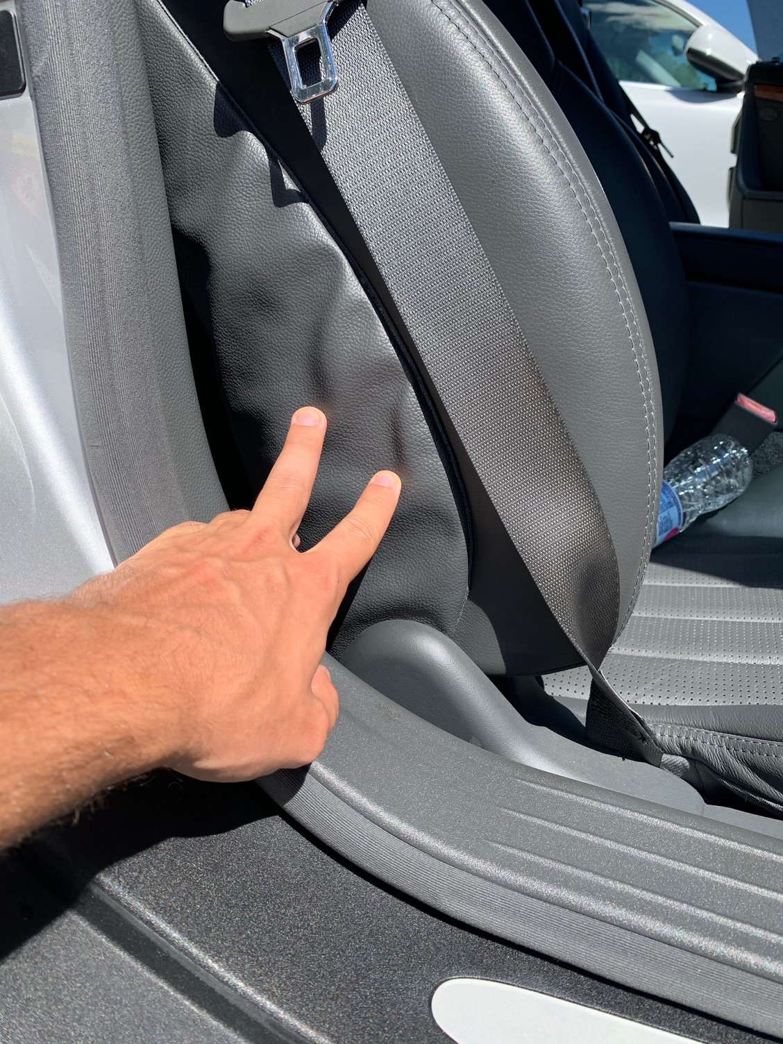

I honestly would like to keep it, I'm going to take it to a shop to asses the damage.
The door? It's total dry..the water is behind the seat, not on the seat or infront of the seat. Do you think it got thru the door and dripped down? I think if it got thru the door the mid area would be wet.

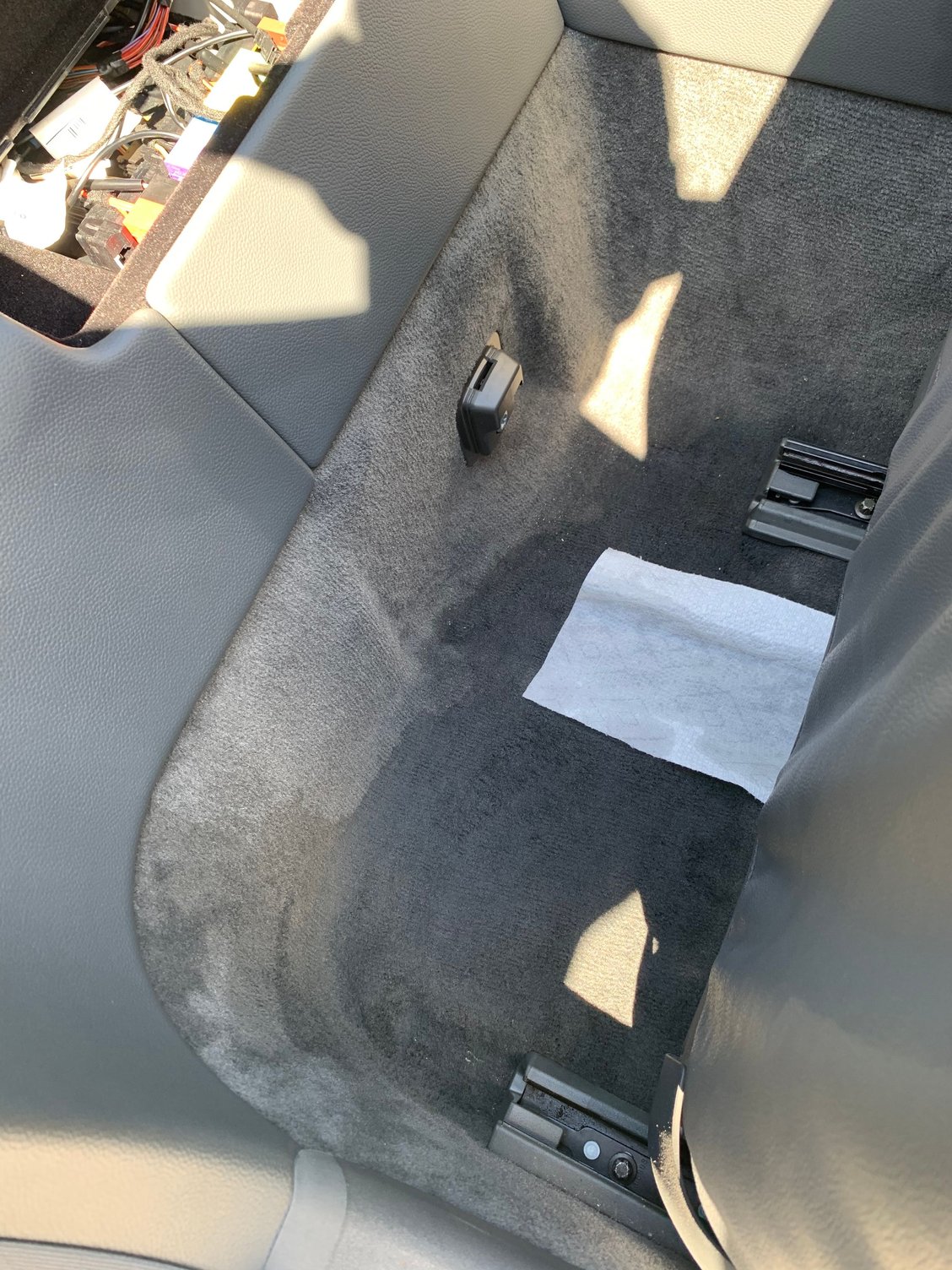

Well some good news battery charged and car started right up, no errors, no codes, all electronics, sound system and a/c work..
Carpet looks dry on the surface but who knows how deep it goes under the seat, I called my shop and they're all away for this long weekend!
So Tuesday is the earliest I can get there, the test will be to see if there is parasitic draw and it will be dead overnight.
I want them to pull the seats and asses the damage.

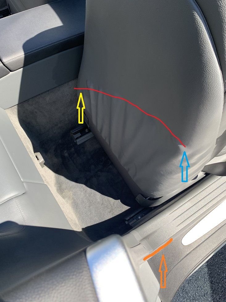

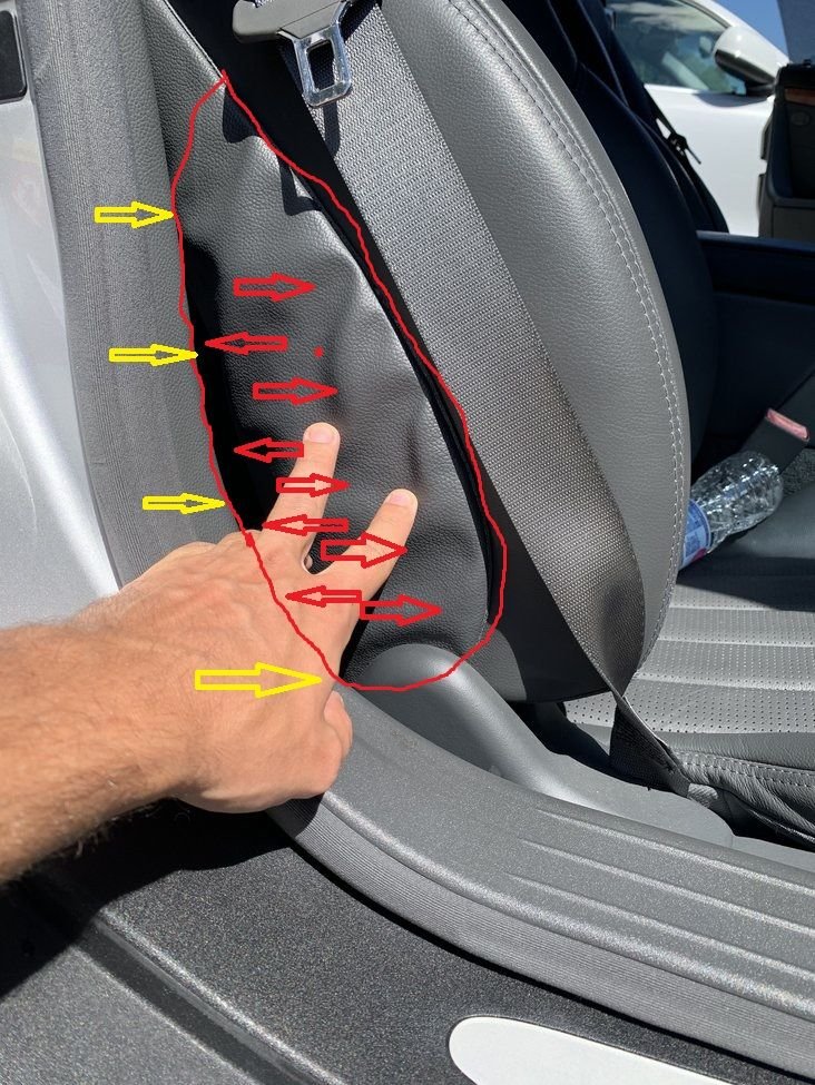

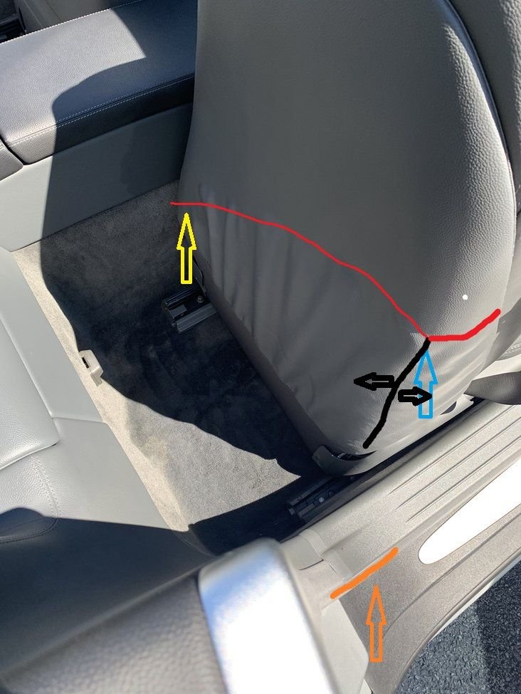

Your friend is right. Wind can open seals, as wind speed and area can be converted into force per square unit.
As you stated in your PM (Das Geld 2) : " The car was facing towards the front of my house. But yes the wind was blowing in a cross pattern I believe and hitting against the passenger door( I remember this because I looked out the window and just saw the wind pummeling the side of the car) "
In my opinion this water damage is not coming from the window seals. The way they are designed, they increase seal as the wind push at them. My guess is that we have to look at the door seal.
The way the water damage on the seat cover is showing indicates to me that there was quite an air leak at the lower back corner at the door seal. ( marked on the below picture with a brown fat line ).
Together with the air blowing into the car, was coming water, that was blow onto the seat cover and driven both forward and around the corner and across the cover on the backside.
The distribution of damage is consistent with the way the water would be distributed if blown onto the seat cover, in an curve like the door curve.
Furthermore the red line looks suspicious like a gradient, where the wind speed is the highest at the blue arrow, and lower at the yellow arrow.
The yellow arrows show where the water and wind came in, and the red arrows show the didtribution ( direction the water was pushed ).
Some water may have found it's way behind the panels and wettet the carpet in corner, and some water has dripped of the seat back cover onto the carpet.
My recommendation is to remove the seat, lift the carpet and make sure that there no water trapped under the carpet.
Second I would check the if the door is closing firm to the seal, and if not loosen and adjust the lock bracket 1-2 mm. inwards. The way to check, the door should pop out as soon as you lift the door handle, and you should feel some resistance lifting the door handle.

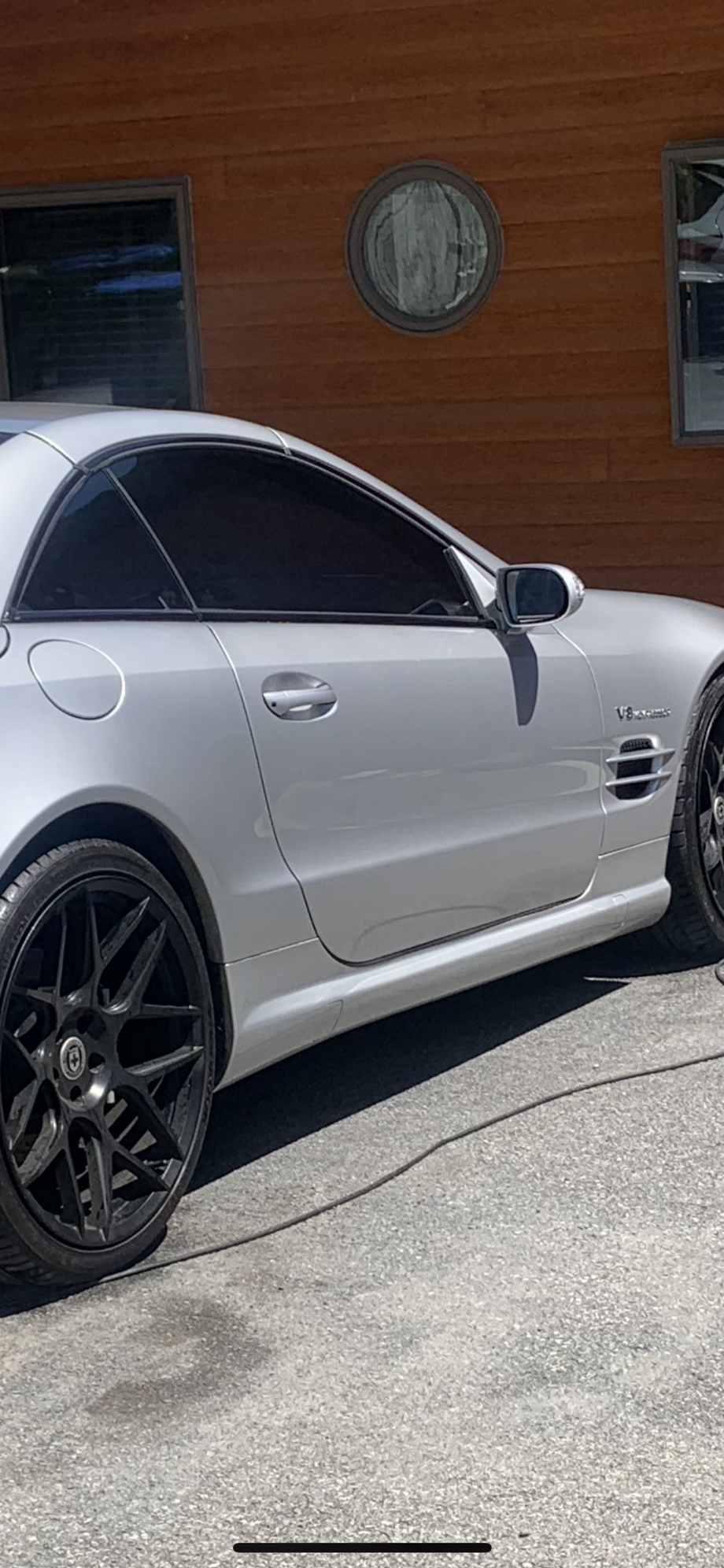

Kim, wow that would be insane if this is how water got into the car. Thank you very much for chiming in with this theory. As to my knowledge the car doors locked very flush and effortlessly.
Further more wouldn’t the weather strip where my hand is in the door sill be fully saturated and wet? That part was dry. I can’t imagine that huge amount of water coming in from that hole even with microscopic droplets, it would have to be significant as you said. Here’s a recent picture of my door
But anything is possible at this point..
I took the car to the shop and they pulled the seat and carpets, they found no traces of active water, I guess it dried or I dried everything up but the connector in one of the canbus had traces of corrosion(so water did make it down there), they are replacing it and the car will be ready next week.
I want to further pursue this and do a water test, perhaps sit in the car and let the pressure washer hit it from every angle. Their theory was the drains got overloaded from the heavy rain. But it wouldn’t explain it all. Hopefully I can recreate this without hurricane force winds and rain. Lesson from this is next heavy storm I’m putting on the cover

In my opinion the only way the water damage is created is if the water is driven in the direction the black arrows are showing, That can only be done by either a heavy spray, like a pressure washer or a heavy wind pressure.
The gradient clearly shows that the pressure is decreasing with distance.
In my opinion no other phenomena could create such a pattern.

I’m becoming a believer, I will test with the pressure washer when I get the car back and see if anything is making it’s way in there!!
