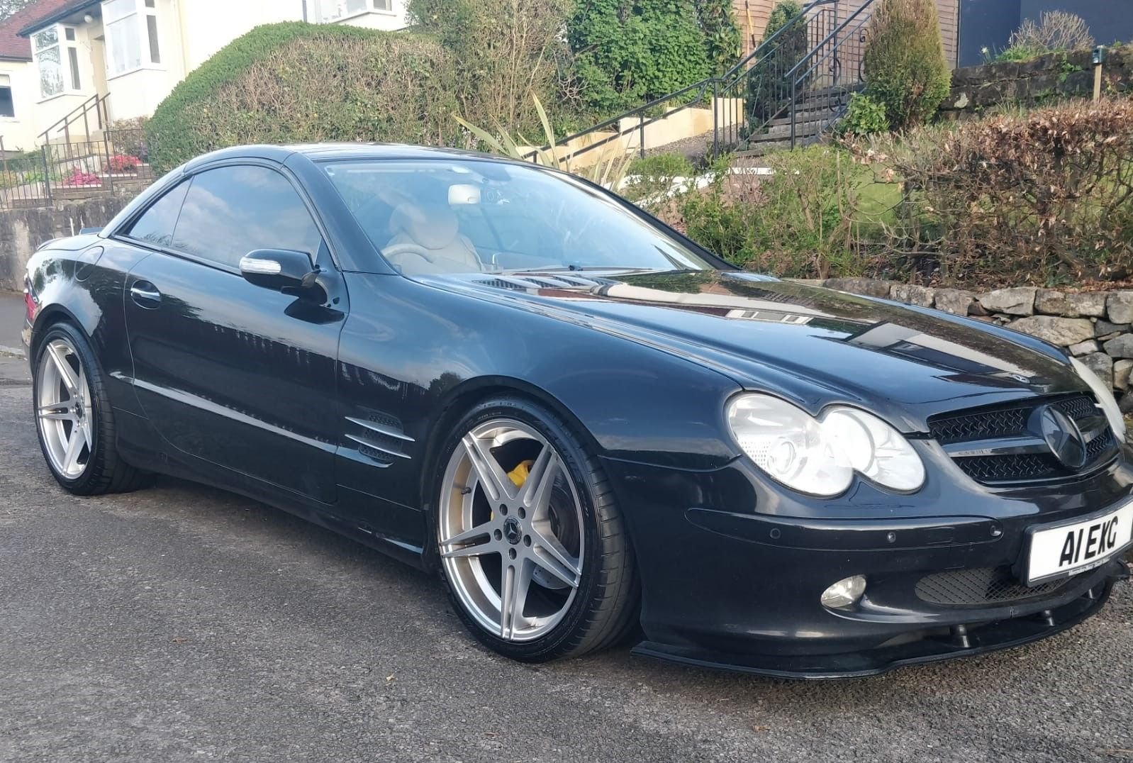

I've played with different wheel alot ! and not had any issues with vibrations. The comments in regards to cone or curved I reserve my comments on, but do not think they would give that much of a difference to cause vibration however it is important that you use the correct wheel bolts. It was mentioned the bore size on the wheel was 66.4mm? this is not right, the Mercedes bore size on the SL is 66.6mm not 66.4:
– Center Bore: 66.6 mm
– PCD: 5x112
– Thread Size: M14 x 1.5
I would start ensuring you have the correct spigots (inserts) on your after market wheels and that they are 66.6 ID (inside diam) to meet the OD (outside diam) of the cars hub.
Next ensure that your wheels have been properly balanced both front and back?
Check the tyre condition, are the they worn and second hand? are they directional?
Now check the fitment on the car, pay attention to the front car hub, there is a lip that sticks out and not found on the rear, this can prevent the front wheels sitting flush on the brake disc (rotor in US). Make sure they are snug against the back plate and torqued correctly.
If possible spin the wheel on the car and check it for buckles by looking from the back or front of car.
In regards to wheel bolts (lug nuts in the US) make sure you get at least 4 turns, for the rears do not go too deep as it will catch the parking brake and wreck them !
Attached are a couple of photos one from my SL and the an Audi that I had, the wheels on it used to be on a Mercedes CLK I had, I converted them, by fitting spigots to fit Audi with no vibrations.
After market wheels with spacers.
My old Mercedes CLK staggered wheel converted to Audi hubs with spigots
Good luck !
