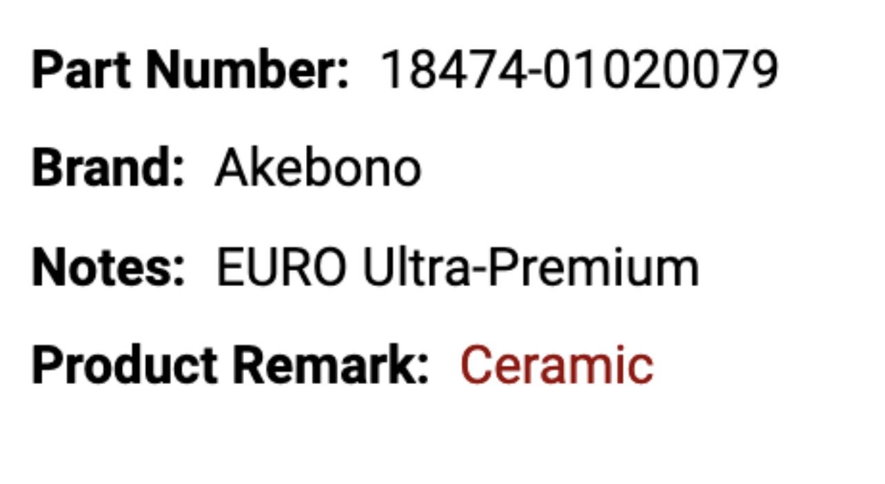

You can get the rears here at
https://www.partsgeek.com/gbproducts...-01020079.html
