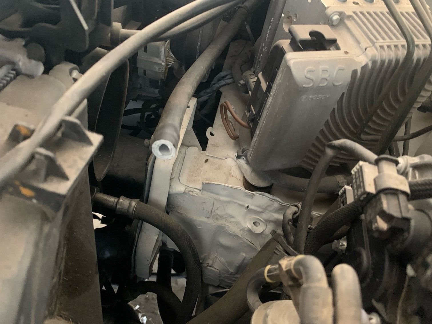

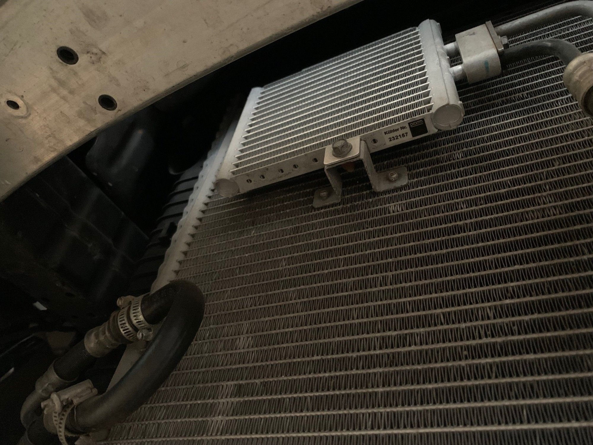

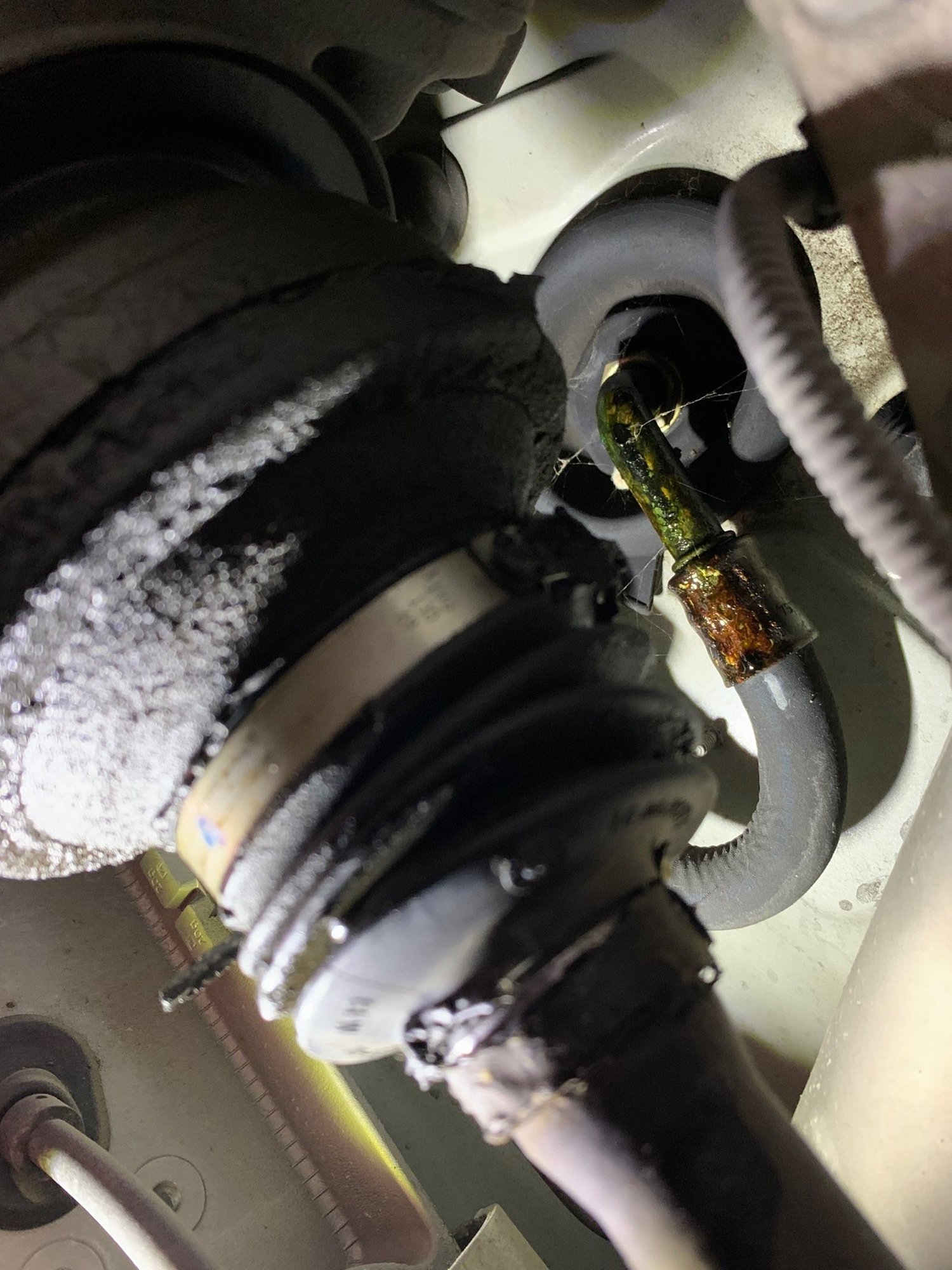

I got the car jacked up and crawled underneath the front. Definitely looks like I have a tranny cooler. However, I think I may have been told that because I see a couple sets of hoses that look like they have been patched back together. I have 3 coolers total. I assume the 2nd large one is an oil cooler?The first pic you can see hoses on the left/passenger side. 2nd pic these hoses are in front driver side. This is what somebody else saw and told me I was missing the tranny cooler. I lightly started undoing one of the clamps on that one looks/smells like tranny fluid to me. Third pic is a single hose coming around the passenger side front fender to the front of the car. But I haven't fully traced any/all of them to sort out where they are going.
I've also found wiring mangled for at least the side marker and fog lights. The ends/clips/plugs need to be redone to actually plug into any lights. So need to look into what that takes.
I think I may need to get involved in my local MB club and see someone has this gen they would let me play find the differences between them to help reverse engineer/fix all that is a miss with mine.
coolers
driver side spliced hoses, tranny possible
passenger side cut hose - air blow test suggest it goes to the washer fluid tank. Maybe it would go the headlight washers based on that location?

Passenger side looks to be broken not cut and other side looks to be power steering/ abc cooler ? Those all need attention before driving the car, maybe not starting it up, but definitely check all the fluids and possibly change them out. I would suspect by the bypassing repairs that were done possibly any type of fluid was put back in there to get the car operational. Not a great idea with the ABC system and not good for the transmission.
A coolant flush probably is in order as well, the different coolants aren’t fond of mixing over time, and can cause lots of silicate clogging. not immediately but by the looks of the repairs I’m relatively certain the person who did them wasn’t concerned about correct fluids for these systems, and I would guess you may be slightly more concerned, I would be.

Is there an ABC cooler? Hmm, I'll have to investigate. ABC fluid looks good. I did just a get a filter for it. I figure I can easily swap that, and then do again later if flushing all the fluid. That's assuming the ABC works as I've never used/attempted it.

I think that the drivers side lines are power steering hoses connected to bypass the rack. Probably either a major leak in the rack or one of the lines leading to it. The passenger side hose looks like the SBC hose that connects to the line from the master cylinder. It looks like the tube is broken off in the hose. The small cooler in your picture is the ABC cooler, behind it is the A/C condenser with a strip on top for the P/S, and then the main radiator with transmission cooler internal on the passenger side. At least that is the pre-facelift configuration.

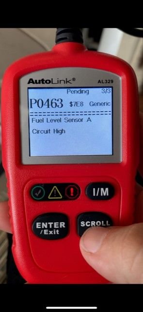

I do have an OBD Scanner, it's in another vehicle that won't be back until late tonight. So probably won't try anything again until tomorrow.
I was solo so couldn't tell if fuel smell from tailpipe. I'll try again tomorrow and then pull a plug or two (they are new) and see/smell what I can.

The fuel gauge is read by the rear SAM which also powers the fuel pump. You might not be getting power to the rear SAM, do you have any taillights or rear turn signals?

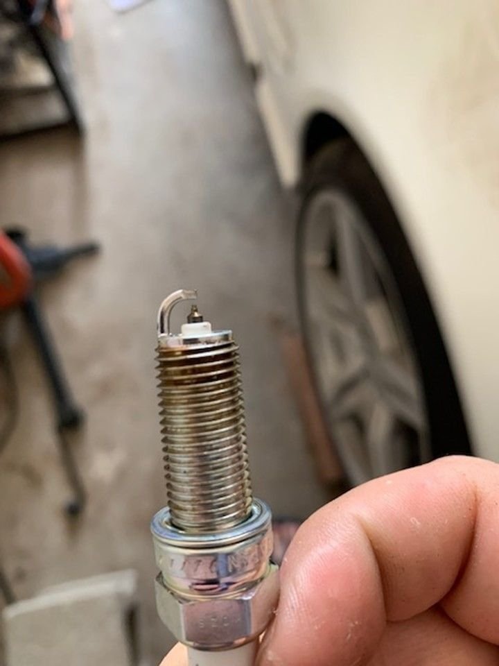

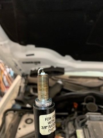

I pulled two plugs, one from each side and can smell fuel, more heavily on one than the other.
I do smell gas in the exhaust when turning over.

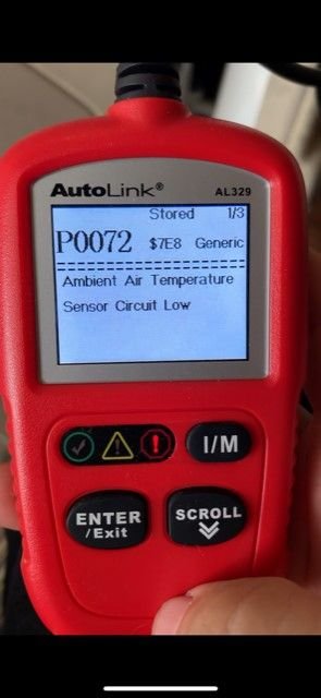

Scan the codes, first code of ambient temp,I know I've had since the beginning, 2nd one may be new on fuel circuit. So I need to research that one.

You smell fuel on the plugs, so fuel came in contact with the plugs. The fuel came from the injectors, so the fuel is reaching the injectors. I would make the assumption the fuel delivery system is not the problem.
You likely have no spark. Why no spark?
You have two sensor codes that appear to me unrelated to each other. Why those two codes?
Are you sure the battery is good? You said you replaced it. What date was it replaced, and from where was it purchased?
You said you replaced the plugs. Retrace you work and check for missing or loose parts and connectors.

Yes, very sure the 2 codes are unrelated as I know the ambient temp code has been there since day 1.
Both batteries were new July 4th weekend, and even popped on charger this past Friday night to top off. They are O'Reilly's Super Start Extreme ans Super Start Platinum.
The plugs are new NGK IX Iridium Spark Plug 93911 put in on 7/23. (I do still have the original plugs and even numbered which cylinder they came out of)
I did put a dab of dielectric grease on the end of each one. I also sprayed a couple seconds of Stabil fogging oil in each cylinder while I had the plug(s) out.
All the plug/coil wires seems very snug/secure.

Are you certain you smell fuel on the plugs, not fogging spray?

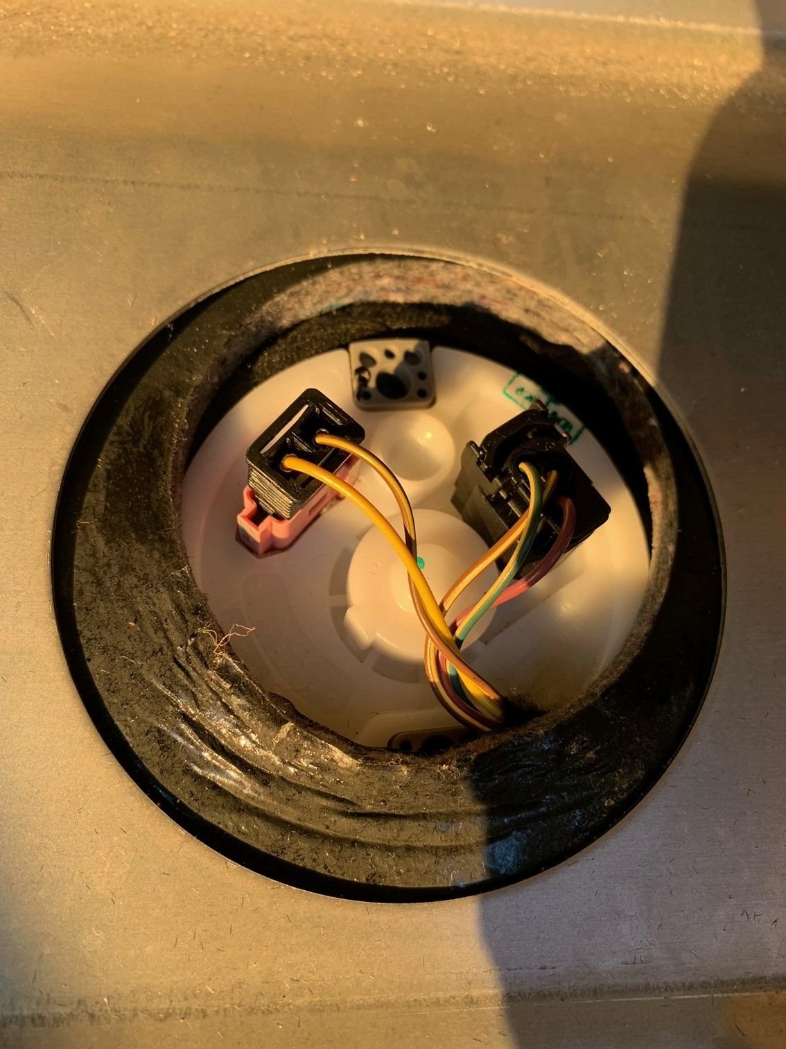

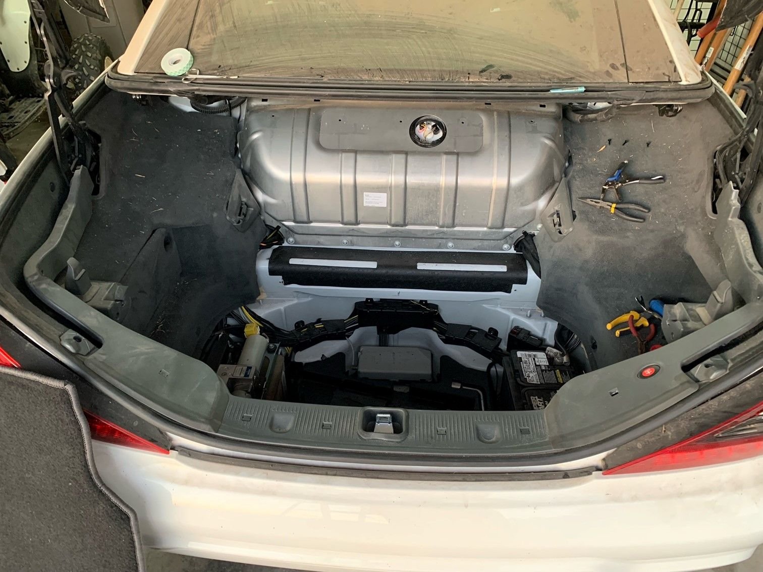

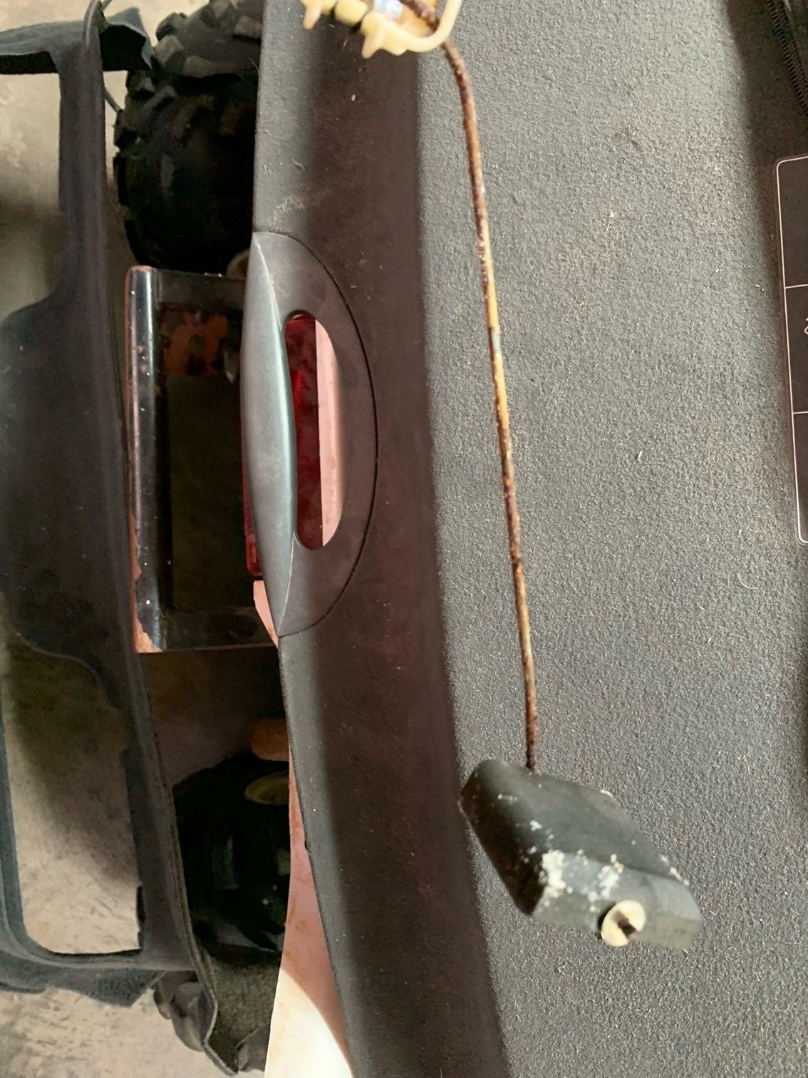

Not much to update yet. I did get a new belt put on. The tip I found online about putting an allen wrench in the hole of the tensioner was such a big help. All the idler pulleys and tensioner pulley move fine, no noises or unusual friction. Seem to spin fine.
I finally got the car up high enough to crawl underneath the rear and find the fuel filter. So I'm going to work on replacing that soon after I figure the trick out to host clamps as they dont look like normal spring compression clamps.
But something else that got my attention is I saw something on the boot cover of the pass rear diff. But nothing has dripped on the ground. Looks like this in the pic. I suspect that goes to the actual fuel tank and like so many things, not good.

I did replace the fuel filter a couple weeks back. Today I replaced the fuel sending unit. Definitely addressed the fuel gauge not registering and the p0463 code is gone. However based on the condition of the one that came out of it concerns me about what is in the tank/lines/etc. It still cranks but doesn't start. So I may need to pull that unit back out and see if I can get small camera/bore scope or something in there to get a good look around. Have about 4ish gallons in it but maybe it needs to comeback out. Concerned what that mess is in the previous pick as I suspect that is from the fuel tank. Fuel was coming out when I replaced the filter, but dunno if pump/lines/injectors are gunked up or what exactly. Probably need to pull plugs an really see/smell if fuel is getting to them.
Pics from the old fuel sending unit taken out today.
Old fuel sending unit.
It's pretty corroded and float end is seized up.
