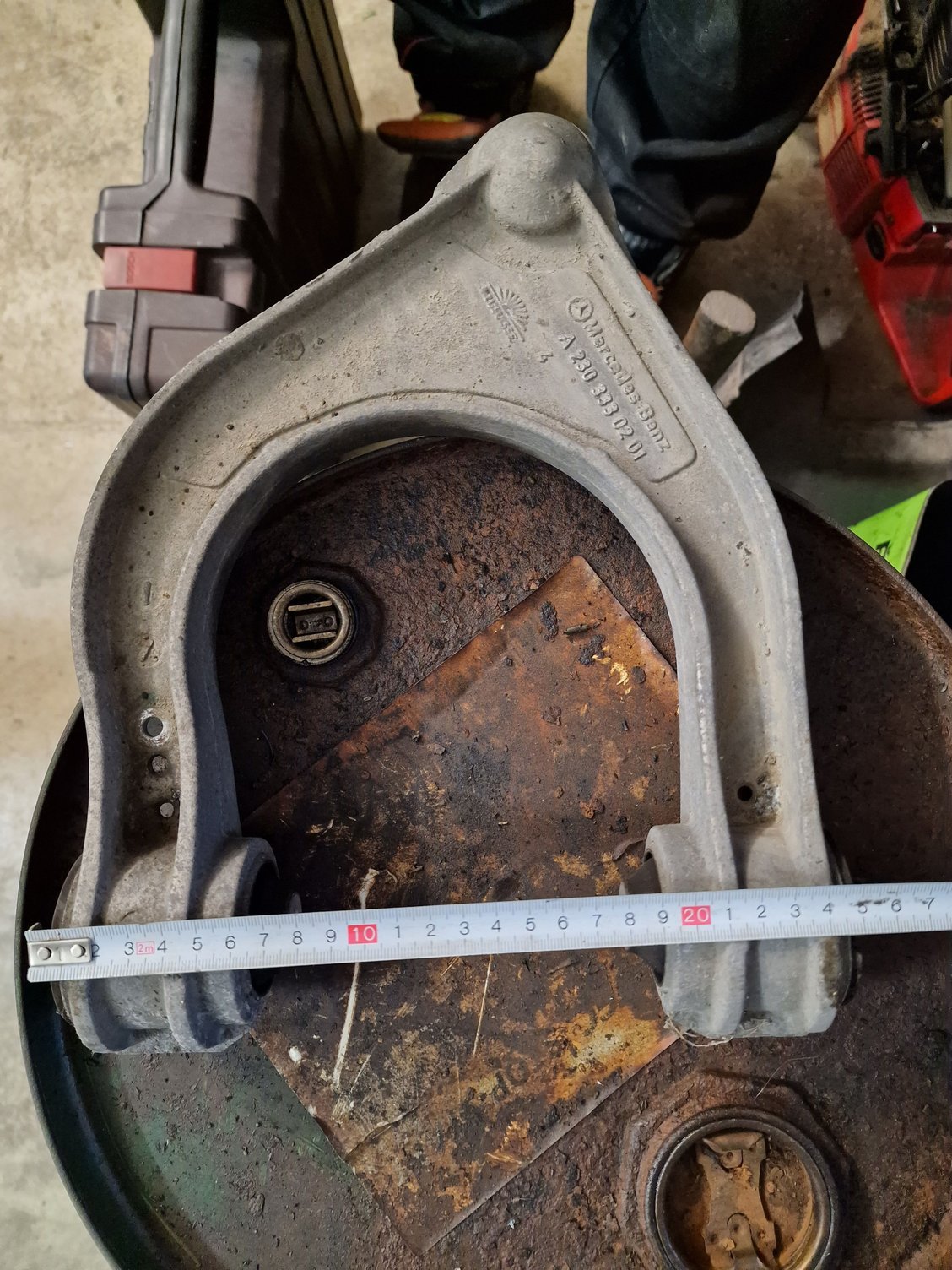

Hi everyone!
This may have been covered before but I'm struggling to get the correct front upper control arms (wishbones) for my SL350 R230 2002 model with ABC.
My Front upper control arms are the fully cast with integral balljoint & are specific for left & right fitment.
The arm has a cast in Mercedes # A230 333 0101 & A230 333 0201
I have ordered, received & returned at least 8 different pairs of fabricated with bolt on ball joint arms from many parts shop neither pair were correct being approx 25/mm too wide.
Chassis number - WDB2304671F046280

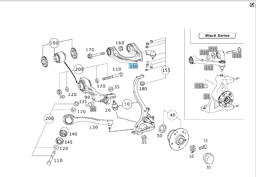

My local Mercedes dealer is unable to find anything other than a fabricated with bolt on ball joint wishbone similar to the lower one in the attached photo.
The only one part from local Mercedes dealer here in Czech Republic is A2303300138 (both side) but it some other type with unintegral balljoint and 25mm wider!
Cheers in advance for any help.
Ivan!
My old arm - A2303330201
Mercedes suggested part (nr. 150)- too wide!

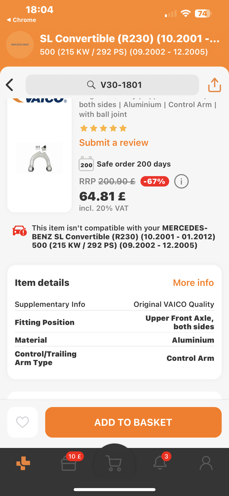

aico V30-1802
Originally Posted by Babachev
Vaico V30-1802 Will fit in replacement of this ???
Hi,
Like most here this upper control arm thing is max frustrating, I agree I get quoted 275mm wide parts all day and cant find the 258mm parts.
I think I may have stumbled going round circle on the V30-1802 part form Vaico, did this part actually fit in the end.
I know n earlier gentleman suggested the Moog parts from Rock auto, but I can get this in the UK.
Why is this so frustrating... I have a session with a Mercedes dealer on Tuesday, but if someone could help clarify the Vaico v30-1802 p/n that would be excellent.
Thanks
Barry
Old Nov 24, 2024 | 01:10 PM
Keith Noon's Avatar
Joined: Oct 2018
Posts: 86
Likes: 17
SL500 R230
If you type the part number into Google it comes up as E Class so will not fit I'm afraid. Suppliers cross reference it to.
A211330013.
I don't think it will fit.
Old Nov 25, 2024 | 04:06 AM
Bswift2's Avatar
Joined: Nov 2024
Sl350
Hi,
You are correct this one doesn't fit its the V30-1802, which is also shown on autodoc as a 258mm wide unit.
I was just checking why someone had posted a photo of this part in the thread previously.
Thanks

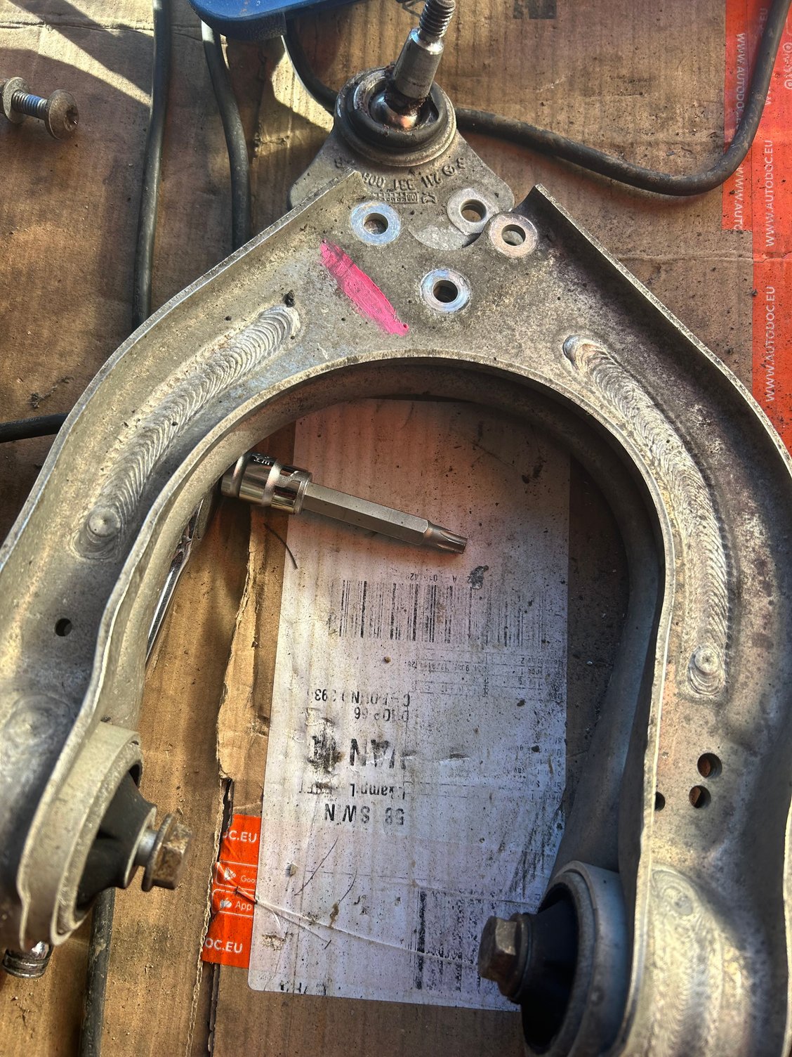

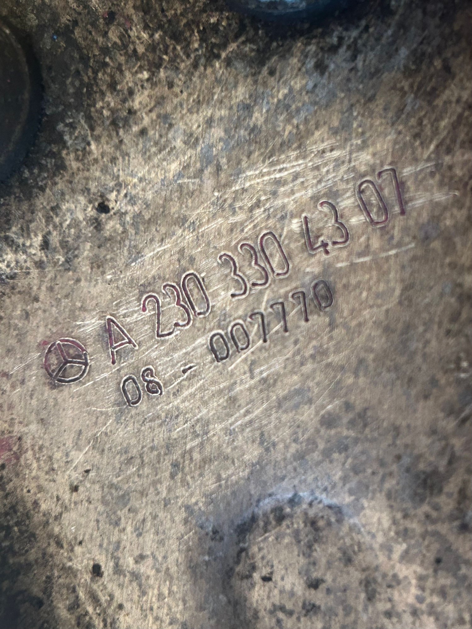

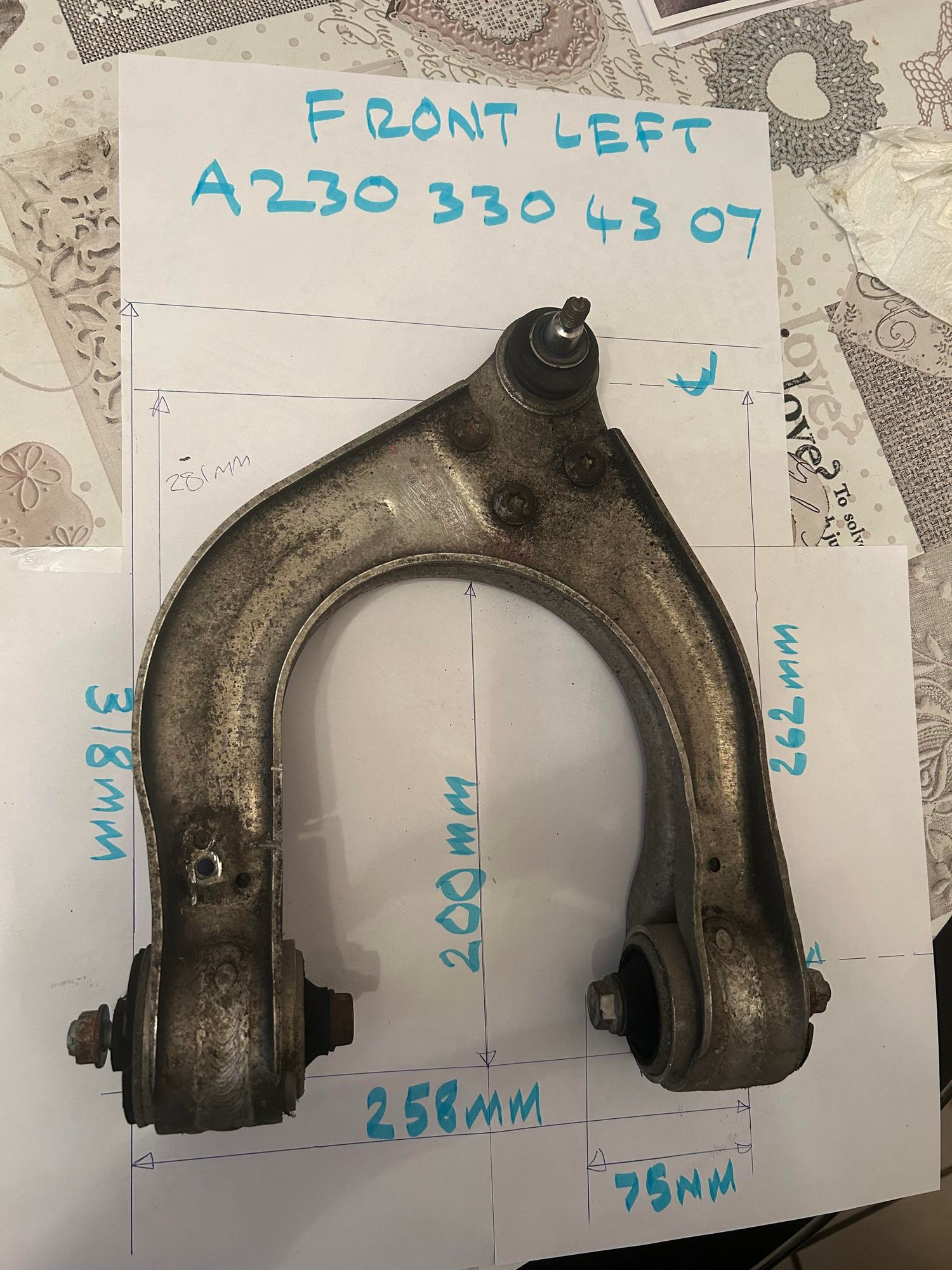

Old Jan 5, 2025 | 03:35 PM
Bswift2's Avatar
Joined: Nov 2024
Sl350
Fixed
Bought a used part from California and had it shipped to UK…
I replaced the ball joint
old unit/ part number of correct unit / refurbished unit photos attached
Installed
