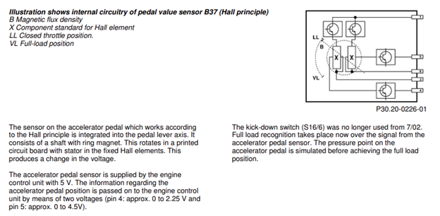

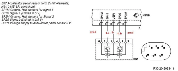

I got a pedal from a junkyard and tried to remove the sensor to no avail. Besides a couple of small screws it is glued with a tough holding compound. Probably will break it in trying to separate. As I explained in another thread, I got some issues and thought it was the throttle pedal sensor, but after gathering some info found out is is a Hall sensos that will last forever. You cannot test it with an ohm meter. Have to use 5VDC input, grounds and measure the output range. If it is to spec, just find the issue elsewhere!
