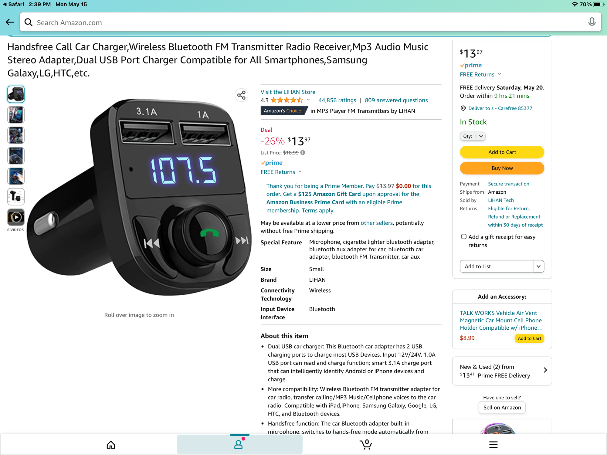

May 12, 2023 | 08:32 AM
This works well in my 2009 Sl63 (R230) with a 2.5NTG

May 15, 2023 | 05:42 PM
Been using amazon bluetooth for quite a while with original system. Works fine v

Feb 28, 2026 | 04:38 AM
Radio transmitter vs Bluetooth module
Hi
In my R230 2024. I have been running with both an radio transmitter plugged to the cigarette lit as well as a built in Bluetooth connection.
Radio transmitter is very easy but the sound quality is much lower. Also it is really hard to find a frequency where you are not occasionally interrupted by real radio broadcasts and get locked into that.
I did not install the Bluetooth module myself so don’t know how to about that part. But sound quality is good.
Reply 0
Feb 28, 2026 | 09:47 AM
Thanks... I have this adapter
Amazon Amazon
it works well-ish - but it doens't get me the needed functionality of a headunit replacement.
