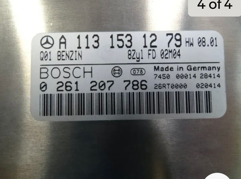

Does anybody recall what the main ECU Identity number from Bosch for US model 04 500's might be?
I thought it would be easy to pull up the group series code for these online.

That's the ID tag specific to that individual car and I appreciate that.
I was referring in general to R230's in the 04 & > category, like with the nomenclature; Bosch ME2.(0-8) possibly ME3 series

R230's with M113's and maybe all of the M113's used Bosch 2.8.

Just FYI, you can clone the ECU yourself for cheap. There are KTAG ecu programmers (clones) on aliexpress for around $60 or so. I did my CLK, which is the same ecu as my SL500. ME 2.8. It wasn't to hard to do. I got the used ecu's on ebay for around $30. That was a few years ago. I took my SL500 ecu and cloned it also to have a spare just in case, tested it and it worked perfectly. There are also some ECU cloning services on ebay.
