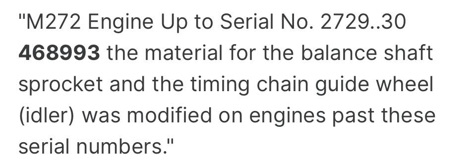

I'm thrilled to share that I've recently acquired a meticulously maintained 2007 SL350, boasting just around 40,000 miles on the clock. All the previous service was carried out at the hands of Mercedes-Benz professionals at the Mercedes-Benz dealership. However, as I delved into online research, I stumbled upon discussions concerning a potential balance shaft issue specific to this model. From what I've gathered, this seems to be the sole drawback associated with the otherwise impressive SL350.
Here are the details: the vehicle's VIN is WDB2304562F129512, and the engine number reads M272966 30 483754. The heart of the vehicle is the 3.5L V6 engine paired with the 7-speed automatic transmission. I sought out this particular model not only due to its efficiency, but also to avoid the reputedly less reliable ABC system found in the SL500.
I humbly turn to the knowledgeable members of this forum for guidance. Would you be kind enough to assist me in assessing the potential risk of a future fault concerning the balance shaft, given the provided VIN and engine numbers? Moreover, I'm eager to learn about any other possible issues I should anticipate or precautions I should take to ensure a smooth ownership experience down the road.

Was there any kind of campaign covering the balance shaft? If so, the affected cars would be identified in the bulletin.

Seriously @sethofmilano , did you look at the MercedesMedic website? It tells you whether your car is at risk based on the engine production number.

Thank you for sharing the article regarding the engine number.

I did come across the article mentioning that after a certain engine number production, the balance shaft should be secure. However, it's worth noting that this report was specifically related to vehicles in the US. My car was originally sold in Japan, and I imported it to New Zealand, which led me to believe that the report might not apply to my situation. However, I might be mistaken, and the report could encompass all manufactured cars irrespective of their origin.
Interestingly, I'm aware of an individual in Wellington, New Zealand, who owned the same vehicle as mine. His car had a higher engine number than mine and was a few months newer, yet he had the balance shaft replaced. This discrepancy adds a layer of confusion to the situation.

OP....Contact New Zealand Mercedes Benz and see if it is in the engine number range for the issue ..and have them check to see if the issue has already been taken care of? Barring that reach out to Japan Mercedes Benz and ask them the same question? OR finally take it to New Zealand Mercedes Benz and have them replace the balance shaft with the updated one assuming that it fits.....

Engine numbers do not change for different markets, so if yours is outside the number range (which it is), it is safe, regardless of where it was sold.
The change just hit USA a little later than UK due to shipping schedules, so you cant go by dates.
