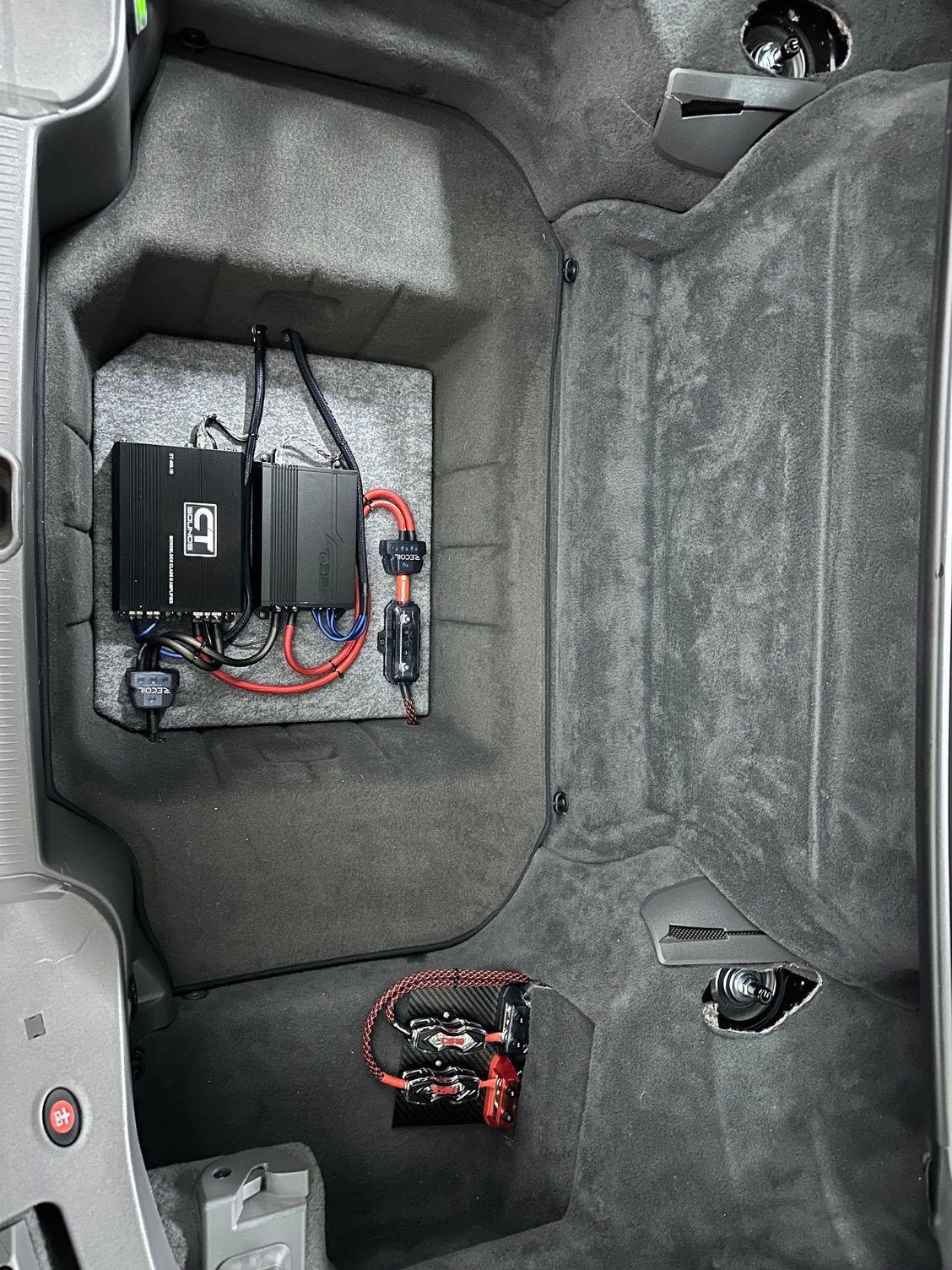

Just finished removing the complete command system & upgrading the head unit, door speakers, added a sub in the rear cubby, amps, & rewired everything. It really wasn’t that bad. If you go with a double din or floating screen I believe metra makes the dash kit. Scosche might also.

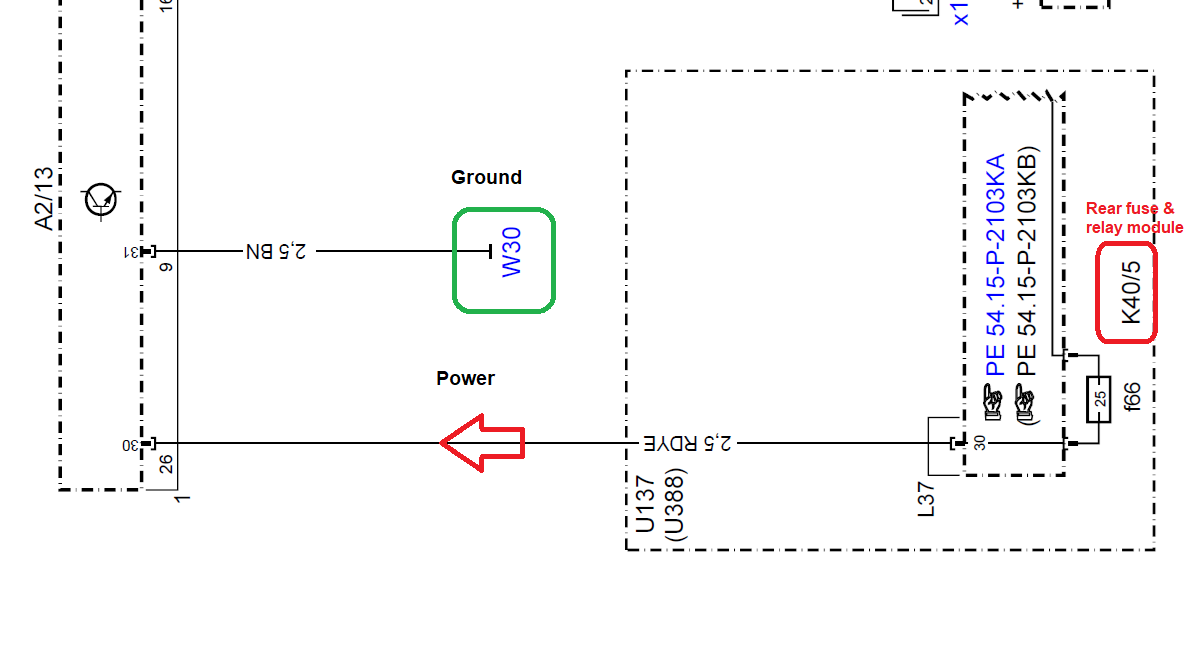

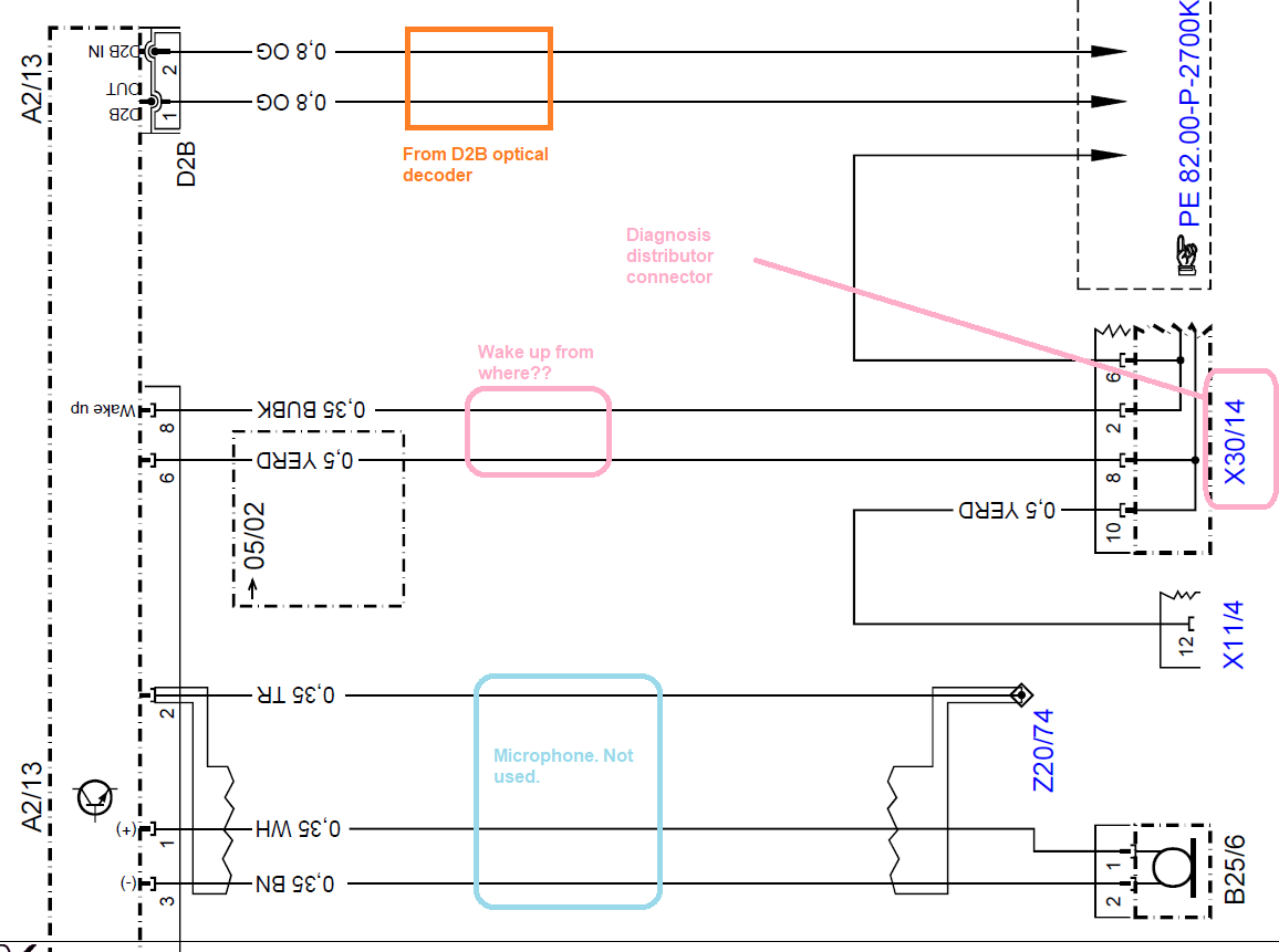

Marko...attached extracted sections from the SL-500 D2B system amplifier. As you could see, other than speakers the amp has the connections from the rear fuse and relays which must be power. Then the W30 ground. Now, that power would need to be switched.!
On the other picture, you have the optical cables in and out and the misterious Wake up coming from the Diagnosis distributor connector..! How did you by-passed that?

Now, if the wake up signal for the amplifier comes from the command unit, when you discard the command unit, how the amplifier is waken up???
Yes the command unit was sending the electrical wake up signal on the blu/blk wire. Now the D2B decoder is available and there is a blue wake up wire on it. I think the decoder is sending an optical signal to the amp to wake it up. If it were an electrical wake up signal, I would think you would connect the blue wire from the decoder to the Blue/Black wake up wire instead of pin 10 on the canbus connector. What is on pin 10 and where does it go? I dunno, but when it's all connected it works!!

Thanks again for your feedback Marko...! I can see the decoder has a bule cable for that purpose! Will try as soon as I get the required components!

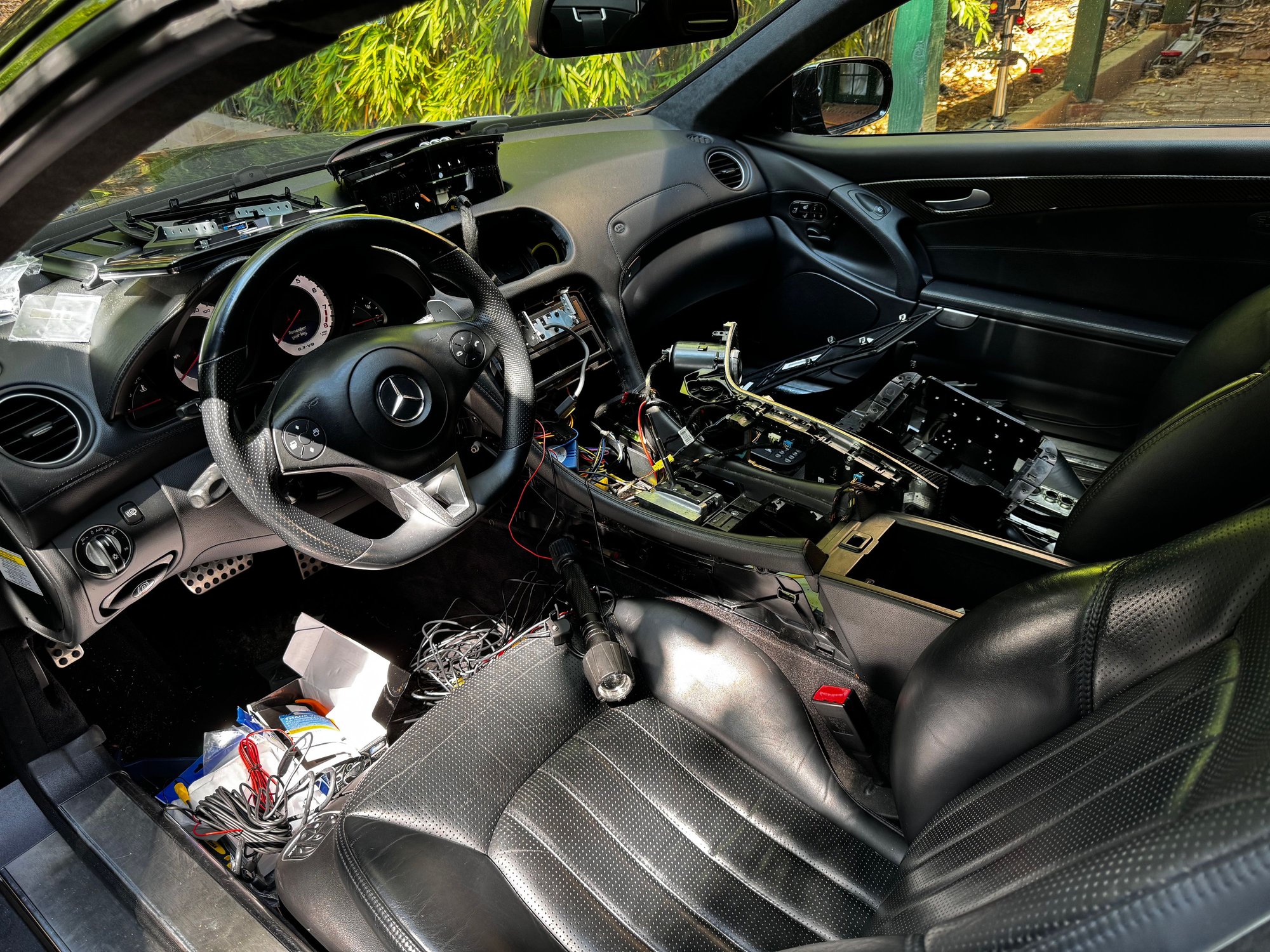

I’m in the middle of installing a Pioneer 10.1” floating screen HU
I’m starting with just replacing the head unit and keeping the stock HK amp and speakers. Enfig out of New Jersey makes a plug and play harness (literally plug and play) that is fantastic so far!
I think the 10.1” floating display is going to fit perfect and let me keep the cup holders and won’t block the vents.
Here’s where I am currently.

Maaaan you got a mess out there! Let us know how it goes and the final product!

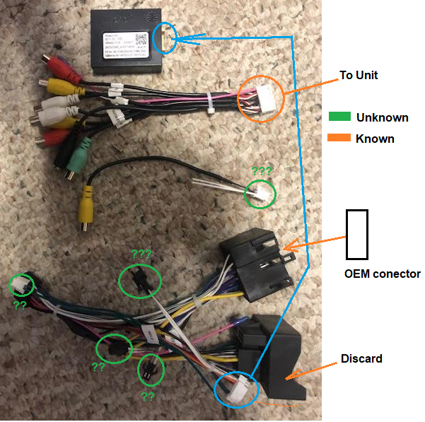

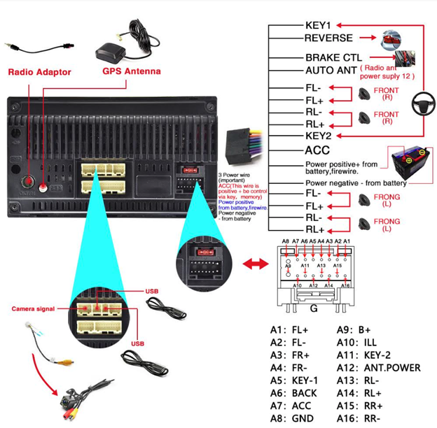

OK, wise stereo guys.....I have got my 9" android unit and it came with a bundle of cables to plug into the OEM connectors. But as many of you know, the Chinese instructions and illustrations really suck, perhaps they think we are super smart and need minimal guidance...!
The picture below illustrates the bundle that connects to the main unit. It has two styles of connectors to fit OEM plug. But also it has 5 intermediate connectors that I have no Idea where they go. I am sure some of you have decipher similar tangle of cables, and if you don't mind could you provide me with some hints...!
I have inquired to the vendor, but still have no answer!
Thanks in advance for sharing your infinite wisdom...!
