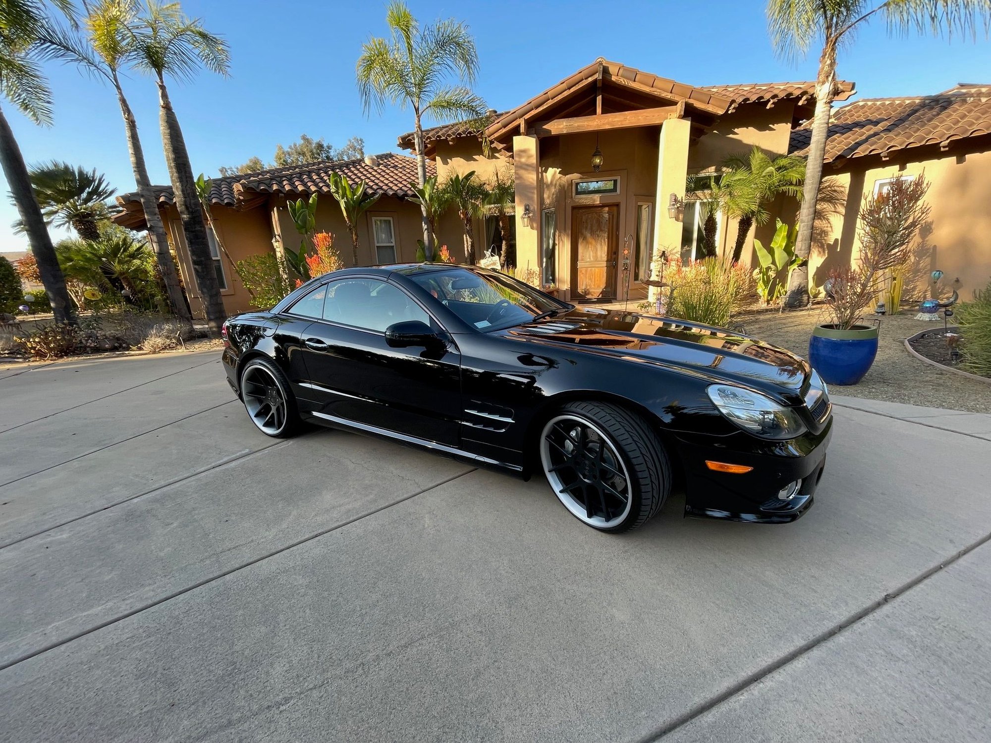

Nice driveway pic

Great pictures! Definitely forget about the benz dealership, they are robbers and liars. Sure there are two percent of them that are honest, but good luck finding one of those. Need to have an indy shop with guys who know these cars and are actually honest. I had an alternator that the previous owner installed, that went bad and began putting out 30 Volts instead of 12-14. First system on the car to notice this condition was the SBC and it immediately gave warnings and threw a fit. If the SBC isn't happy, the car will not be stopping well at all, and can't be driven. I was pretty sure the SBC had quit due to its own fault, My trusted indy shop figured out it was the alternator. A cheap Duralast brand unit from Autozone was on the car! Never buy cheap junk parts for these cars. Had it been the SBC, Mercedes warranty would have replaced it. Your issue could still be the trunk battery. How old is it? Have it load tested. Replacement cost of that battery under $250. A good code reader probably will give you some more insight too.

Nice driveway pic
So you like the driveway but not a word about the car?
