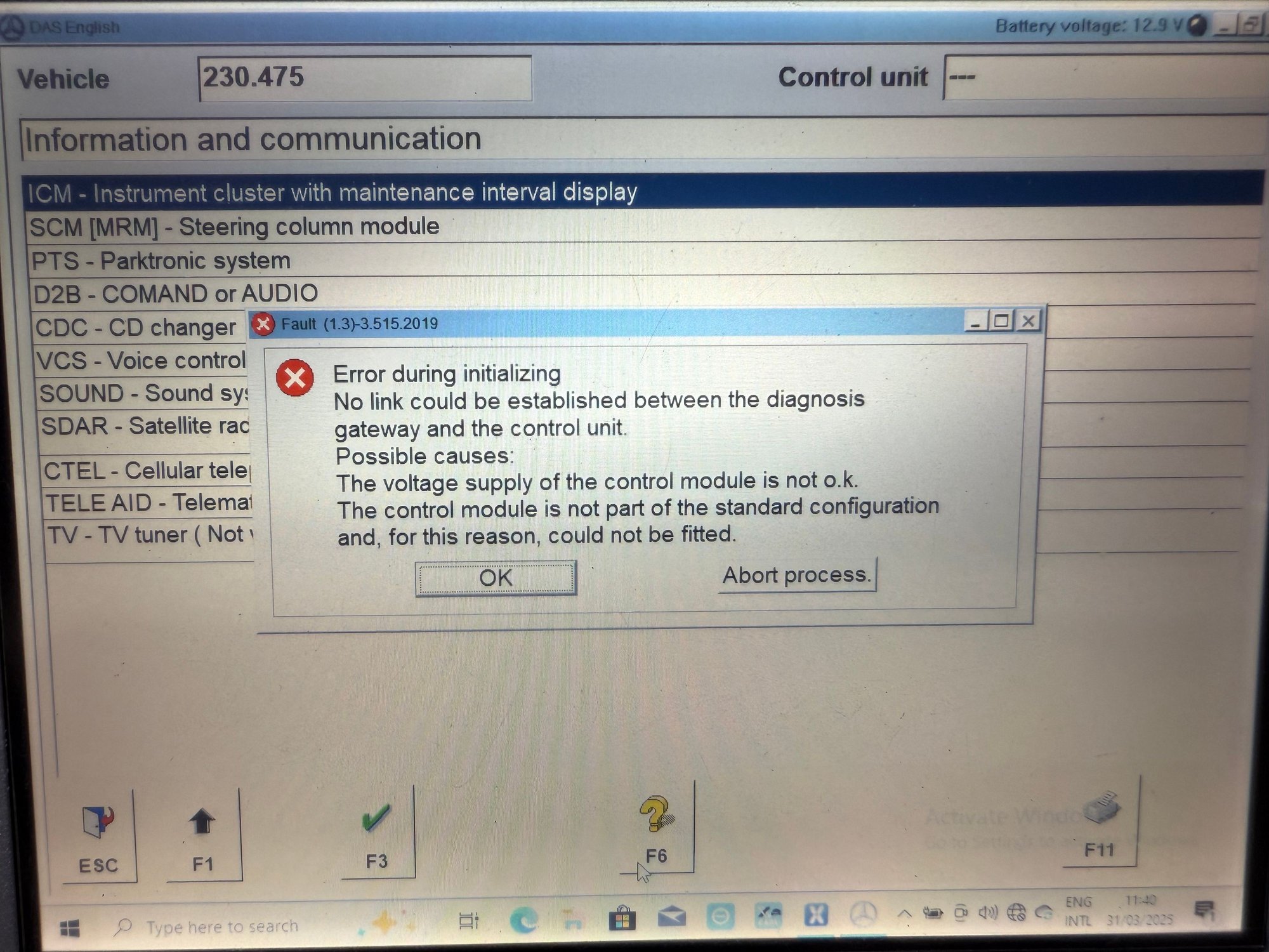

Unfortunately this module won't talk to my Xentry.
I also wanted to code out the ABC system since I changed to coil overs.
