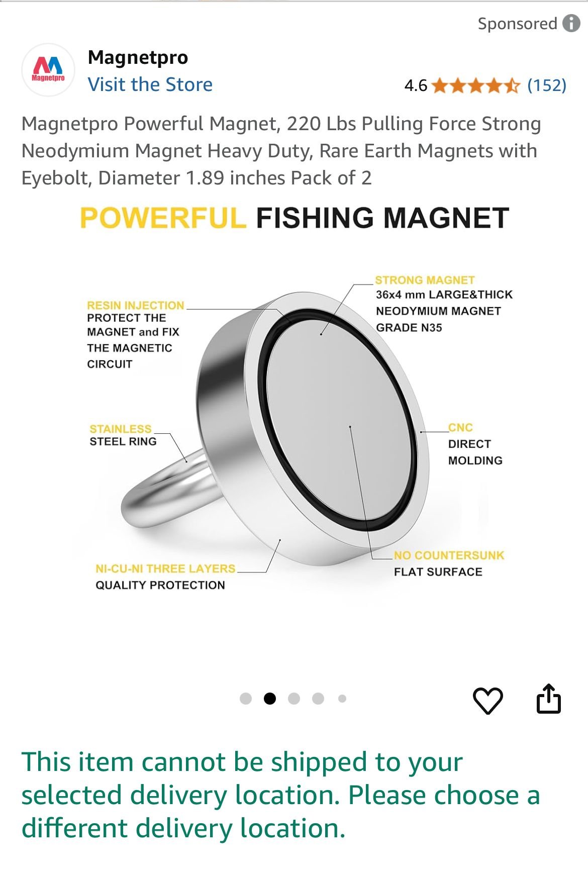

I got the fuel tank baffle issue and been looking into fixing it with the magnet method. I’m however a bit scared of operating in a fuel filled tank safely! So thinking out of the box. Could a super strong magnet (eg 100 kg capacity) be mounted on the exterior of the fuel tank to keep the baffle in place? Maybe some of you with some knowledge of the fuel tank interior and surrounding electronics would have an ideas if this could fly and where to optimally place it?
Ultra strong magnet
Ultra strong magnet

Still interested in hearing about if the external strong magnet could fly or not and if where it would be best placed
