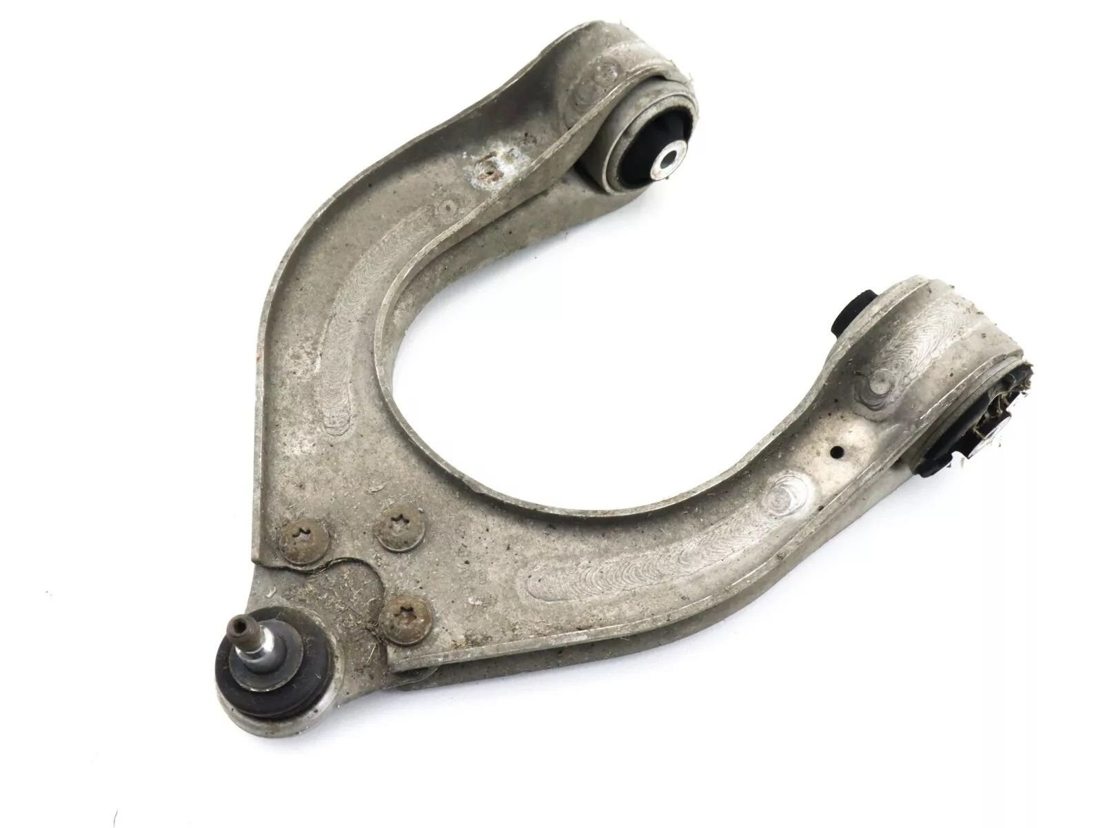

Used original Mercedes SL, R230 A arm/Control arm

The original upper A arm/control arm is shown on the first picture and a reproduction A arm/control arm is shown on the second picture.
So now i will have to get hold of a original Mercedes Arm/control arm first thin monday morning.
The aftermarked A arm/control arm are much wider. See the blue line
Original Mercedes upper A arm/control arm
The reproduction A arms/control arms are way to wide where the blue line is on the picture
