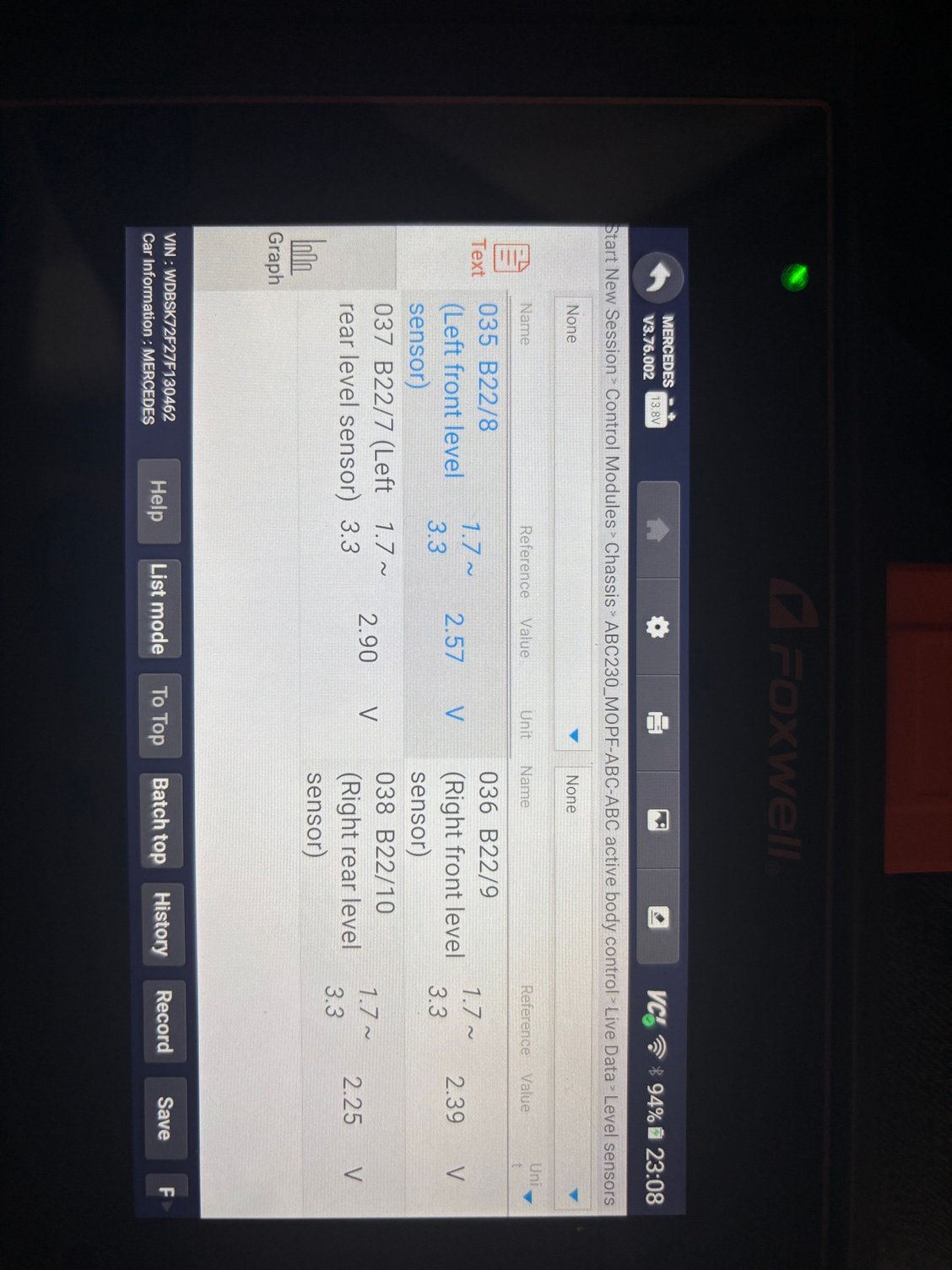

I would look at the ride height voltages at each corner as you command the corner up and down. Not sure about your scanner, but XENTRY/DAS lets you do this.
On one side of the car as the height goes up the voltages go up, but on the other side as the height goes up the voltage go down. (Who the heck would design it this way.)
Look for an inconsistency from the voltages on the same side as the same side corners go up and down. Be sure you ride height sensor is connected and working correctly.

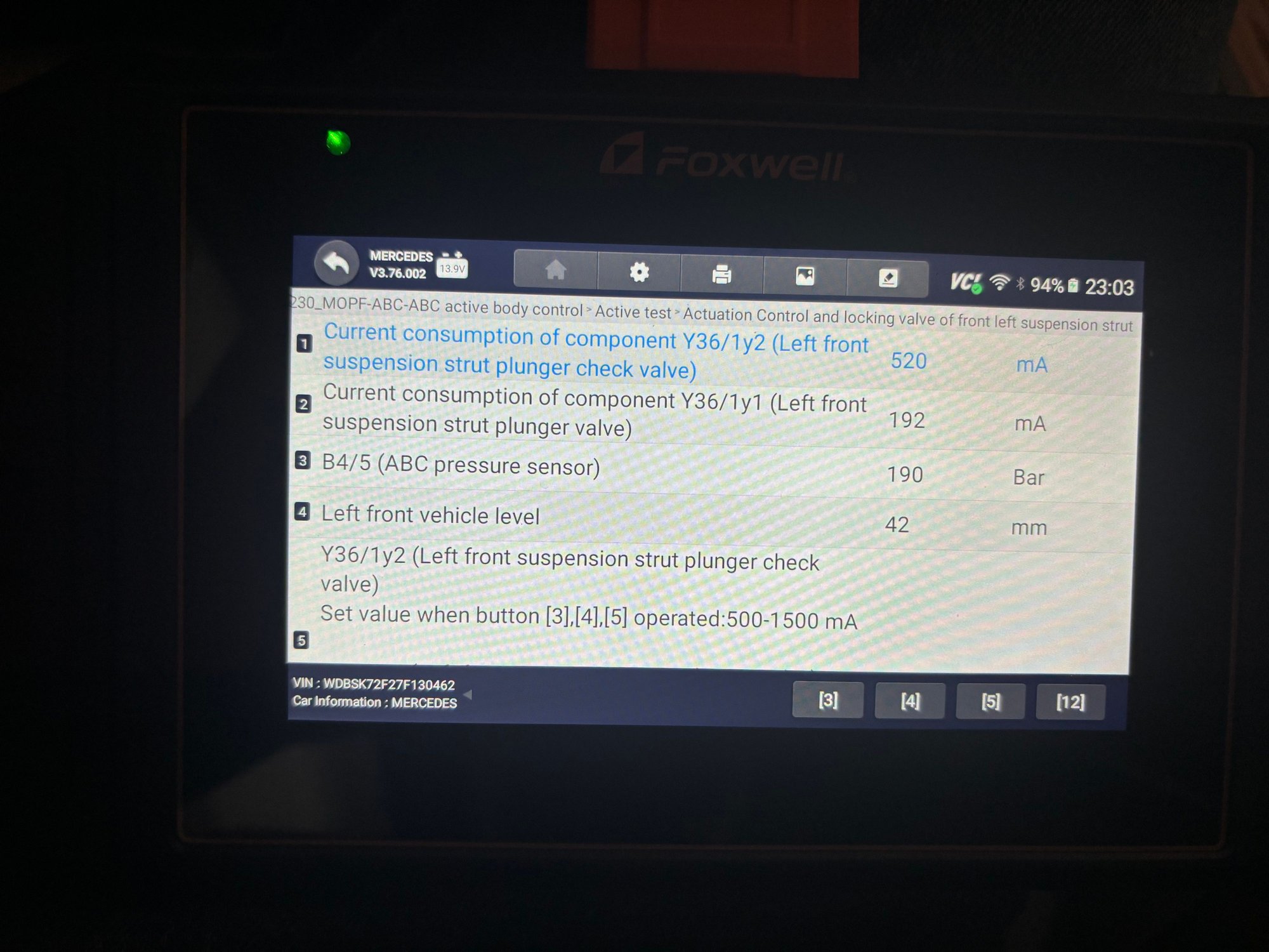

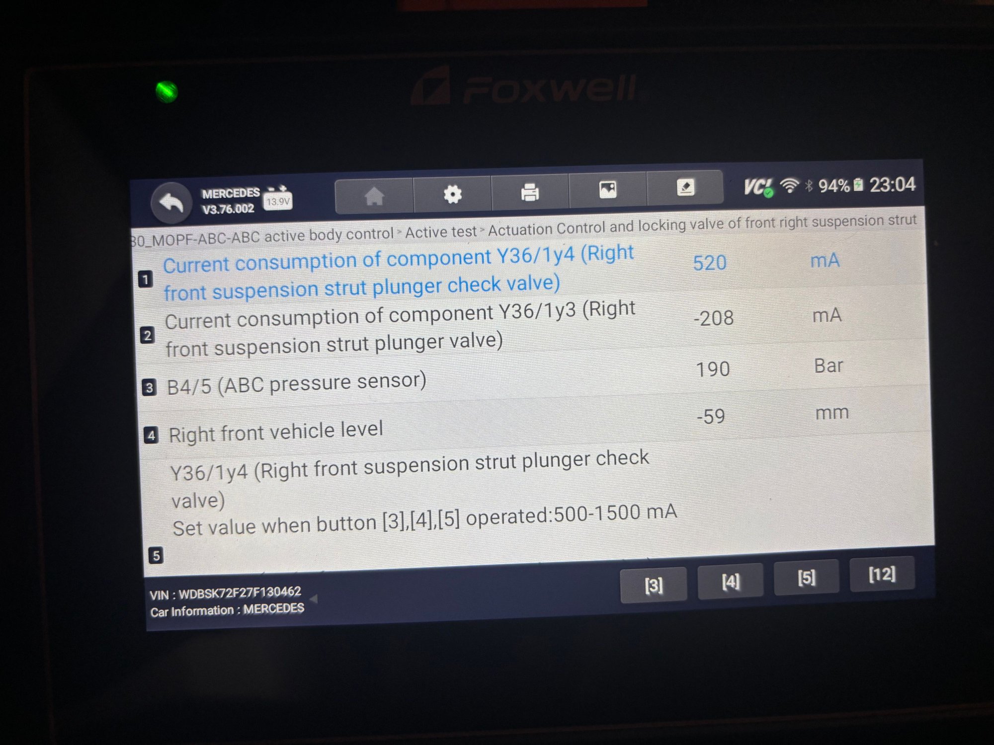

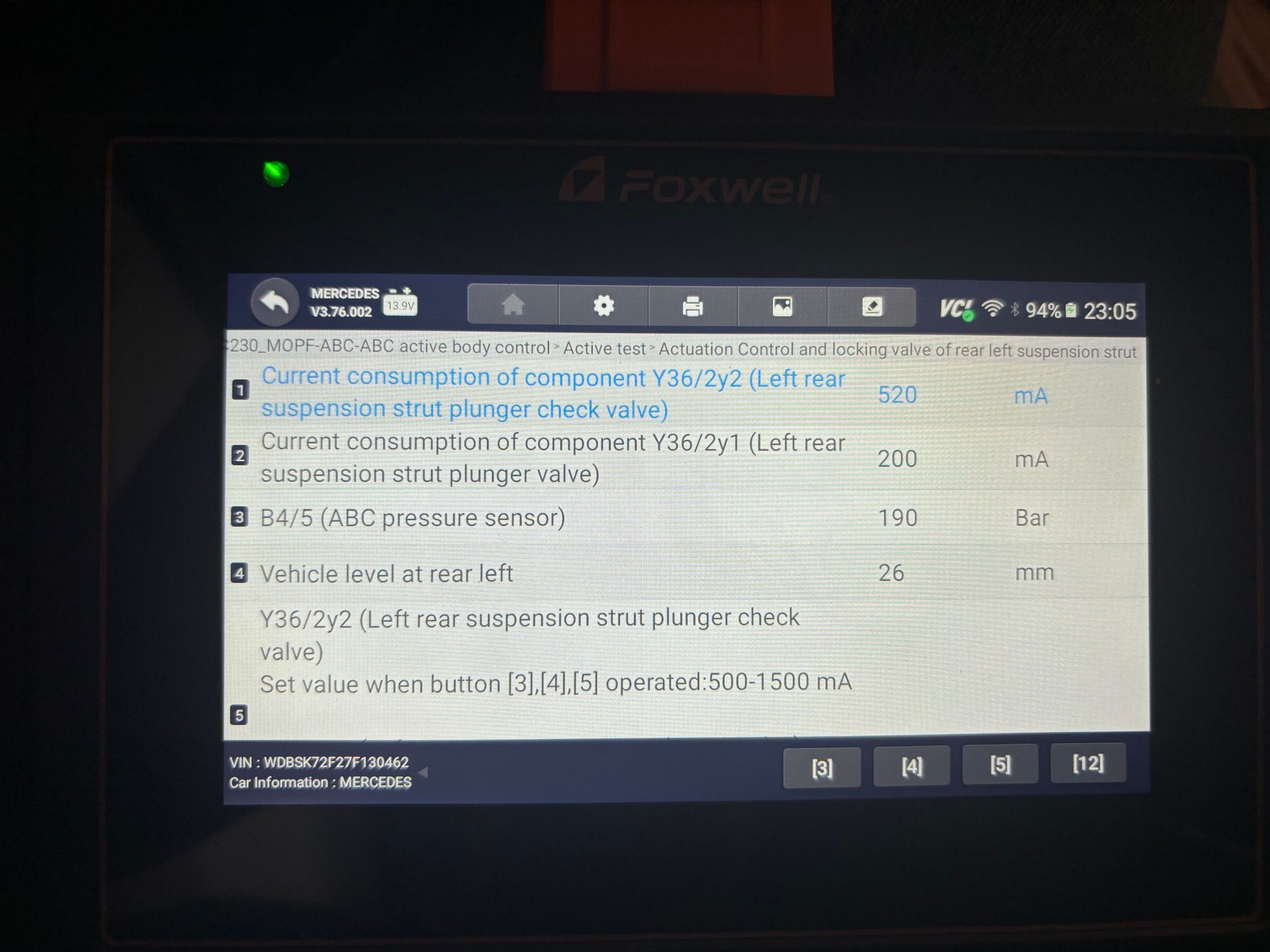

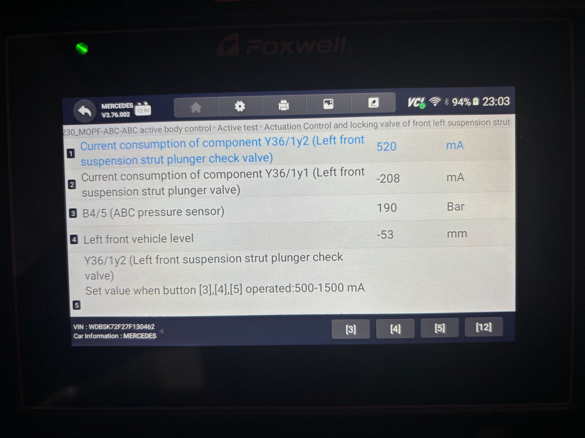

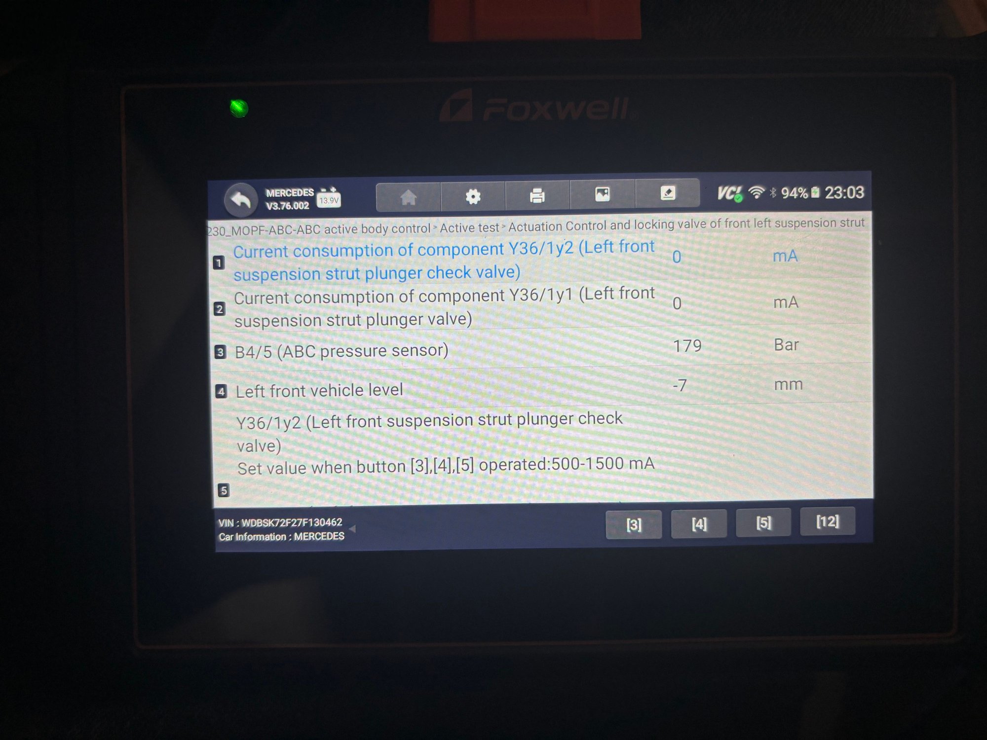

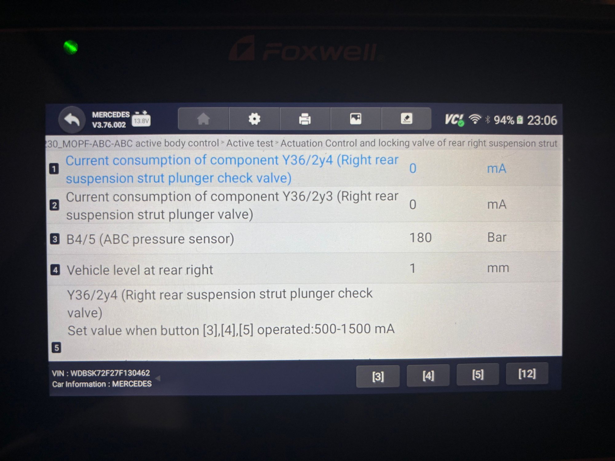

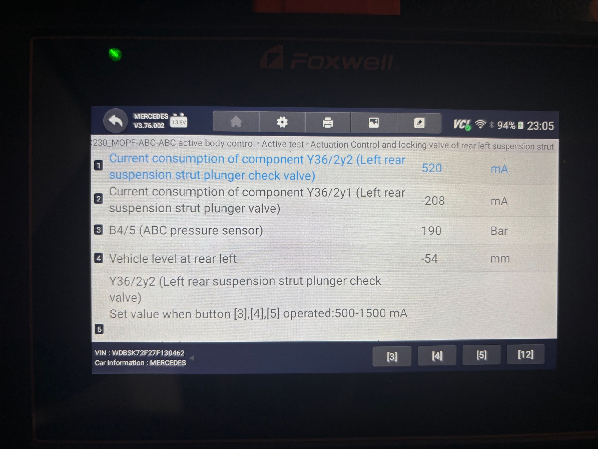

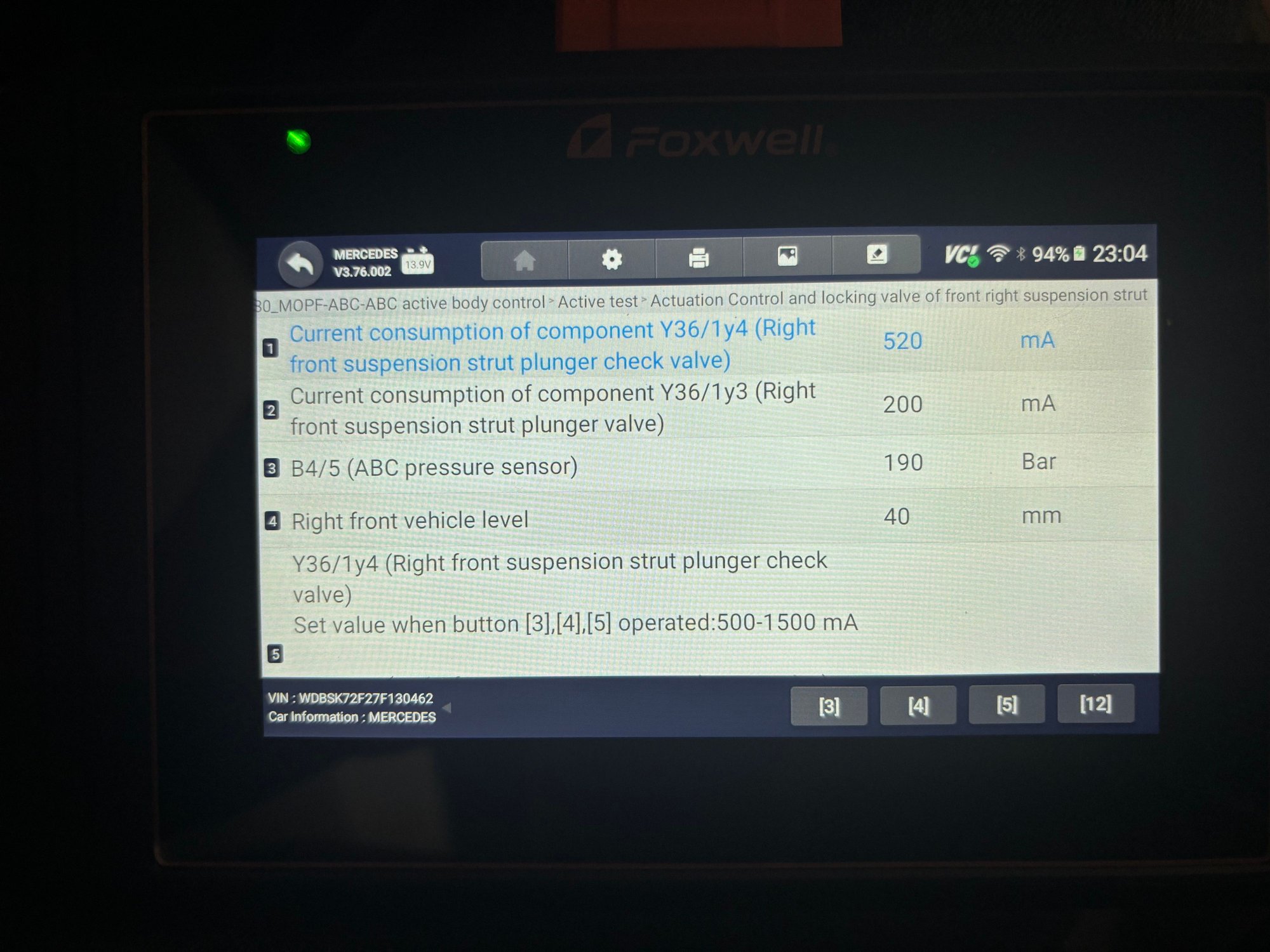

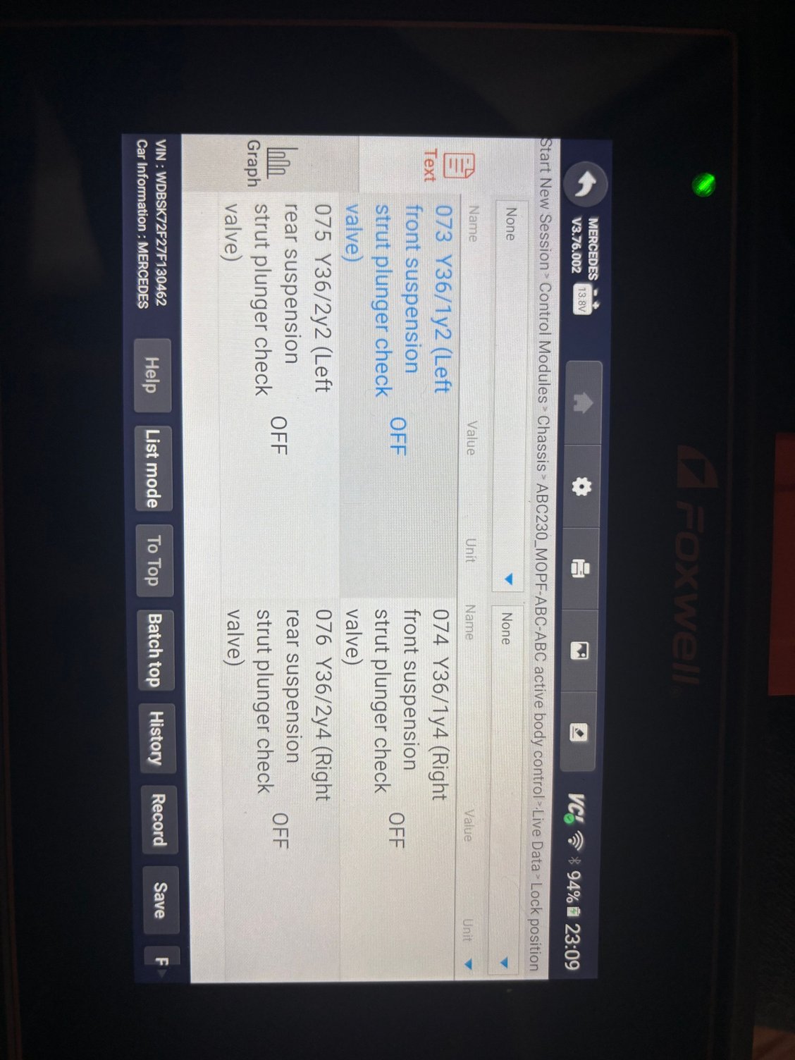

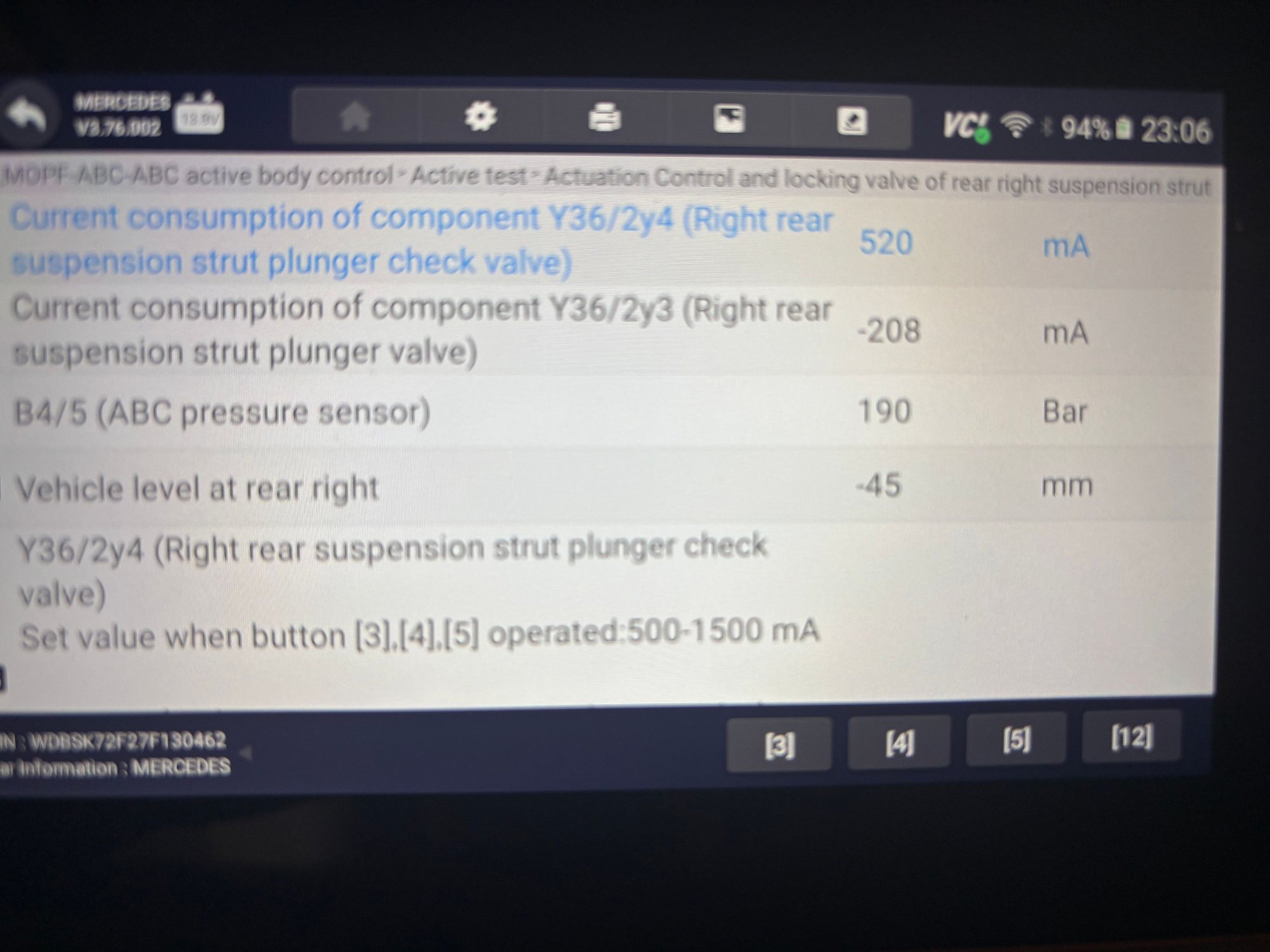

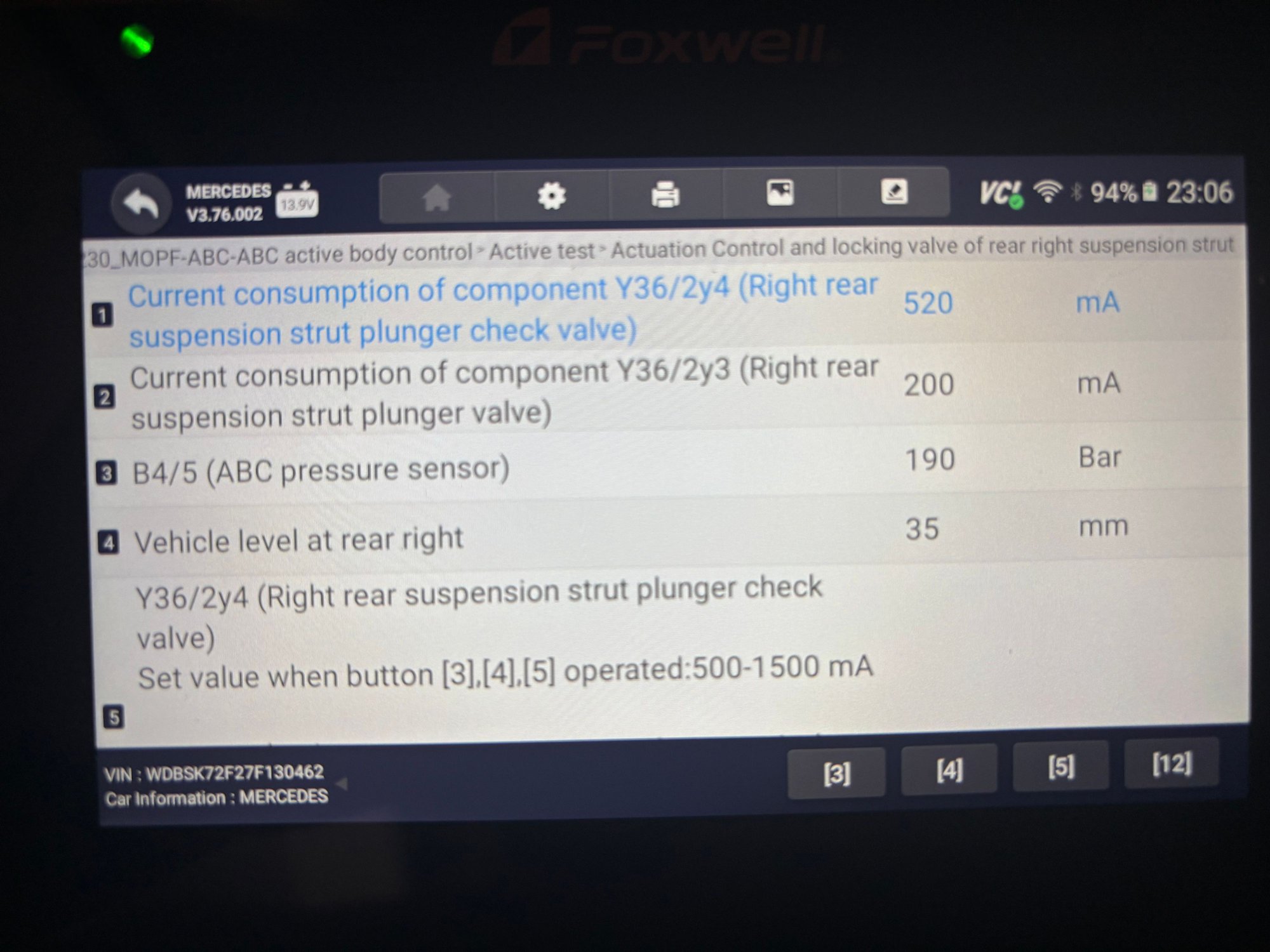

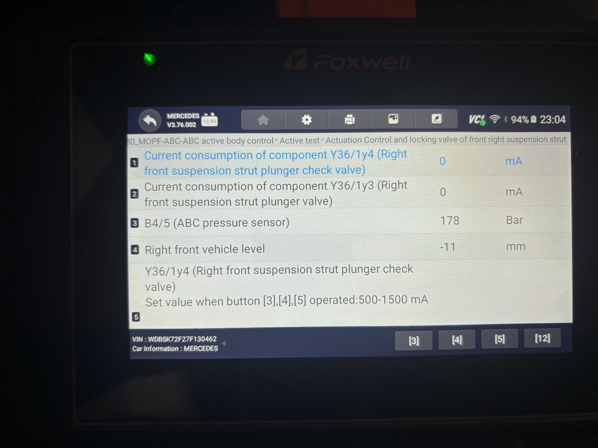

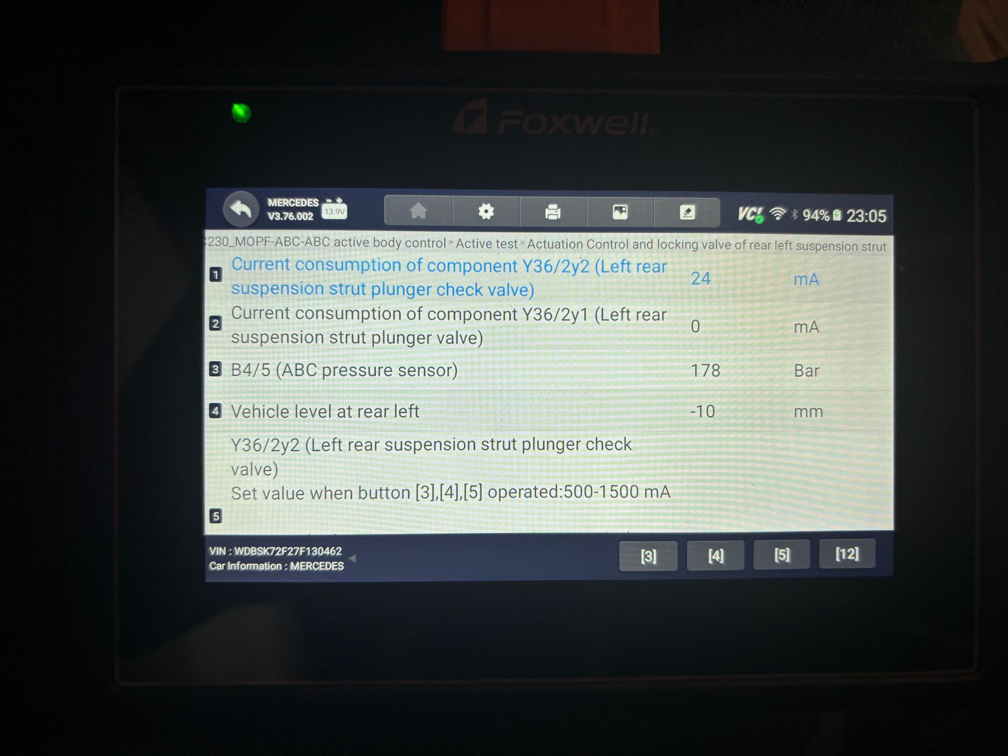

Ok. Looking at amp draw 3 places each corner, plunger check valve/plunger valve @ neutral, raised, lowered. Data were consistent at 0/0mA neutral, 520/200mA raised, 520/-208 mA lowered, except neutral at rear left were 24/0mA.
Level data in mm was also shown. There is some minor variation there. I am curious if mm level for front is supposed to be same as rear. The rear left is not same as rear right by 9 mm. I have attached some photos. Probably too much info.
i have not disconnect/reconnected accessory battery yet

I have made a chart of your values for my reference.
IMHO, your rear values are different by 9mm in all positions with the right rear reading higher. Maybe that is why at level position the rear left check valve is at 24mA instead of 0mA.
IIRC the level values (in mm) are calculated from the voltages on the level sensors, not the plunger values. While the plungers (inside the shock) must also return a voltage, they are usually represented by a value between 0 (fully compressed) and 100 (fully extended). These plunger values show the true position of the corner. As I understand it, when the full calibration is done (which fully compresses and fully extended both the front and the back) by comparing the level sensor voltages to the plunger values, the system determines how to map level sensor voltages to level values in mm.
Complicated?? Seems stupidly complicated which might be why some people give up on the system. Why even have level sensors when you could just read the plunger values? Maybe the 2007+ ABC system is simpler in this way.
I learned all this when my ABC system went into fully raised, super stiff mode after replacing all the accumulators and flushing the entire system during my AMG engine swap. The Benz Ninja tried hard to help me, but all these voltages and values might have been beyond him too. So I experimented with both DAS and my Autel scanner until I understood more of it. But I still had an ABC "hard" code which would not clear. Researching the code, it could only be cleared by performing the full calibration. So obviously I tried that but it keep failing because the rear shocks would only extended to 98%, not 100. I made sure there was no binding in the suspension, even took some weight off using my hoist, removed the plungers from the shocks to check them, but it stayed at 98%. Meaning rock hard at full extension and the code would not clear.
Getting desperate, I bought two ABC controllers on eBay (maybe $60 each). Swapped one in, cleared some minor "soft" codes and everything works fine. I think one side is a bit lower than the other, but the ABC has been fine for thousands of miles. I'm hesitant to try the calibration again as a failure might give me a hard code. Well, at least I have yet another controller.
If you cannot solve this in the next few weeks, I will get values from my car. They might be off because it is not calibrated.

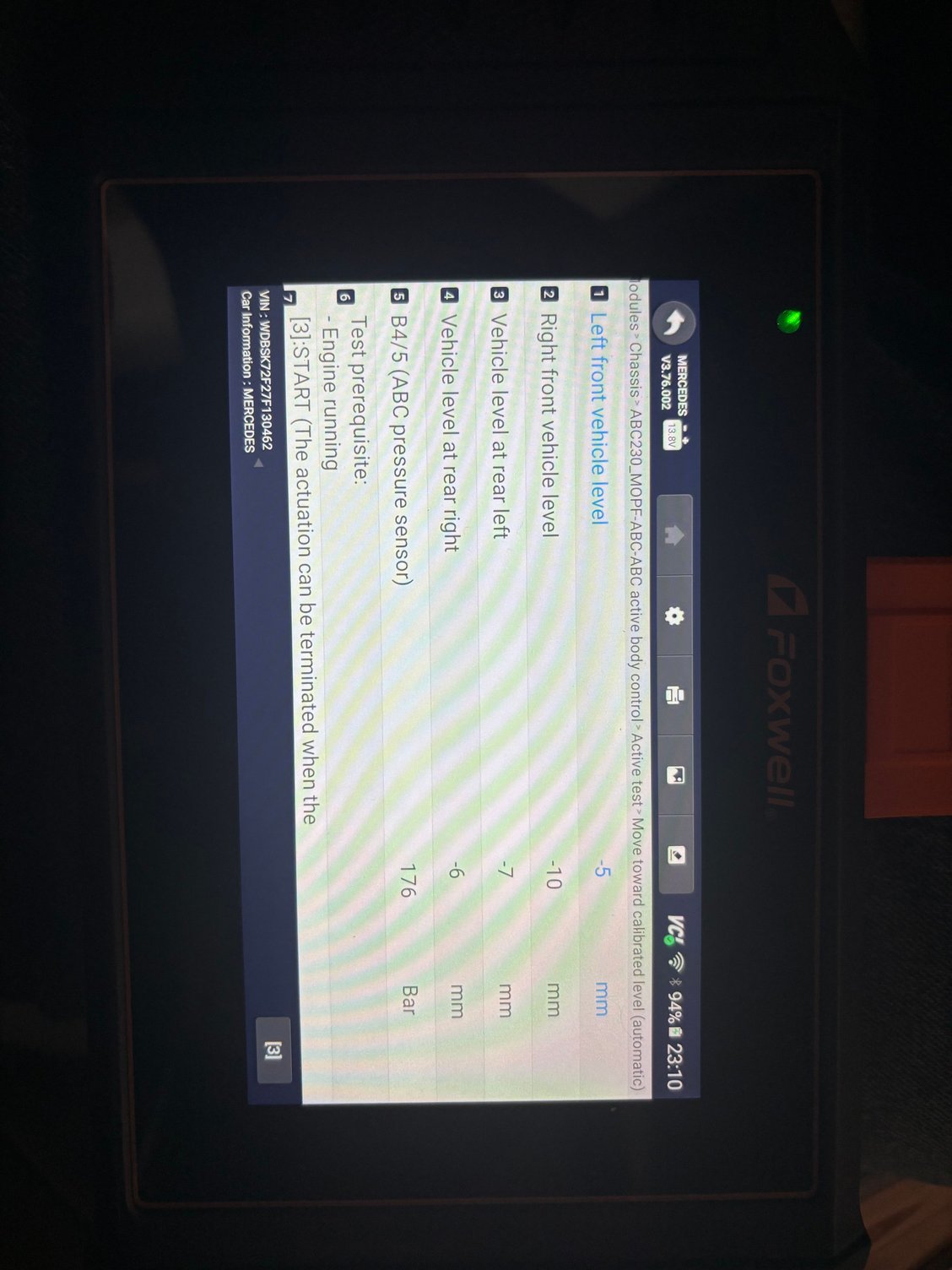

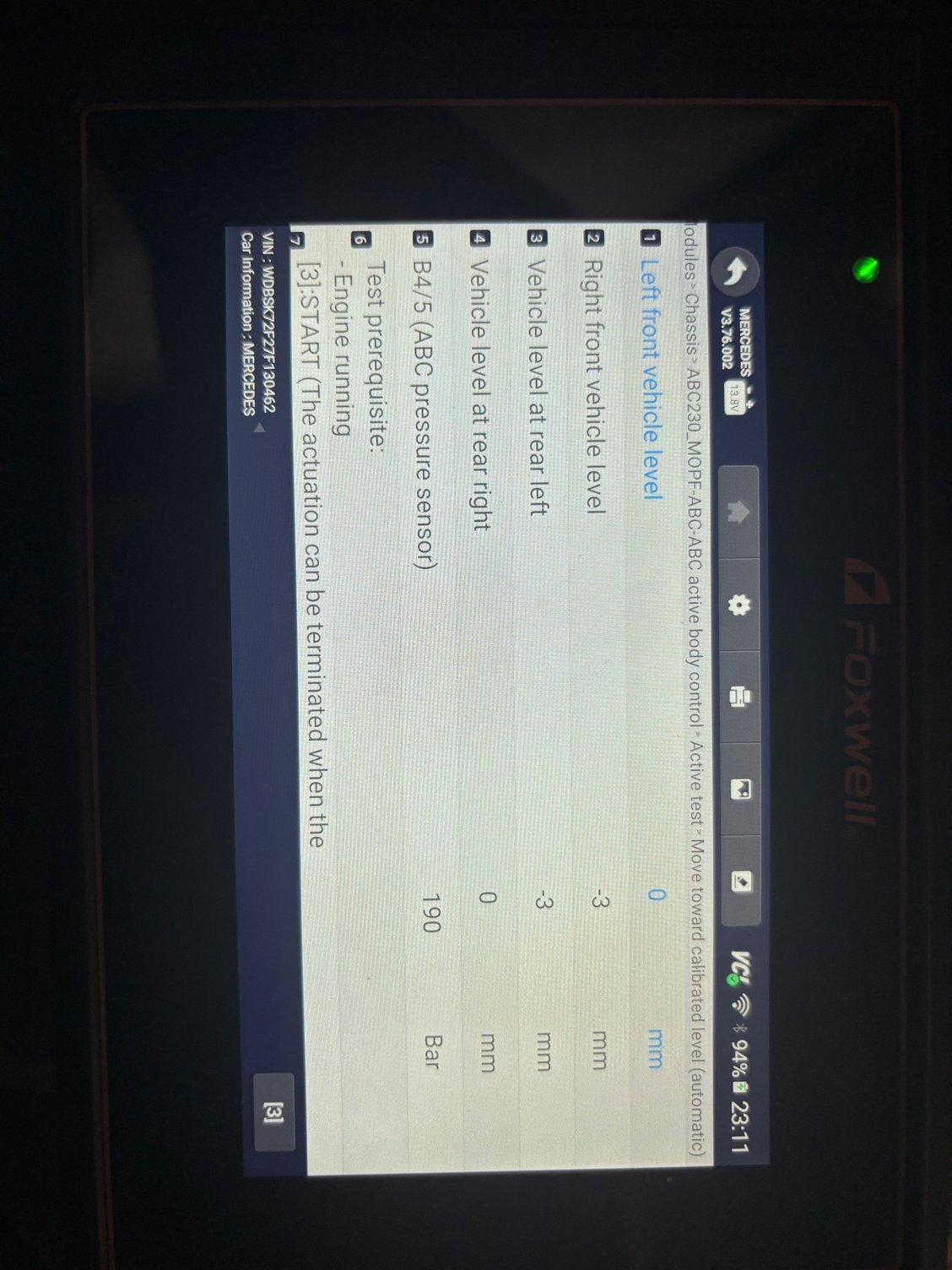

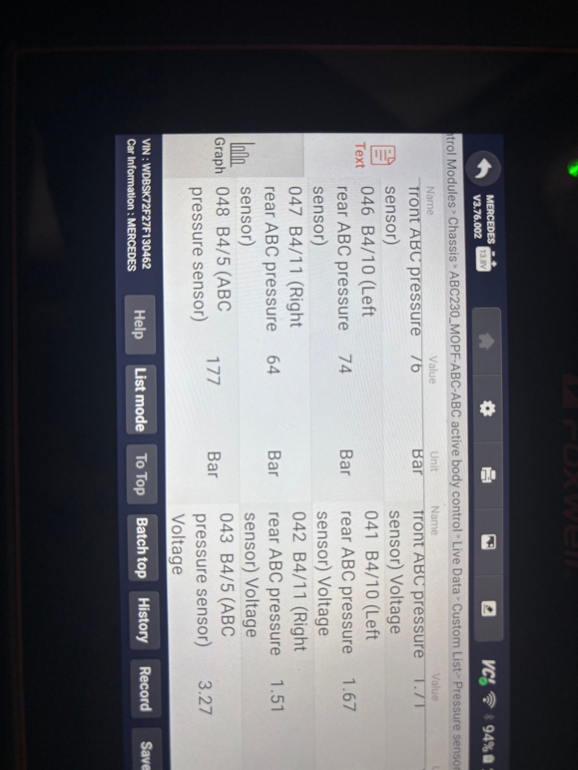

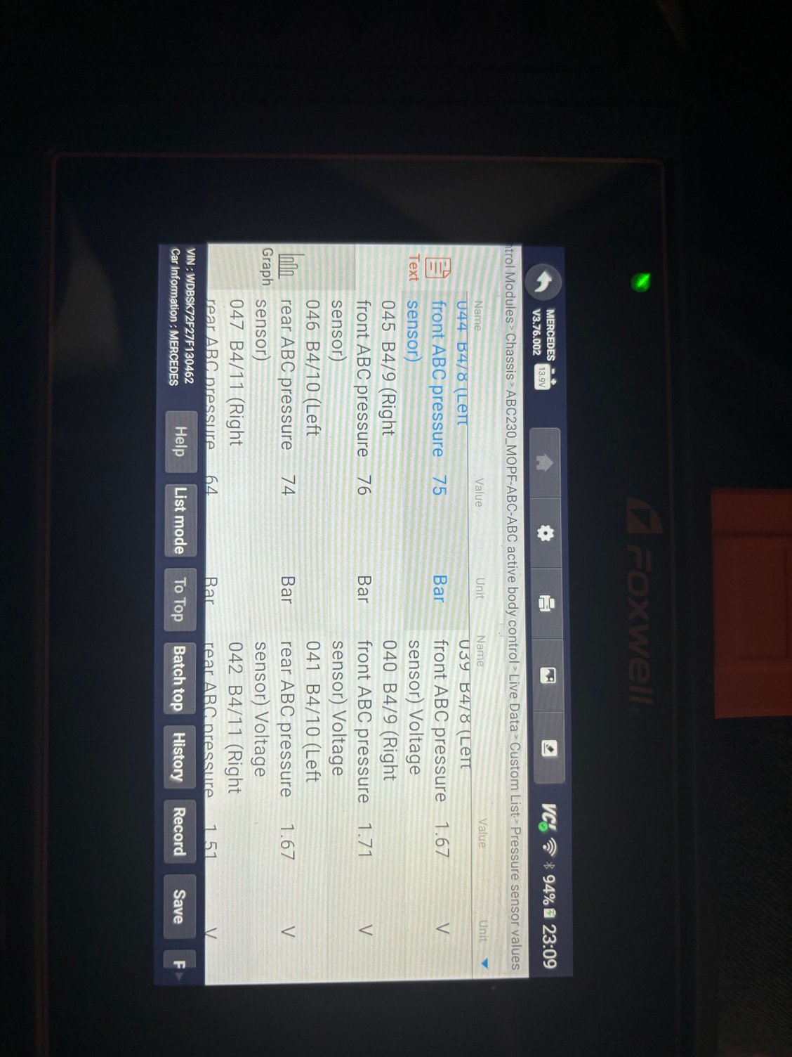

Mvredit: First of all, thank you for your time and effort. I’m grateful for your help. I really want to get this car working for me. Its a car i want to keep.
I have attached some screenshots that associate a voltage with pressure sensors. These seem to point also at right rear. Not sure if pointing at strut, calibration, or height sensor. Also attached are automatic calibration before and after. This can only run at neutral position. I will look some more, but I believe this is the only calibration adjustment my scanner offers. Do you know if front and rear struts are the same, esp. with regard to travel distance to top/bottom? Guess i could investigate this by checking if there is a different part no. for rear. Do you know if air induced while replacing accumulators/strut would naturally be removed by exercising level height and rodeo? Would air inhibit full strut motion?

Please confirm that you successfully performed the calibration which raised and lowered the front and rear.

I haven’t found where my scanner Foxwell 726 has a function to calibrate at different height levels. The function i did find is called “move to calibrated level” (automated). So i will search more thoroughly. I have friend with shop that has other scanners so i can swing by there and scan codes and attemp calibration

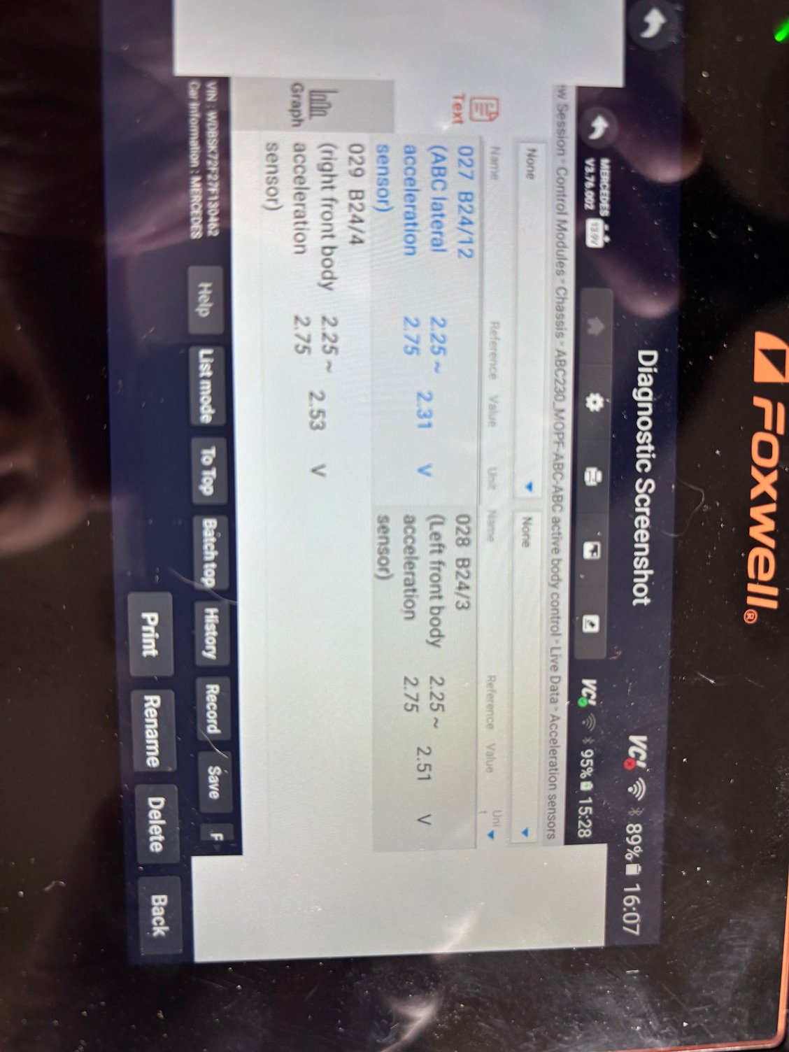

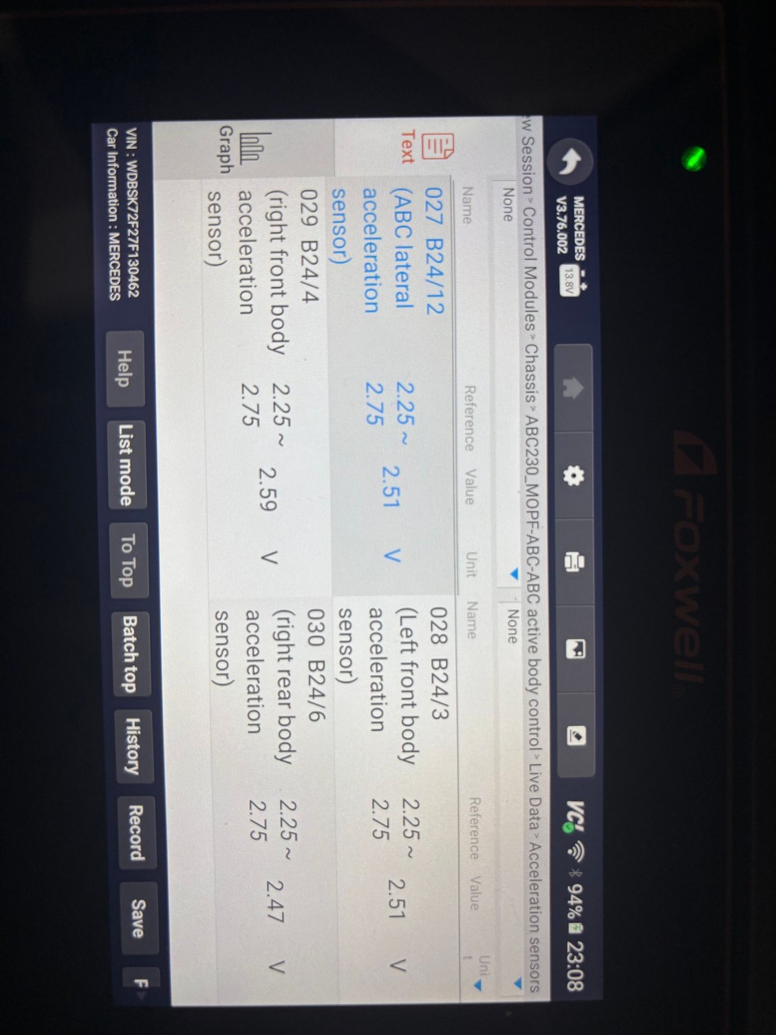

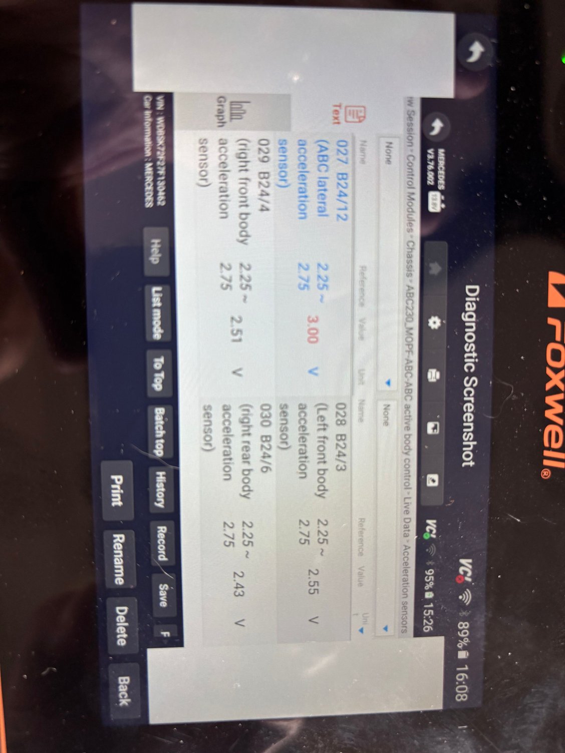

OK, I’m back at it. I unplugged the accessory battery to do a hard reset but still a stiff ride without any fault codes. The scanner shows for acceleration sensors: ABC lateral acceleration sensor, left front body, right front body, right rear body. that’s 4 acceleration sensors, not indicating for left rear body acceleration sensor. Should there be one? I drove the car with a scanner showing live data and the sensors indicate normally except for the ABC lateral acceleration sensor. It had a voltage of 2.3 and 3.0 the 3.0 is outside limits. All other sensors stayed pretty normal at or about 2.5 v.
I attached two screenshots taken while driving
i am curious about abc lateral sensor data, if sensor is faulty. I am curious why no sensor for left rear body when other 3 corners are shown.

When Car was just sitting in the garage, all four acceleration sensors showed live data. When driving there was a number of screenshots that only showed one or two sensors so I’m wondering if the other sensors are functioning intermittently if that means they are faulty. One such screenshot example is attached above

You are now past my experience level. I'm now curious what my car reads; maybe I can check this weekend if the weather holds.
I would expect the acceleration values to change as you drive; if one stays at 3.00V no matter what, IMHO that indicates a faulty one.

Acceleration sensor
I thought maybe this thread got closed so i started a new one, accelerator sensors. I attached graph screenshots there. The 3.0 reading was a snapshot it varied while driving. And your experience level is way beyond mine, nevertheless i still really want to solve the problem. I found a schematic for the electrical components of the first GEN ABC and it actually shows five acceleration sensors. My scanner only showed four and three of those were somewhat intermittent. the schematic I looked at indicates there’s a B 23/14 longitudinal acceleration sensor and I don’t get any indication for that one. The schematic says that is the one that’s behind the passenger seat perhaps somewhere in that area. I am also assuming that the sedan and the coupe both have similar abc systems. Not sure what to make of the intermittent data for three of the sensors so tomorrow I’m going to try a different scanner and see if I get something similar.
