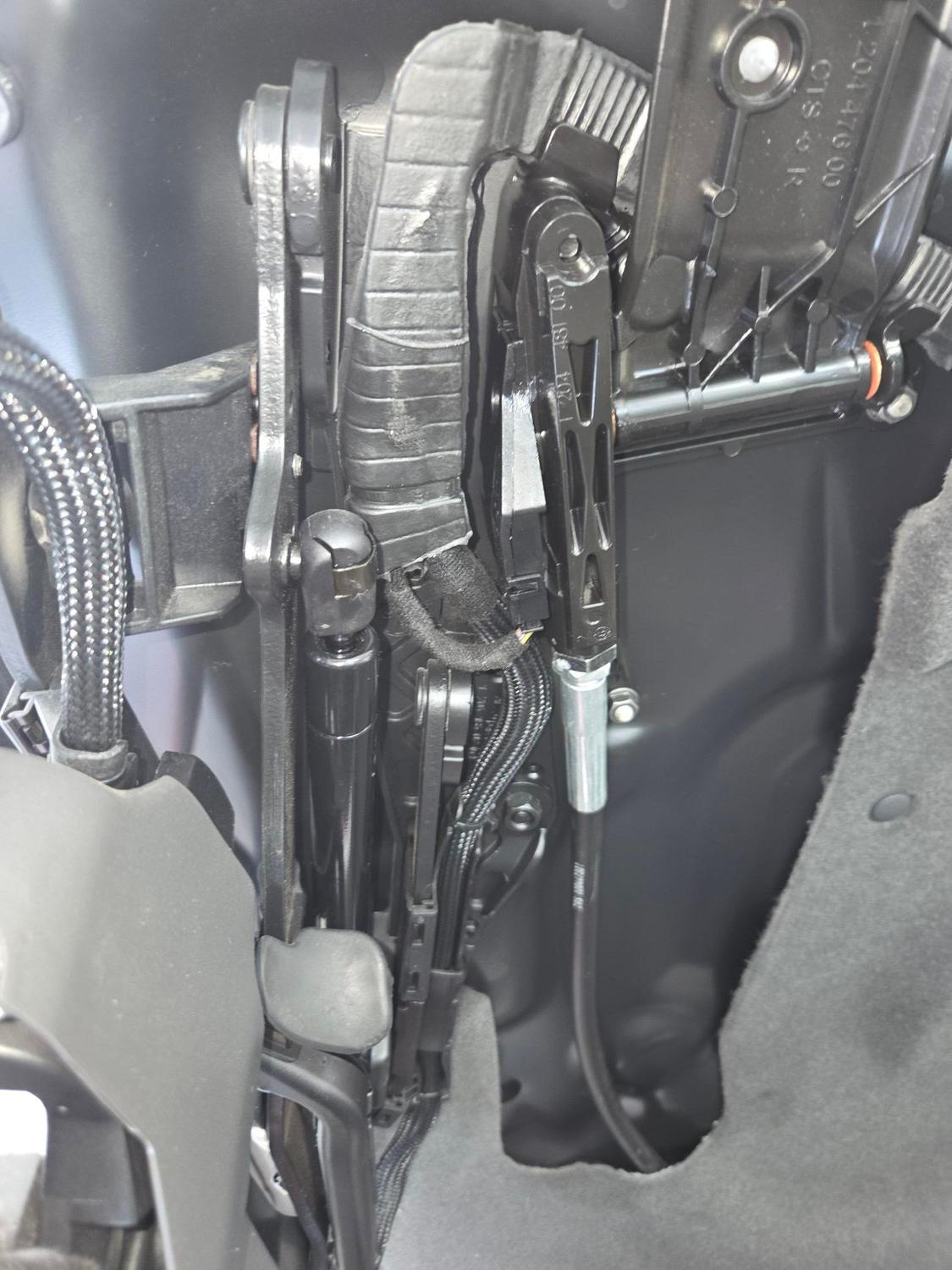

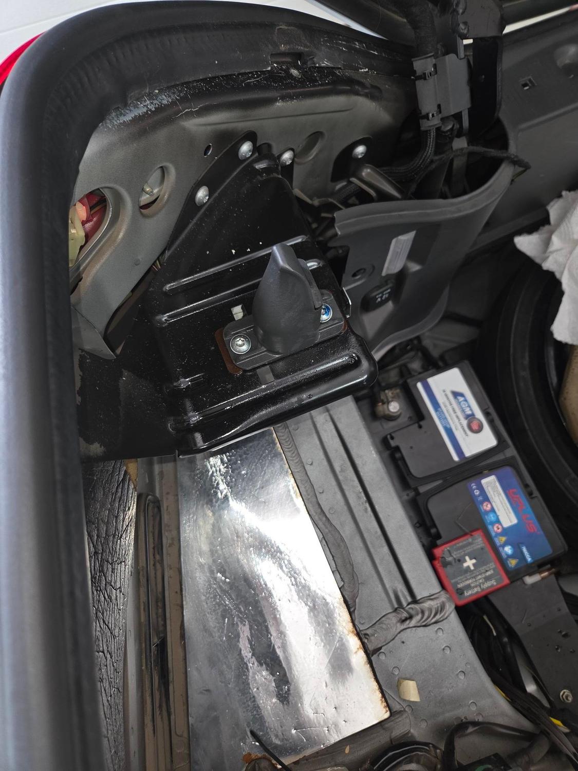

I took the trunk apart this morning and the only signs of fluid were on the passenger side near the back of the trunk and on the trunk lid. I included pictures. I don't see a cylinder on the trunk lid.

You were right. Saw a slight drip from the manual unlock button cover at the front of the headliner and as I removed the headliner the rest of the missing fluid showed up. Fortunately my wife was ready with the towels and we had put plastic over the seats and doors. The weather stripping on the passenger side window is ruined as you expected. I also have to chase down some of the fasteners at the back of the headliner as the mounting plates broke instead of the lock button coming out. This $10K beauty is rapidly turning into a $15K PITA.
