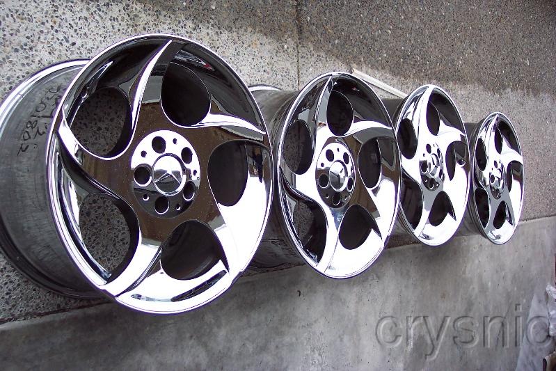

Anyone know the offset of these rims? Mercedes Wheel Part# Front: B6 647 4081 Rear B6 647 4083

Love the look of these.
Be good to see the photos when they are on the car.

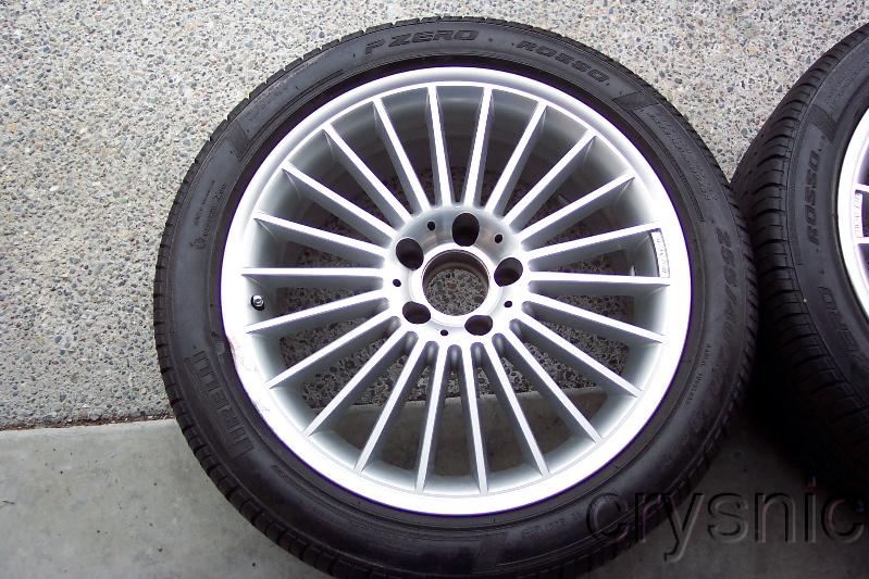

Here is another wheel off the 2004 SL, I found out these have ET of 30mm front, and 33 rear. So I would assume the chrome one in the first thread are close to this offset.
I intend on having the existing axle flanges redrilled for 14 mm wheel bolts like the later S class has. Using a 20 mm hubcentric spacer this would put the offset closer to 10, which is appropriate for a 1969 300 SEL using 18 inch rims.
I would prefer to use the front 8.5 inch wide rims on all four corners, the rear 9.5 inch wide rims are a little much. The SL tires are also way to wide, probably go with 225/40/18 in the front and 245/35/18 in the rear.
I plan on rolling all the fender well lips. I may only be able to get a set of the chrome SL rims, which means I would probably need to have the inner rear fender wells enlarged with new tubs.
