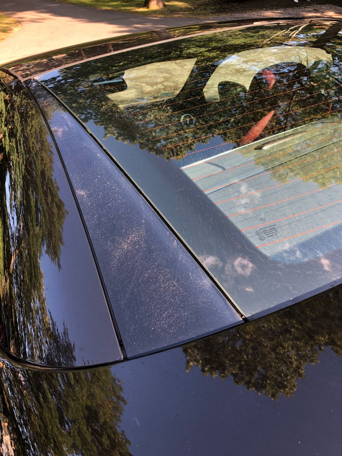

Anyone else get this “metalflake” effect?
Not sure what to call this body part:

I have seen this on other SL’s. I believe, but do not know for sure, that it is caused by extensive exposure to the sun.

Similar to what happened to some with R230’s as well. I remember the parts were quite cheap...
c-pillar trim is what it was called on the slk, where it also was something that flaked up & looked pretty bad
Also called “C pillar panel”. There’s a couple of threads on this in the r230 forum you can find by searching there. R230 guru Ruedney confirms its caused by sun exposure and has a link to DIY replacement instructions if you’re so inclined. Part is reportedly about $100 and is held in place by a plastic catch underneath.

I have the exact same thing on my R230 and on that one, I have just put tint on it. That said, since its under warranty you have nothing to worry about.

Not original owner, but I do have a good relationship with a couple dealers, what with 3 Benzes at a time taking turns getting $150 oil changes, lol! My warranty ends 9/30 and I'm happy to say they replaced these parts, and gave me a killer free detail....
