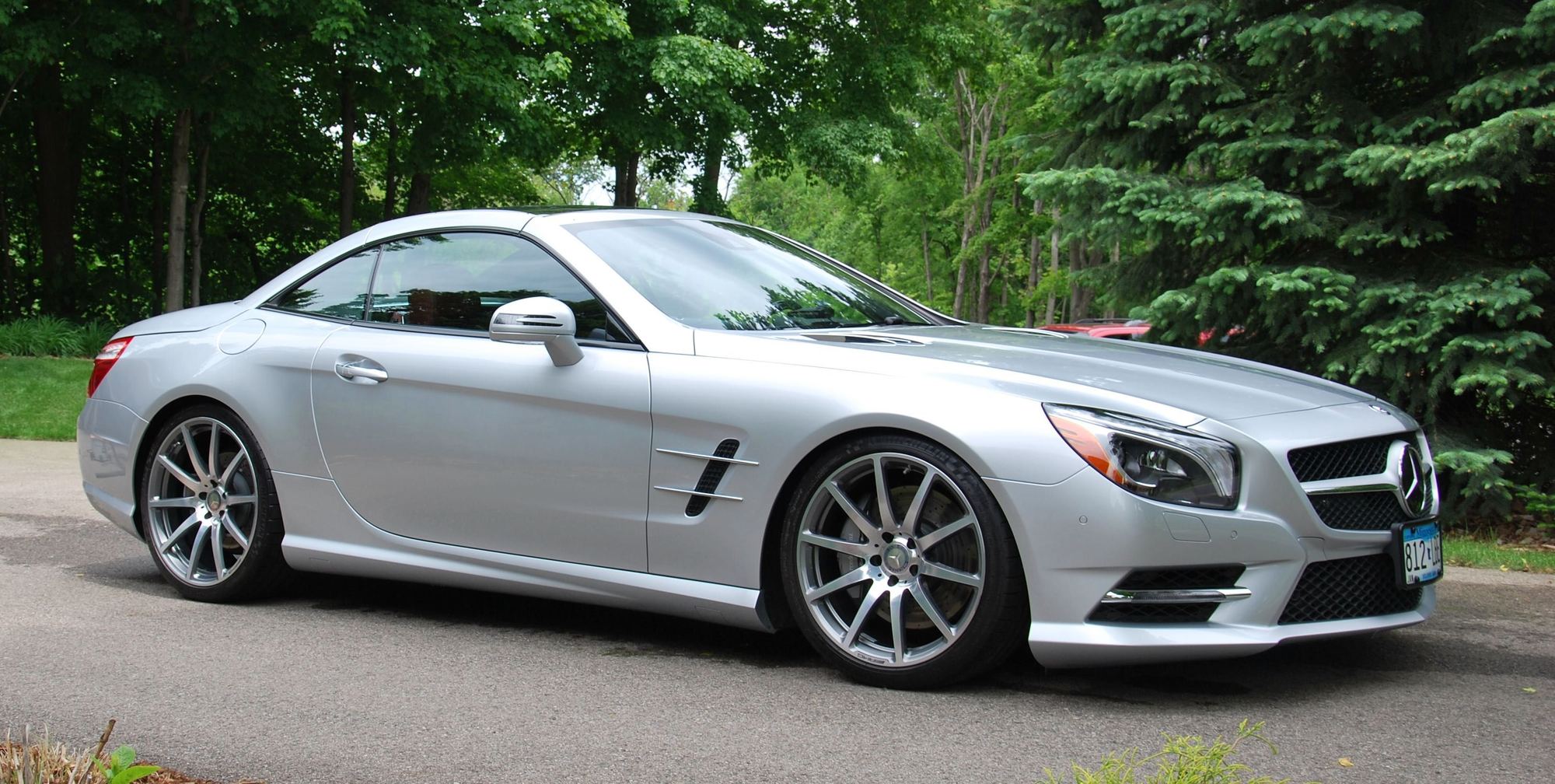

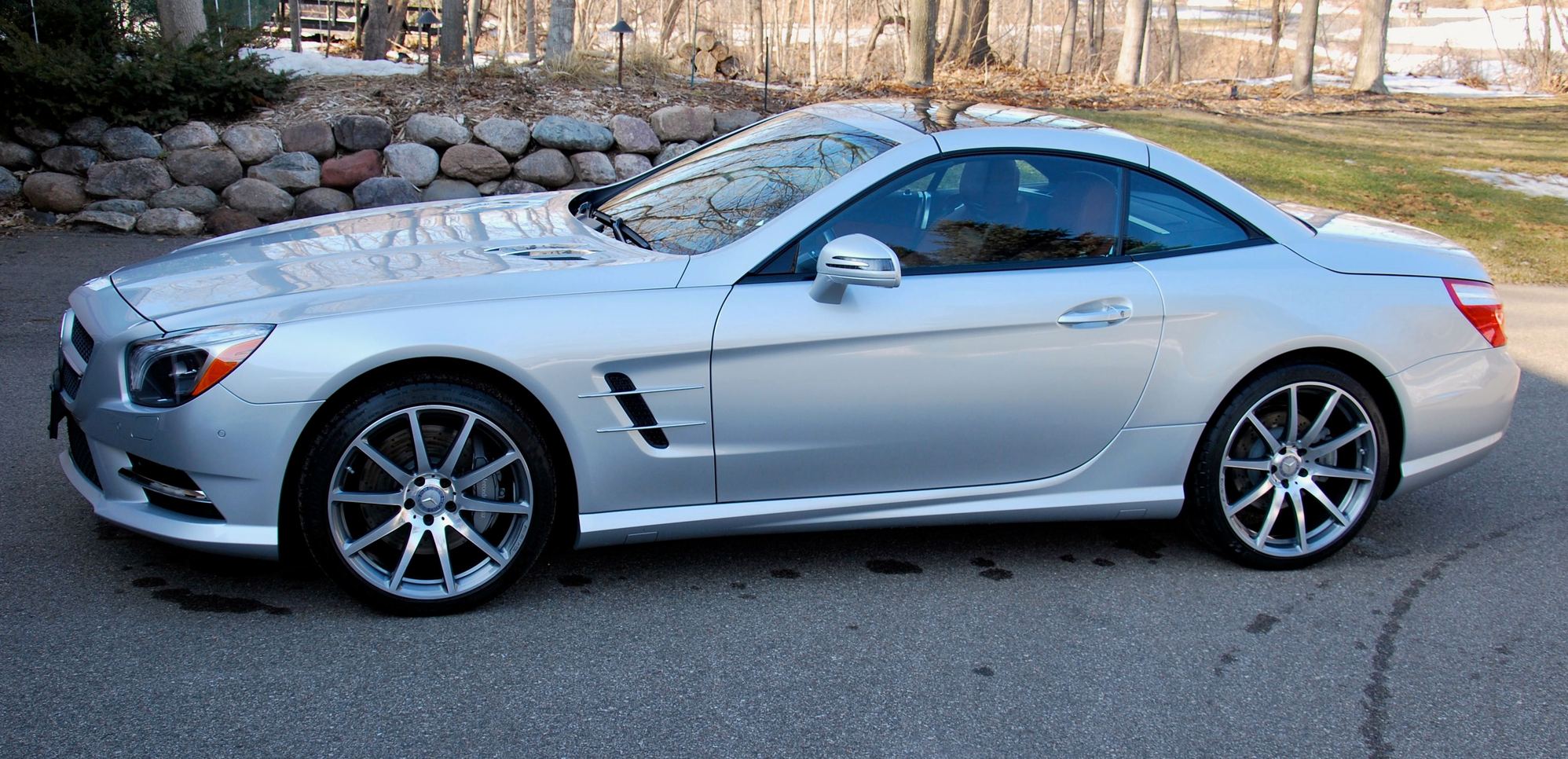

This is with 245/35-20 on 8.5" et16 and 285/30-20 on 10" et28:
Stock:
H&R lowering springs lower by about 1.2" both front and rear. That will not be enough with 3" rear gap (do you have a side shot of your car?), so IMHO rear taller tires, 285/35-19, will be required. H&R spacers will also help.
Car looks great! Still a bit tall but the tires help.
At the time I thought a 1.2" drop have been great. Interestingly, the drop was more than anticipated in our case. The case of being too tall and too low (pre-spacers)

White Arrow Edition was made with option Mercedes chose and ABC unfortunately wasn't one of them. For instance it has night assist and I never drove the car in the dark. Everything else, from 2Look exterior to gorgeous 2 tone premium leather to alcatara headliner, I like a lot. Actually ordered Iridium Silver(my first color choice) with ABC, but since my better half wanted Dimond White as the first choice, when we saw SL63 and SL65 High Contrast Package cars in the showroom, we decided to cancel Silver and to wait for White Arrow SL550. Hence no ABC for me.
Now looking back, 295/30-20 rear would help just a bit further. However, this would require 255/35-20 front which based on my quick measurements would rub, but since I did not try it, I do not know in fact wether it would rub or not. But now I think I made error in calculation as I added full 5mm diameter difference (of 245/35-20 vs. 255/35-20) on top which made it clear it would probably just rub, however I should have added half of that difference, lets say 3mm, which now I think would just clear up top. Since I have two sets of 20" wheels both with 245/35-20 & 285/30-20, I do not want to bother now for only 3mm gain. I am content as is.

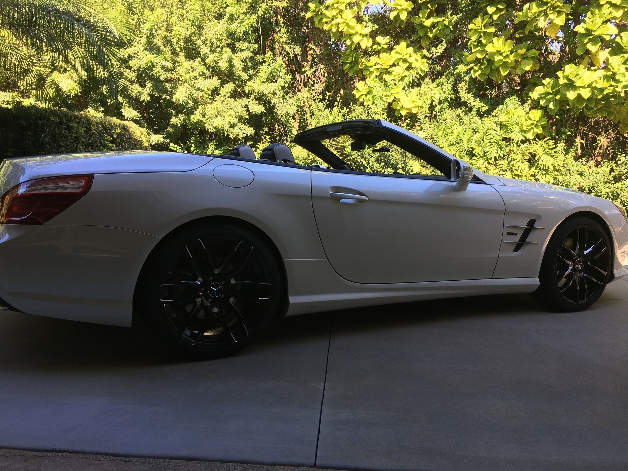

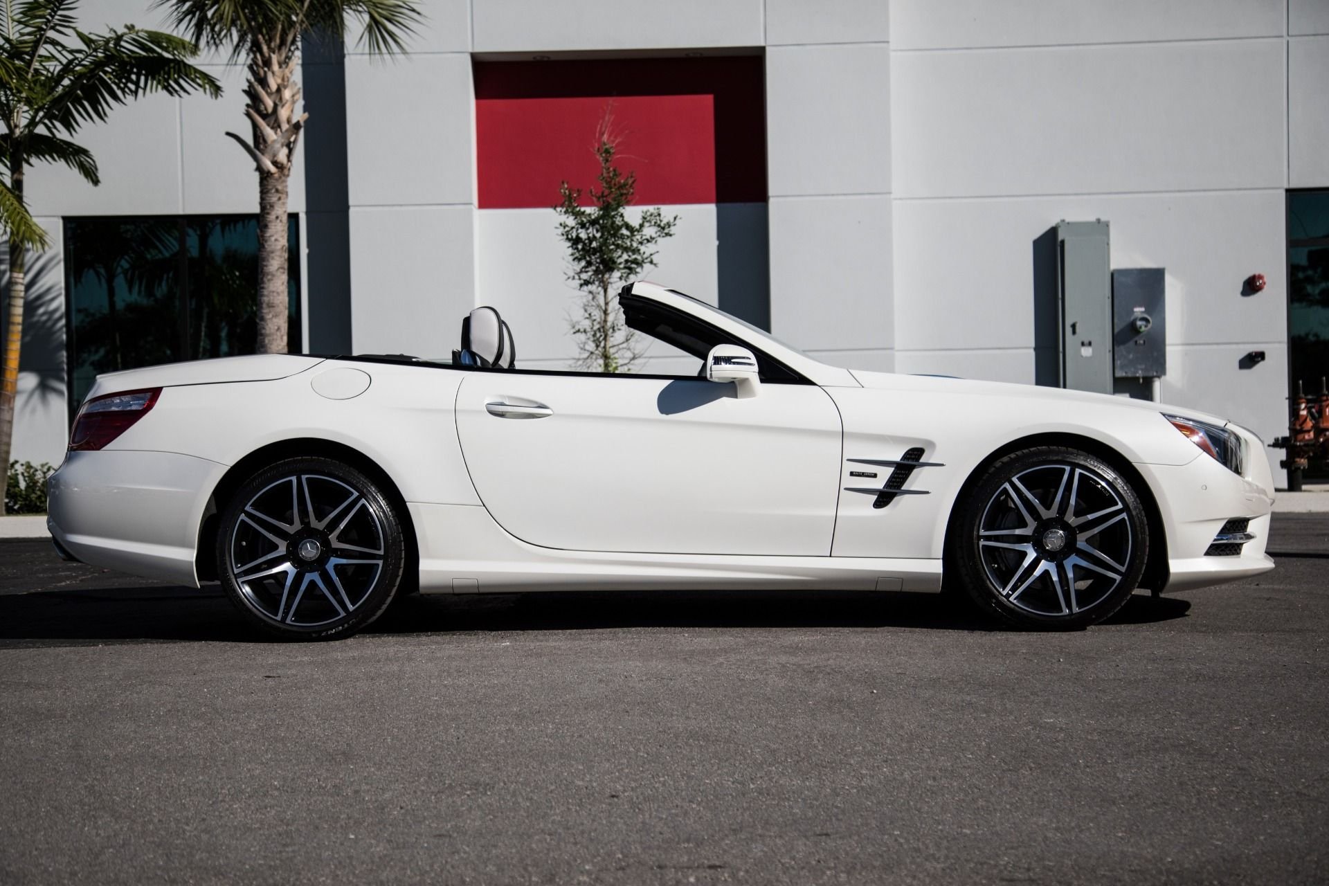

Here are the profile photos:
I can live with the front but the rear is ridiculous......
I am sure than installing 245/40-19 front and 285/35-19 rear tires with 15mm front and 20mm rear spacers will make a big difference (your ride will be a lot better too - higher sidewall and conventional tires). Since you're in FL, Continental's Extreme Contact Sport for under $1K would be great choice, or you could go for the ultimate - Pilot Sport 4S for about $300 more. Same tire(s) is(are) also available in 255/40-19 front and 295/35-19(with 15mm spacers vs. 20mm) rear if you want to be a bit more aggressive.
