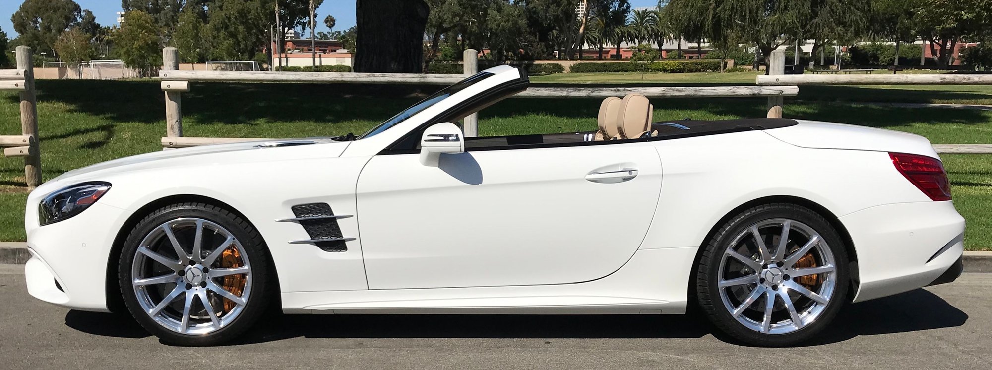

I can’t say enough about the Michelin A/S3+ tires. I put them on my SL450 and they are very smooth riding and quiet. I don’t drive aggressively, but from what I have seen, the handling is very nice as well. I do, however, live in sunny, Southern California and the car never sees inclement weather. I really like the way the tires look as well.

Streamliner...
thank you. That is exactly the kind of thing I was hoping for. We probably won't see any snow or ice with the SL.... We probably won't see any real cold weather......BUT unlike where you are, we will probably see some rain from time to time. Have you had much experience with rain and cornering traction or stopping with the Michelins? Thank you. You comment about comfort is good and I have always liked Michelins.
Also, what wheels are those and what would be a budget price for them.? They look great!!! I think they would look great on my blue as well. Man, they really set your car off.

I have not driven a car with the A/S3+ tires on anything but dry pavement.
The wheels are the ones that came as original equipment on the 2017 SL65AMG. They are forged and polished. As with most all forged wheels, compared to cast, they were rather pricey. The two threads linked below go into all the details, should you wish to check them out:
https://mbworld.org/forums/sl-class-...hty-mouse.html
Sent from my iPad

Very tasteful updates on a beautiful SL
Your wheel setup is very unique in that you chose the front wheels for the rear as well and the setup works quite well even if I like the 20" in the rear a bit better. In general, one can't go wrong with Michelin tires. My go-to choice is a Michelin Pilot Sport 4s (PS4s), followed by the Pilot Super Sports. Picking one or the other is often decided by the availability of tire sizes for the rims rather than preference but I am sure the A/S3+ will be very capable. Less performance but better for colder temps. Performance tires loose significant traction below 50 degrees.
