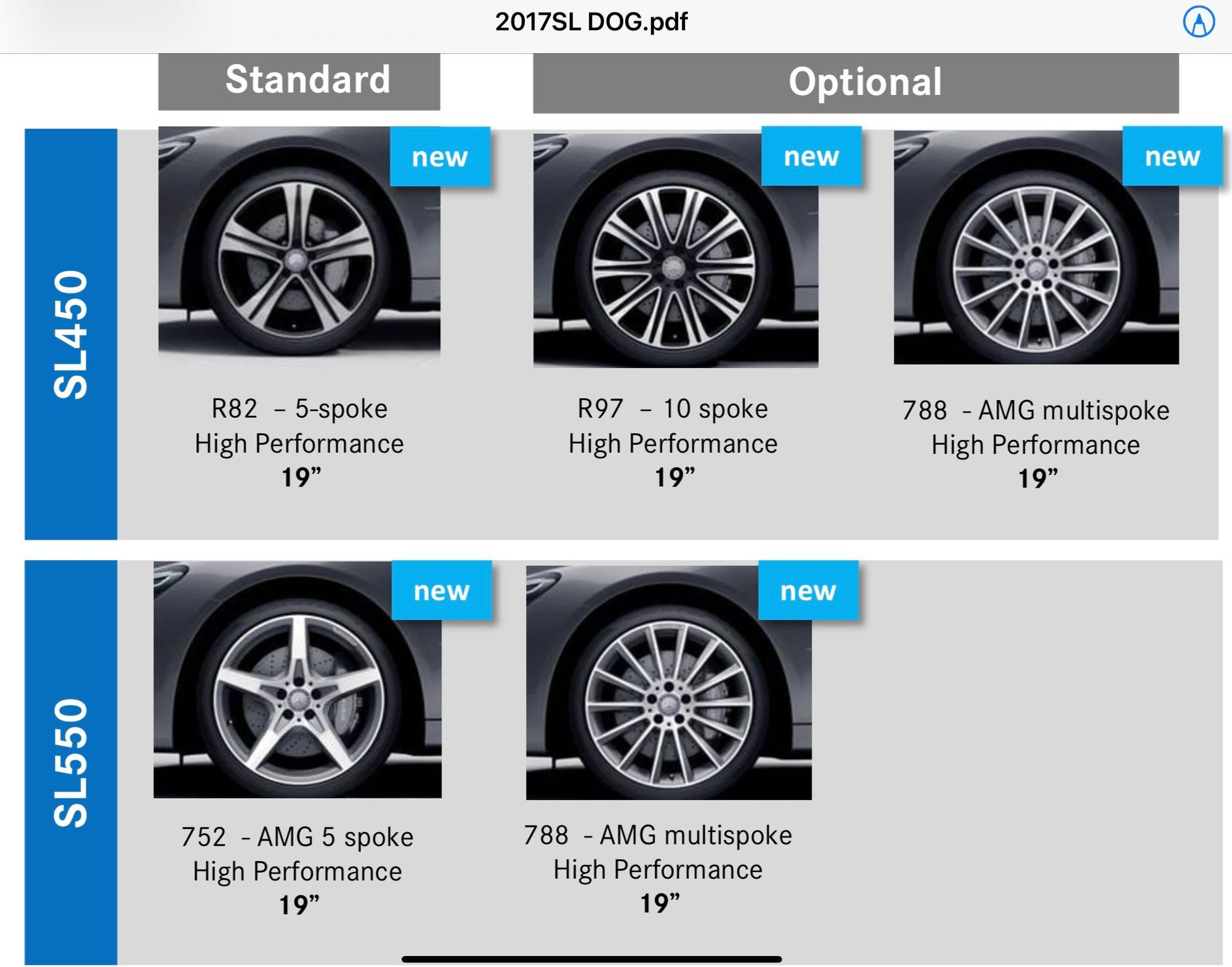

Sorry, I got you mixed up with someone else, as I thought you had an SL63.
Here are the wheel options for the 2017 SL450 & 550:
So yes, it would appear that the AMG wheels you have are original equipment. Nice!

THANK YOU.... It amazes me the knowledge and information available from members on this board. I see that the AMG wheel was an option and not the standard wheel. The picture showing standard and option was great.... Exactly what I was asking. Thank you.

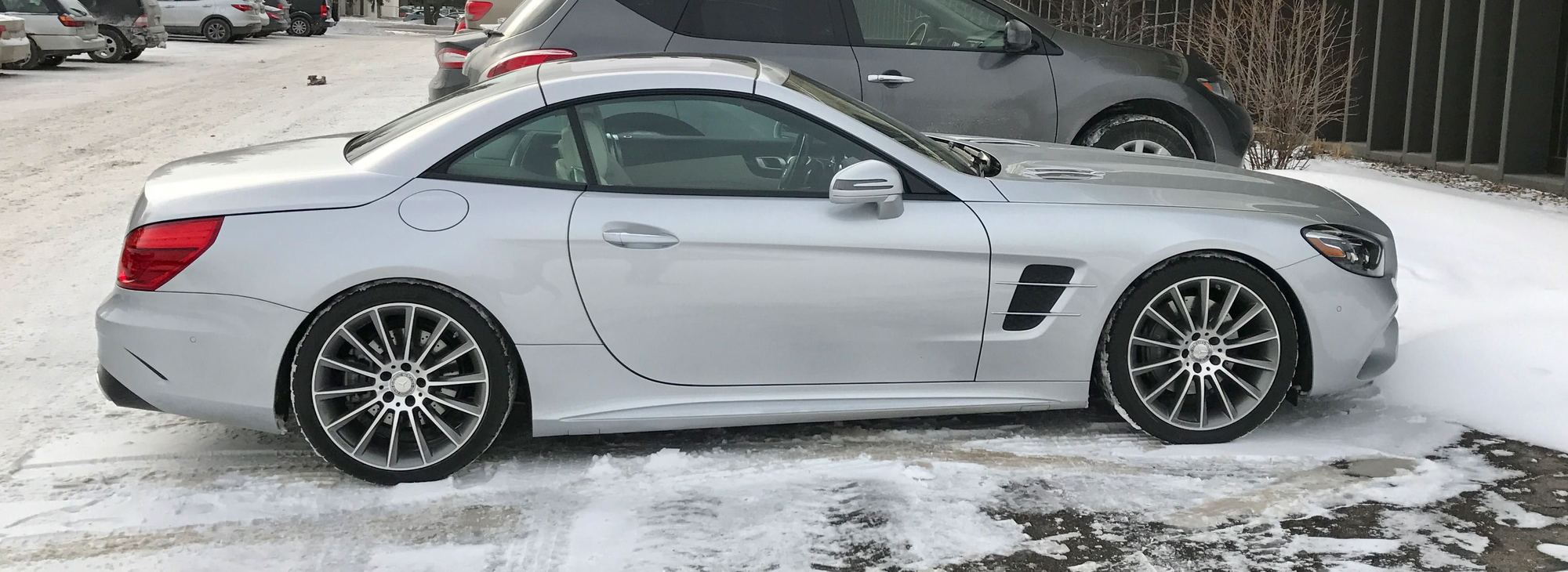

Here is a pic of our (dirty) SL with stock 19" AMG wheels, snow tires, lowered and with spacers. Just for reference..

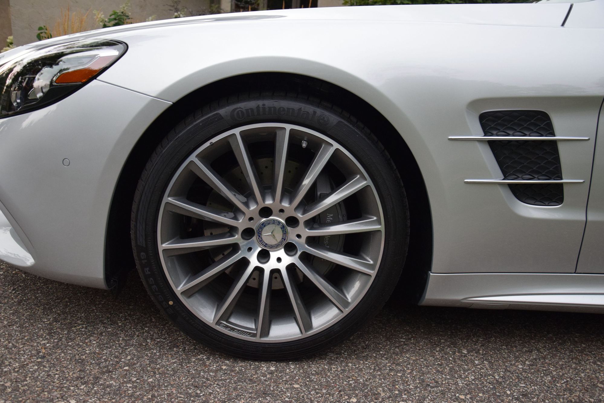

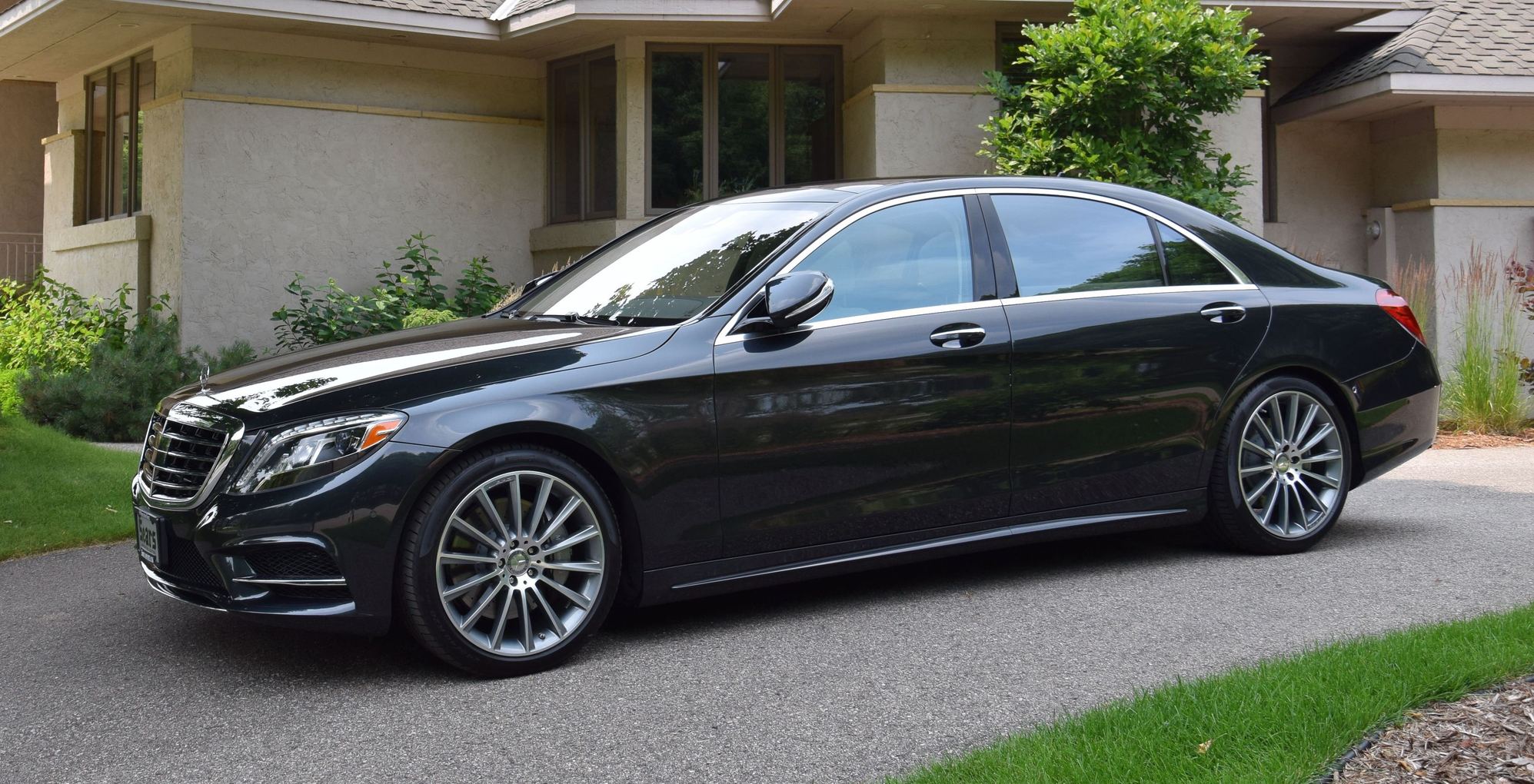

You can but I don't know if it will look good. The finish is the same but beware these wheels were manufactured in several finishes. We had 2 cars with the same wheel design & color (see pics)
Here is the info:
Finish: 7X21 High Sheen with Titanium/Himalaya Grey
S-Class Wheel - Rear: 9.5Jx20 ET38 (p/n A22240105007X21 - A2224010500647X21)
SL Wheel - Rear: 9.5Jx19 ET48 (p/n A21840112007X21)
The rear wheel will extend by 10mm vs the SL wheel which is a good thing and you might pick another 10mm spacer for the rears if lowered.
Hope this helps!
