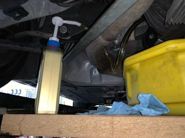

As posted in my introductory thread I could not find any evidence of the differential oil having been changed in my 8 year old 20.5k mile SL63, so I decided to do it myself. Per the manual, AMG R231s with the limited slip differential are to have the fluid changed at 2000 miles and thereafter every 40k miles / 4 years.
There are a few threads on differential fluid changes so I am not breaking new ground, but there are not many pictures and some contradictory information on fill plugs, so I thought I’d document my experience.
Guided by the Mercedes BeVo site, I bought 2 liters of
Castrol Syntrax Limited Slip 75W-140 oil Castrol Syntrax Limited Slip 75W-140 oil
. Note that non-LS differentials use a different oil specification. I also purchased a couple of hand pumps,
this one this one
worked perfectly.

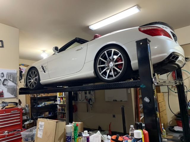

I raised the car on my 4 post lift. Boy that thing has sure come in handy the last several years!

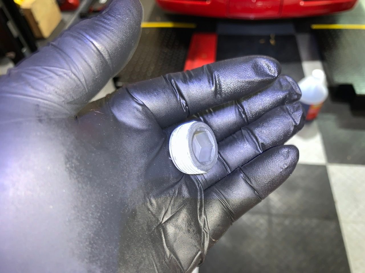

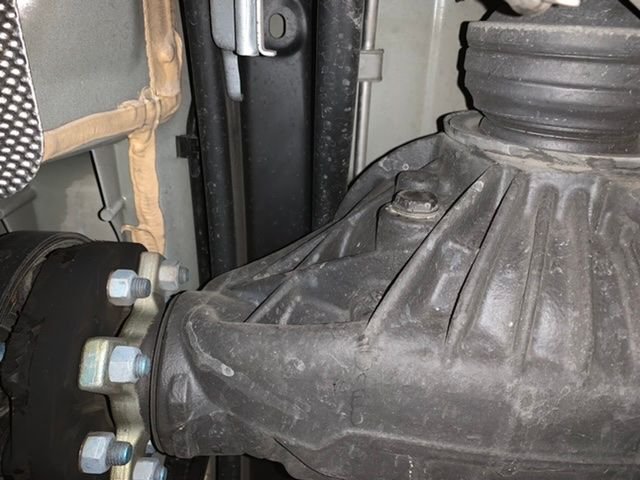

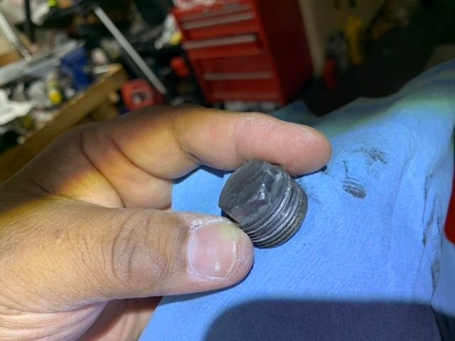

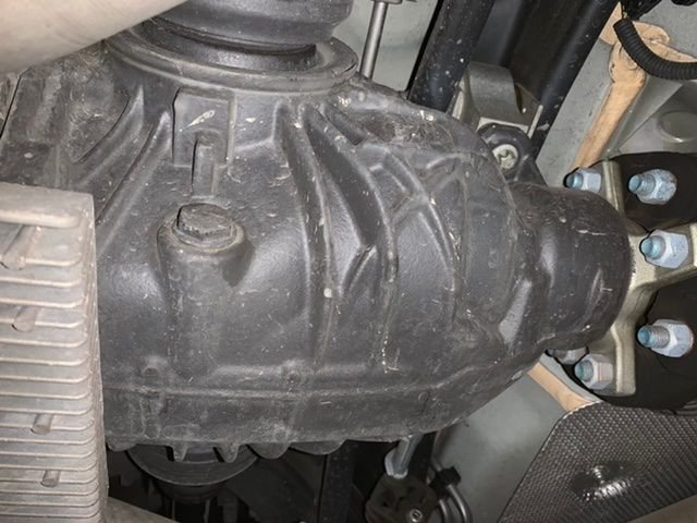

The fill plug (always remove this first!!) is on the driver side of the differential housing and the drain plug is on the passenger side. Both are 19mm conventional hex plugs, at least on my car, as I have seen several other sizes mentioned in other posts. The entire differential case, including both plugs, is painted in a gray finish. When applying torque to remove the plugs, this paint chipped - which led to momentary panic as I thought that the plugs were soft aluminum and were being destroyed by my socket wrench. But no, the plugs are steel and it was only the superficial paint layer that was getting chewed up. Two takeaways are (1) the pristine condition of the plugs most likely was proof that the oil had not been changed before, and (2) some internet sites state that you should have new plugs on hand for this change - that is unnecessary IMHO as it is hard to damage the plugs beyond the paint layer.
The fill plug - view shows driver (left) side of differential housing with front of car to the left.
The drain plug on passenger (right) side of differential housing - front of car to the right.
One of the removed plugs showing damaged paint layer but perfectly fine steel plug

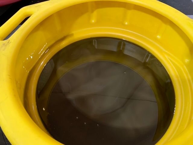

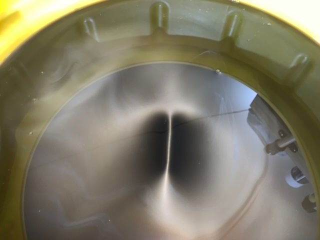

For inspection purposes, I drained the oil into a shallow pan. It seemed like a dark suspension, but not gritty to the feel. On a whim, I dropped a strong bar magnet into the pan, and immediately there was a perfect magnetic field visible. That told me that there was ferrous material suspended in the oil, but after swirling the oil all around the magnet and letting it sit for a while, there was no gritty / granular material on the magnet at all. So not really a problem.
To fill up the oil, I used the pump mentioned above. It worked like a charm. The stated capacity of the differential is 1.2 liters. I used a couple of squirts of clean oil initially to “flush” the housing with the drain plug still open, and a fair amount was lost in spillage, etc., so I used a total of about 1.6 liters.
I used Teflon tape on the plugs and tightened them to the standard German DIY spec of “gutundtight”.
In summary, an easy DIY. Hopefully these pictures help someone else.

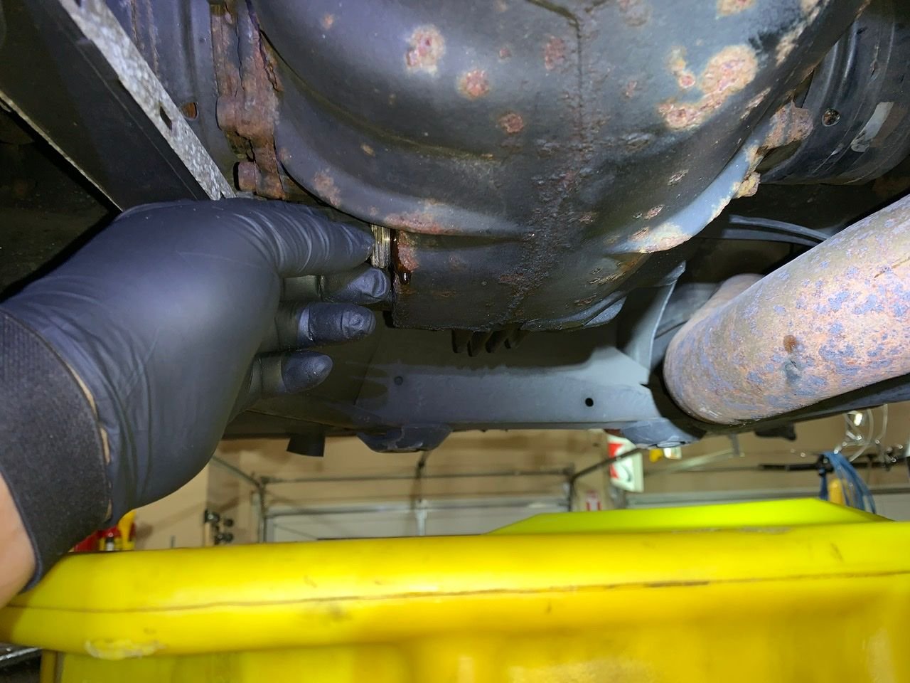

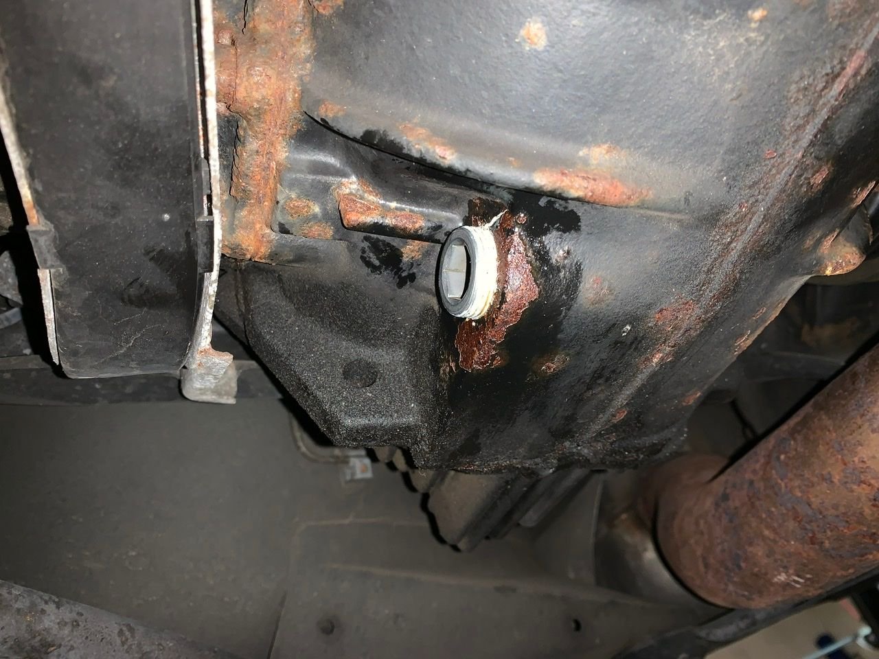

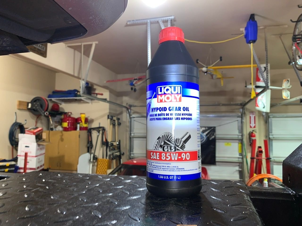

BTW I just did a differential fluid change on my recently (well 4 months ago) acquired R129 SL500. Yes I know, different forum, but some of the comments about the non-AMG R231 SL diffs makes me think that MB has been using some carryover parts. Specifically, the fill and drain plugs were internal 14mm hex and the specified oil was 85W90, which is incidentally no longer carried by MB dealers. I ordered and installed new plugs because the existing ones were heavily rusted, and I used Liqui Moly 85W90 hypoid gear oil.
Here I am removing the old drain plug. Both old plugs were rusted in place and I had to apply PB Blaster penetrant and let sit for days. Also the rust initially wouldn’t let me insert my 14mm hex key so I had to wire brush them extensively; the penetrant helped here also.
The oil that I used, and one of the new plugs from MB. Relative to the previous discussion, these new ones had a thread sealant already applied, so I didn’t add anything else.
