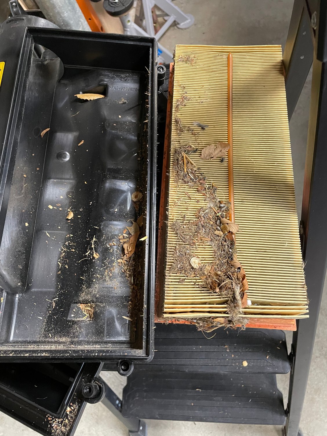

These things are like a vacuum cleaners. They flow a lot of air volume 😀 inspect the air cleaners often!
LOL! Here’s an air cleaner I pulled off recently.

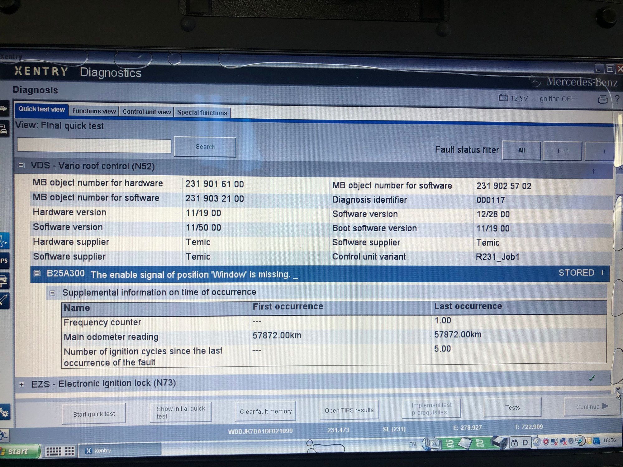

The vario roof should store some trouble codes, The dealer should be reading them. It’s possible they didn’t store but the vario roof has quite a few micro switches.
Did they even scan the car? Next time you bring it in, ask them if it triggered any codes?
Here’s one on a car that had intermittent roof issues. It kept triggering codes and had a faulty top module: 2319006905. It has redesign/superseded part#: 2319003608
I cleared it several times but kept coming back. After replacing module, top now works perfectly.
