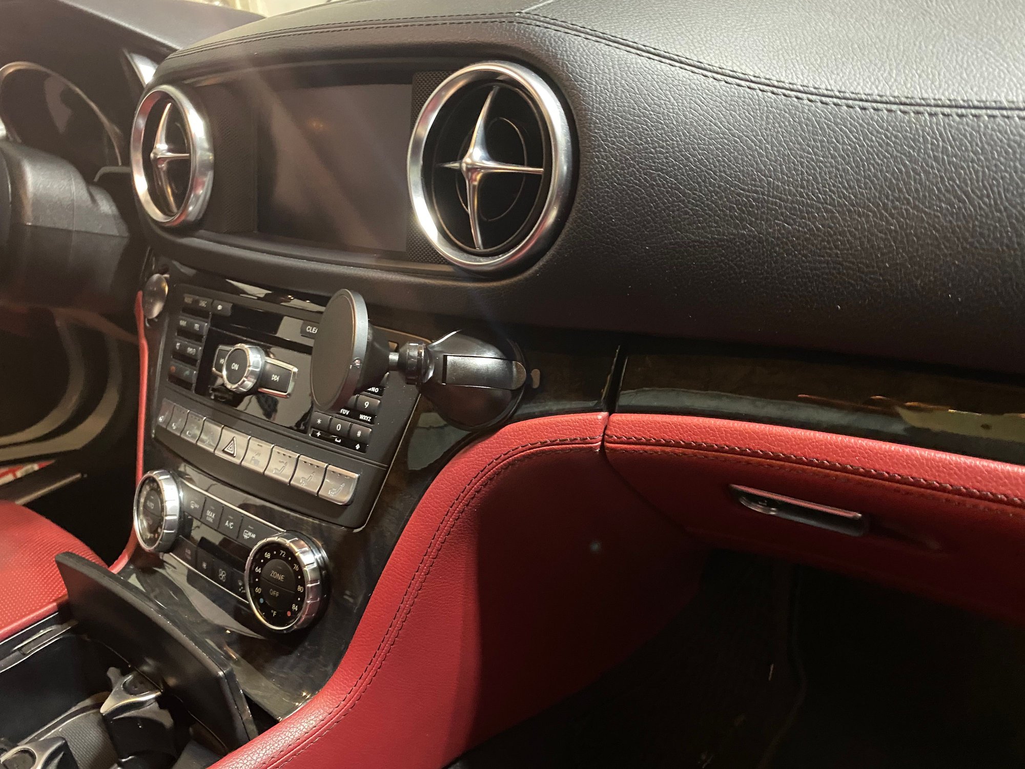

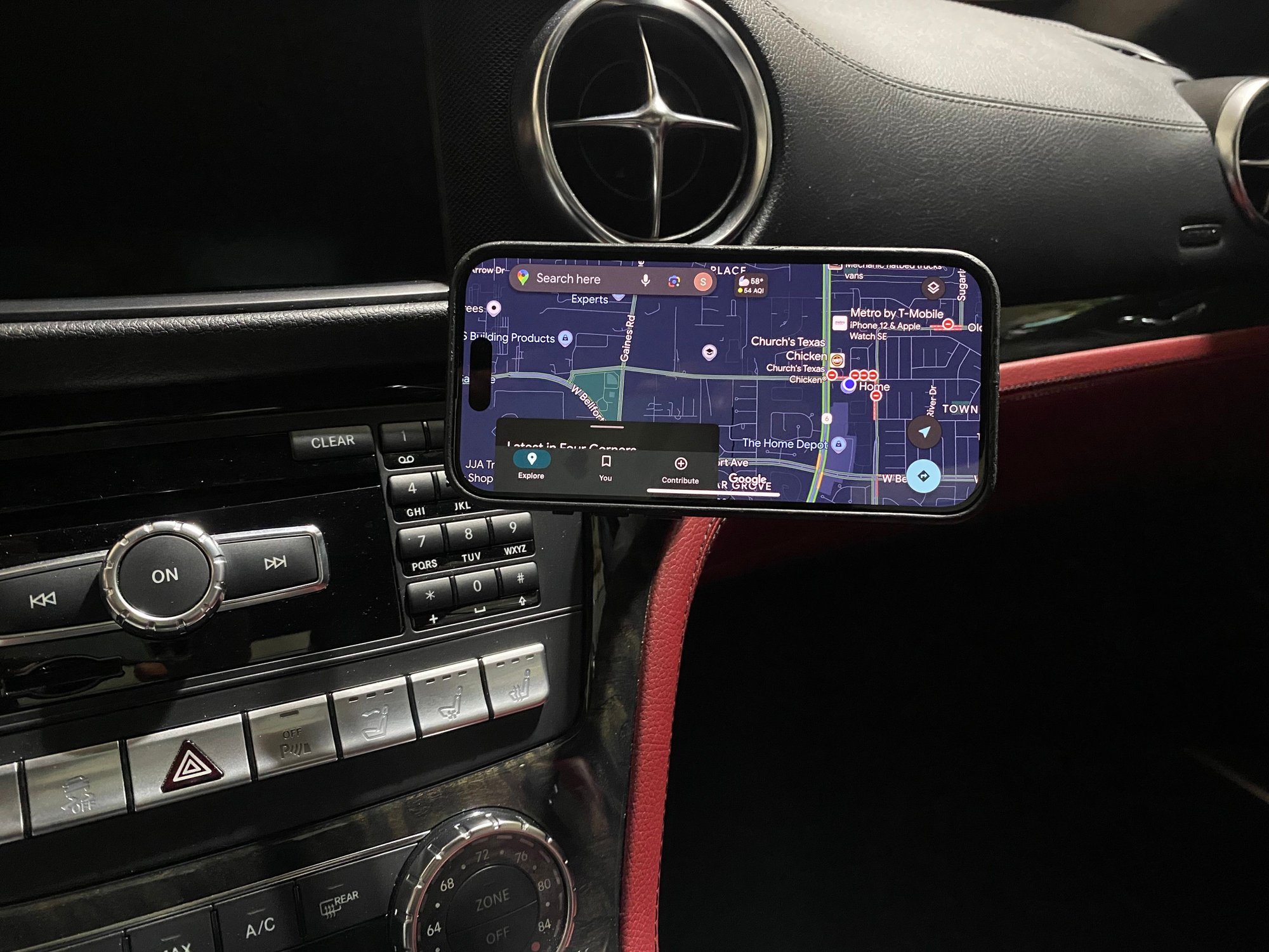

I really wanted something that would attach with suction as I was hesitant to use 3M tape on the interior. I found a mount that mer all my needs except the magnet was extremely weak and the phone slid around and occasionally fell off. None of the mounts with a MagSafe and suction cup attachment were small enough to mount where I wanted so I hacked together my own solution.
I bought this mount:
Amazon Amazon
The base allows full maneuverability and is small enough to attach on the trim. However, the magnet holding the phone was weak. So, I removed the rubber insert where the phone attaches, bought a cheap MagSafe charger with a strong magnet (I was only interested in the magnet, not actually charging) and used epoxy to attach the magnet to the base.
It’s the perfect solution for me. Someone should manufacture it.

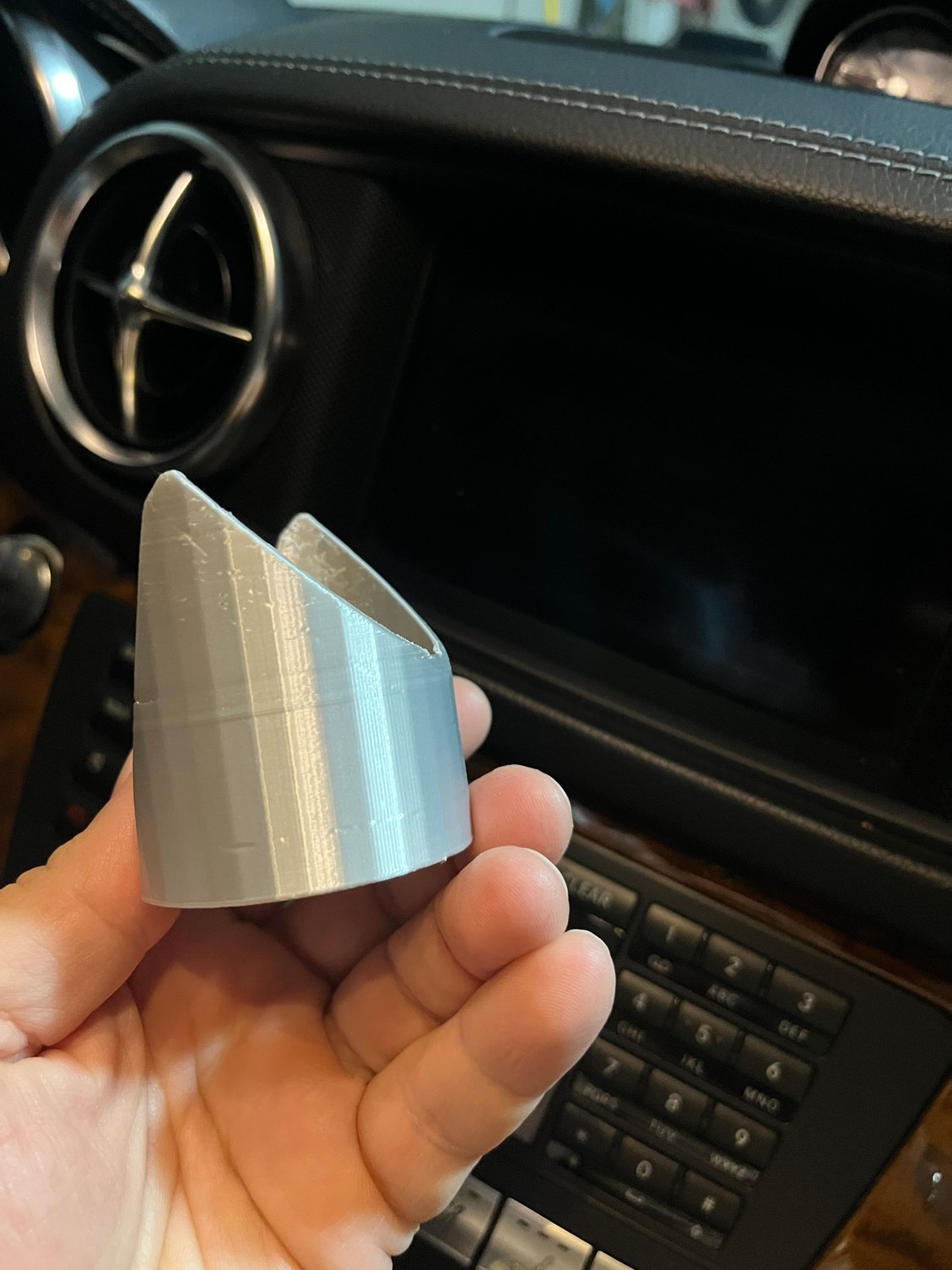

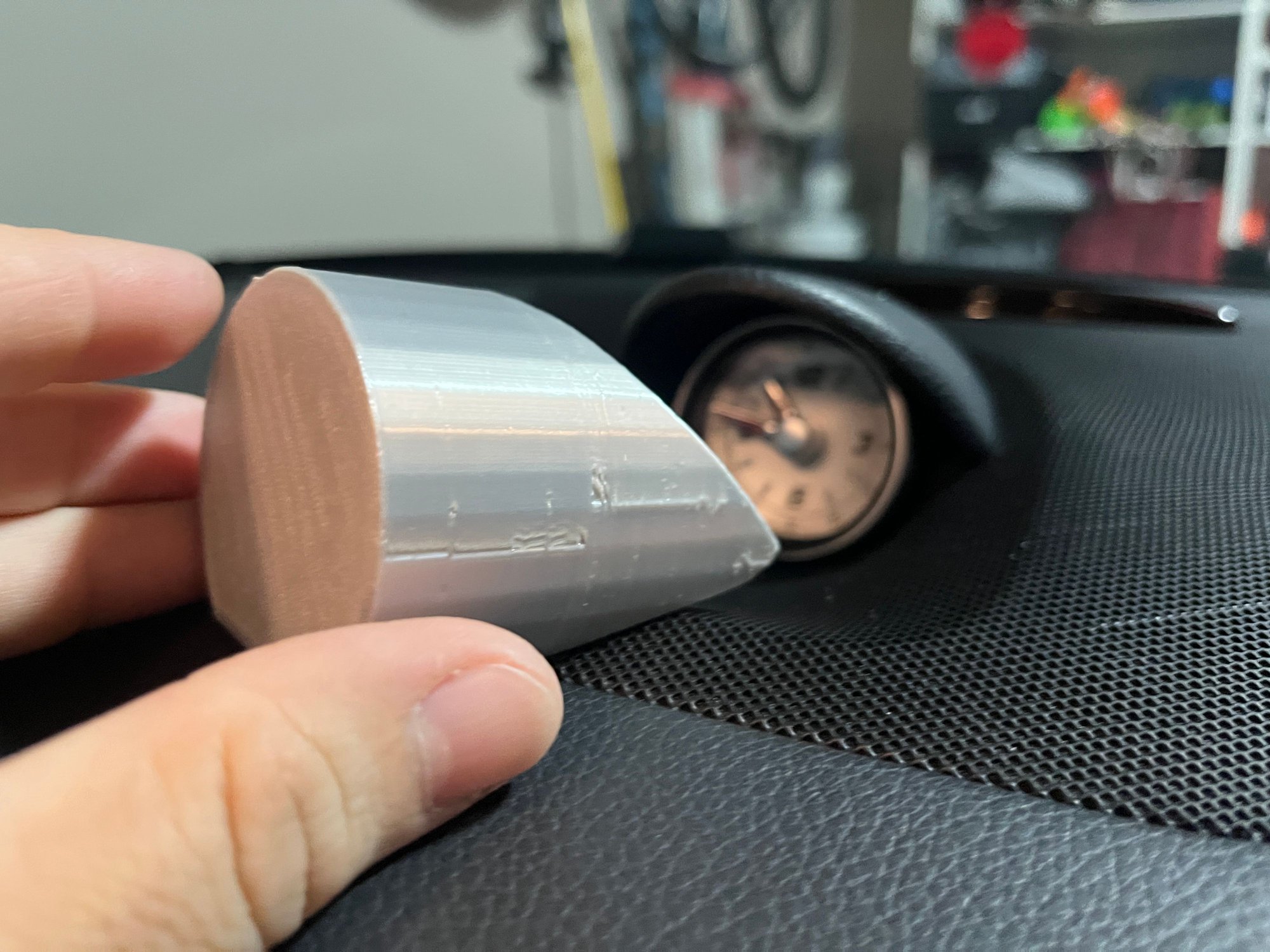

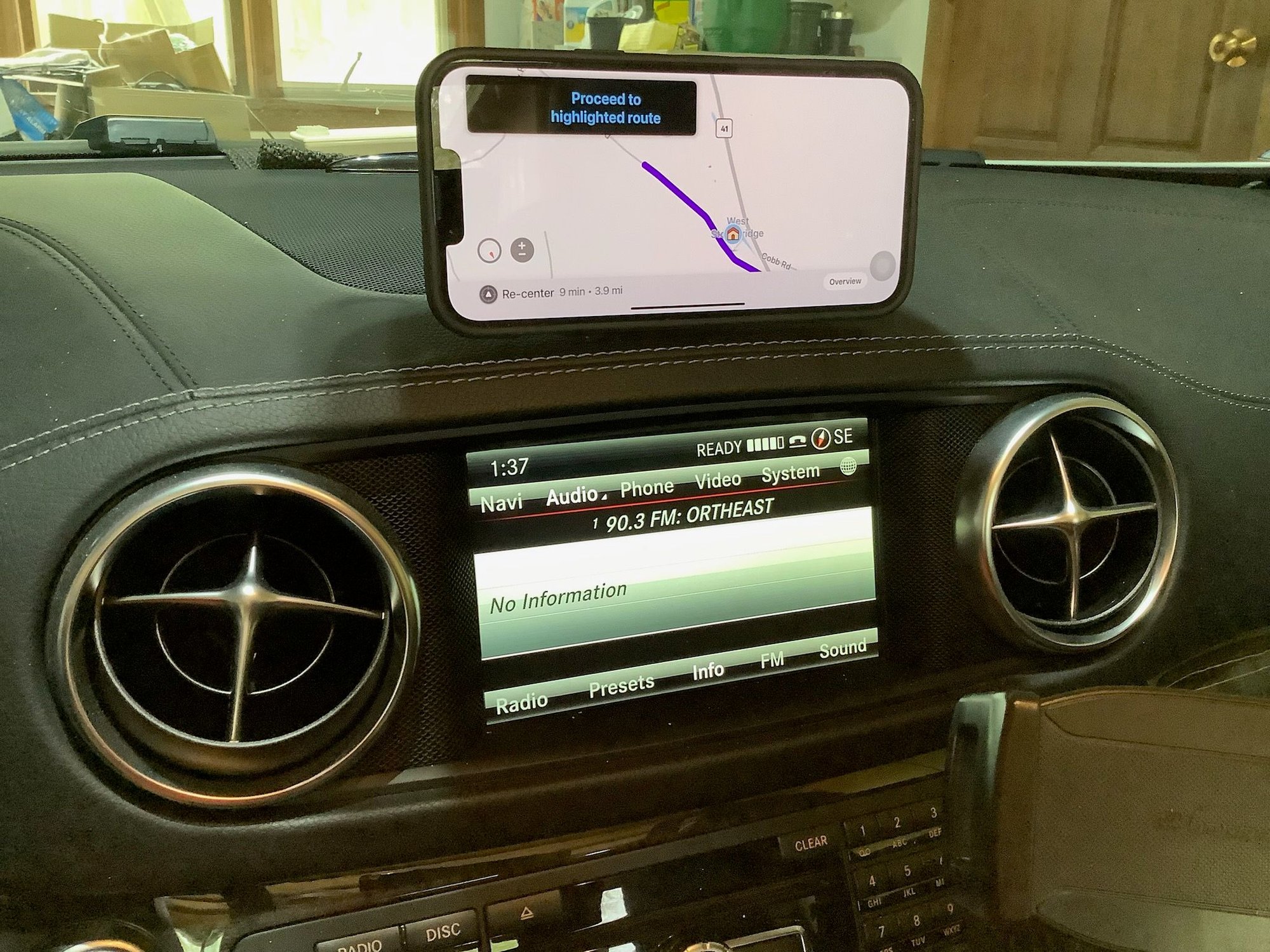

Custom phone mount
I purchased this safe-mag phone holder from Amazon
[url=http://Syncwire Fits MagSafe Car Mount... [ame]https://www.amazon.com/dp/B0CTGXQJJX?ref=ppx_pop_mob_ap_share]Syncwire car mount[/ame]
I liked the reviews and the price.
But I didn't want to glue it to any surface on the dashboard. I didn't want to damage it, so I thought of an alternative solution.
I noticed the dash clock was in a perfect position for the holder, and designed and 3D printed a cover that would serve as holding surface for the mount.
A simple cylindrical design that fits tightly, without damaging, the clock, slides into place and snugly stays in place, while providing the perfect surface for the mount.
Will come off without effort and no damage to the dasbhoard.
see pics for details.

Looks perfect. Even if plastic, wouldn't mind strong adhesive on something like this. Happy to buy one if you want to make more.

That was my main goal. No adhesive on my dashboard.
This little device will fit perfectly over the clock and provide the flat surface required for the holder.

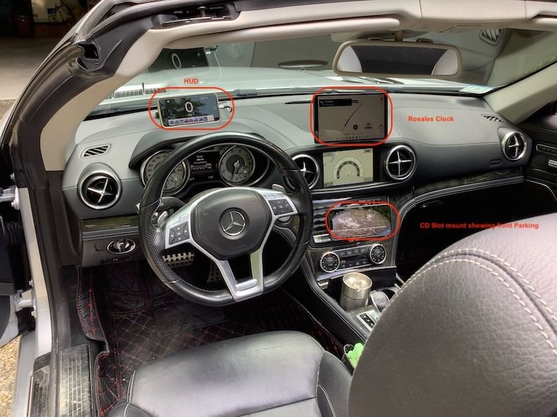

Thank you Mr. Rosales
Mr. Rosales made one for me. Works great with phone & split screen iPad. iPad cellular includes GPS chip.

I am glad you liked it!
That iPad setting looks amazing.
