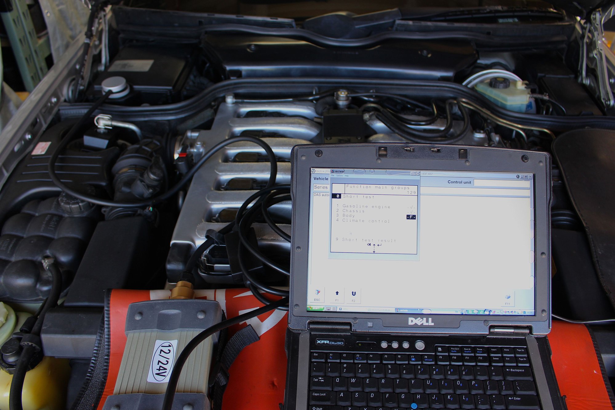

While MB diagnostic systems have gone thru several iterations, HHT, DAS, XENTRY, I can tell you MB Star system is the default factory tool designed to properly diagnose, test, and program various modules on every Mercedes Benz vehicle manufactured in the last 33 years.
The issue with Aliexpress versions is they are only reliable if you have the software properly installed, and good quality hardware (multiplexer & cables). That’s why you see some with older DELL 610’s, IBM thinkpads, or Toughbooks for these systems. DAS/XENTRY &HHT Emulator are designed to officially support only on a few computers. (They arrive preconfigured at dealerships). COM Port interface programing being key for proper reliable communication to the multiplexer. It also depends on the version of XENTRY/DAS you need. You didn’t mention what year, but assume you need HHT Emulator so your needs are more basic as far as software. But your hardware (multipexer and cables) have to be good quality as the 38 pin connection can already be a little finicky. Problem is, it’s a crapshoot to which vendors systems/hardware are reliable on aiexpress. Some use virtual machine which in my experience is unreliable.
I know one of the site sponsors sells complete systems he has tested and seems to have pretty good feedback. I have never used him, but it’s an option. Another option is to buy an HHT in the used market. I see them come up. I also think with quality hardware, you could put together a good reliable system if you are computer savvy. Also remember XENTRY expires, so you have remember to keep rolling back the date. I would do some research if you’re serious about getting a good MB Star system and only then make a purchase. You want a tool you can use now, not have a bunch of issues compounding your current problems.
Since your car isn’t running you may not have that luxury 🙁
Good Luck.

Thanks CR, to articulate 2 points further. When I made the AFT oil change, I found oil leak at the 13-pin plug connecting to the conductor plate and TCM.
(1) While replacing the conductor plate, I checked the plate looks good (to response you 6-year conductor is over, probably not). After all, I bought the full set of gasket, plug, conductor plate, 6L OEM MB oil (just use less than 4L only in the end).
(2) You may be right, the TCM may be already short. 6 years ago, I bought the same part number TCM from eBay. 2 days ago, I install the eBay TCM to the car and the situation is the same (Limp Home Mode). While starting the car, turn key(1,2,start engine...I feel it a bit 1/8second lag => donno if the TCM is not electronically connected).
I have contacted iCarsoft via Amazon already, the seller replied me CR-MAX can handle limp mode code and code deletion. The current action is paused, I am waiting for my Mechanic's repsonse - to help me doing the full check with MB Star SDS. Gut feeling - if I spent $ on aftermarket scanner (I have Foxwell NT650 elite with 38pin multiplexer 38-pin connector but cannot help) again, it may be wasting $ again. Thanks again for your advice.
