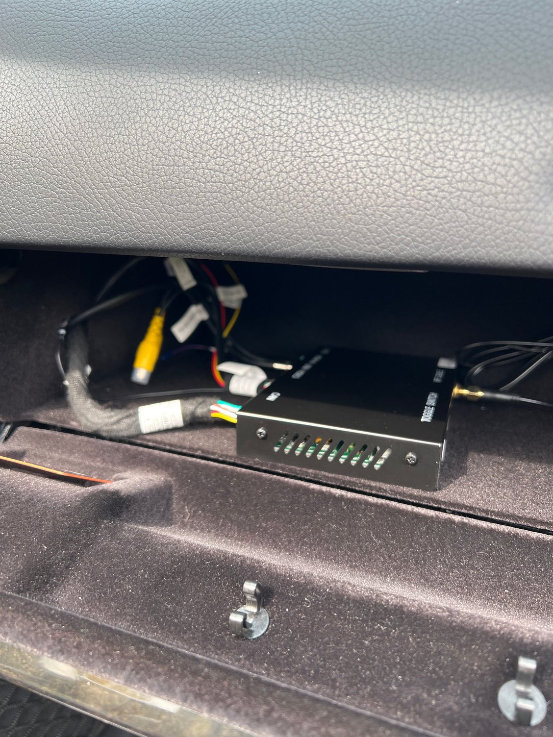

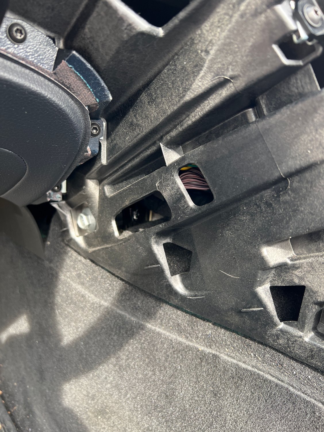

Installation is a bit of a bear when trying to fit everything back together. There was no way I could squeeze everything in where the radio goes, so I put the decoder in the glove box. There is actually a square knock-out on the left if you look closely. The other thing is the big connector I had to push over to a space on the left side by the driver's foot well. With some maneuvering, I was able to get everything to fit.

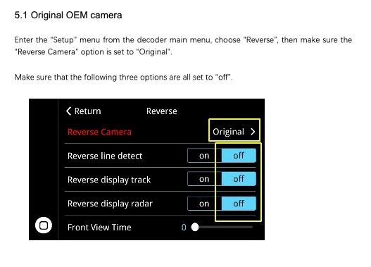

Once I set the music service to use cellular on my iPhone, the music problem is solved. Now I just need to figure out the reverse camera.

Well, got the camera figured out. I always helps to read the instructions. 😝

The big connector goes behind the plastic part.
Picture of glove box with cables thru the knockout.

I watched a video where the guy dropped the glove box and there was plenty of space to mount the car play unit out of sight. How long did it take you and do you think an average DIY'er could handle it?
There should be.
I did it in about 3 hrs, I guess. But I'm retired so I don't have a watch.
I just took my time since I was in no rush. Good point about dropping the glove box. I may try that if I don't like the decoder in the glove box. My only concern with where he put it next to the airbag is would that become a projectile if the airbag ever deployed.

The dip switch settings I used are 3, 6, and 8 on.

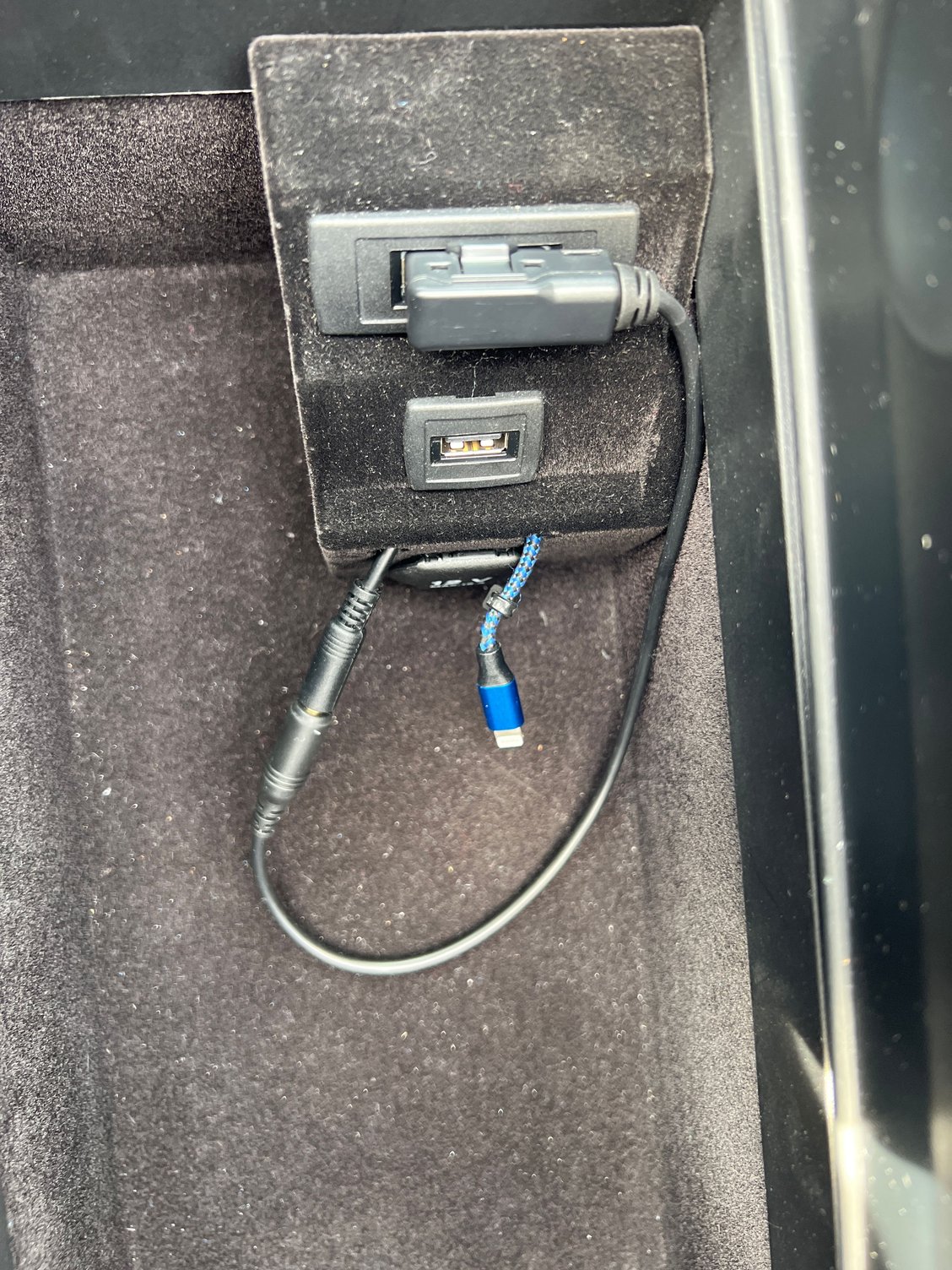

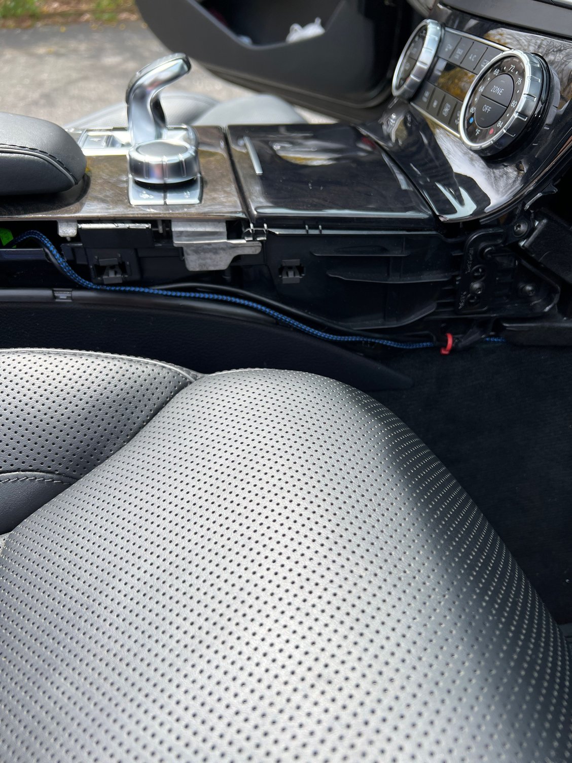

I ran the AUX cable and iPhone cable along the center console and drilled a couple of holes.
You need to remove the armrest top to loosen the connectors “box”. Then you can drill holes. I drilled ⅜” holes.

That would be required anyway. Didn't you use the phone to listen to music before via BT or USB?
Also, I used to remove the glovebox in prior radar/Dashcam installs. Super easy as you already have the side panel off; I think its just 4 screws...

Good to know. Does the rear camera work? Nice work, by the way.
Thanks. Yes it does. But it is important to follow instructions.
I should have gone back and watched the video. I removed the four screws, but it wouldn't budge. That would certainly make it easier. (Also, having the top down made it easier, especially when getting behind the seats to remove the armrest top.)
