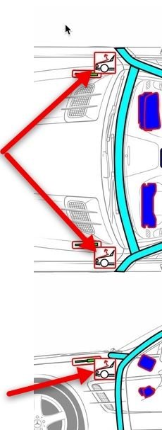

Originally Posted by rorywquin
THe QR code in my passenger door has this information
https://rk.mb-qr.com/en/231/
Thanks again!
I assume the pop-up rollover protection are the red arrows below.
I'm curious about the "pedestrian protection". Does the hood pop up to keep a pedestrian from hitting the windshield?

Originally Posted by JettaRed
Thanks again!
Yes they are the roll bars.
Yes nice ramp angle so the go flying over the roof .
If you go to the link and scroll down it describes the parts.
Does the R231 have a roll bar? (Again, I'm too lazy to go look. So much easier to just ask here.)
OMG I was gonna make a post with that question. MB must have given us some protection during a roll over. Surely there must be some hidden pop up roll bar someplace, or something right?

Hood deployment increases the distance between hood and non-compressible engine, creating more energy absorption and less potential for pedestrian injury. Similar idea as a crumple zone.

Note the pop-up rollover bars/pillars.
https://group-media.mercedes-benz.co...l?oid=10003111
On detecting an impending danger of the vehicle rolling over, the airbag control unit sends a corresponding signal to the roll over protection system. This is quickly extended behind the rear head restraints, helping to maintain a safe passenger compartment. The roll bars are extended not by spring force, but - for the first time on a Mercedes-Benz - by pyrotechnical means, using a gas generator.

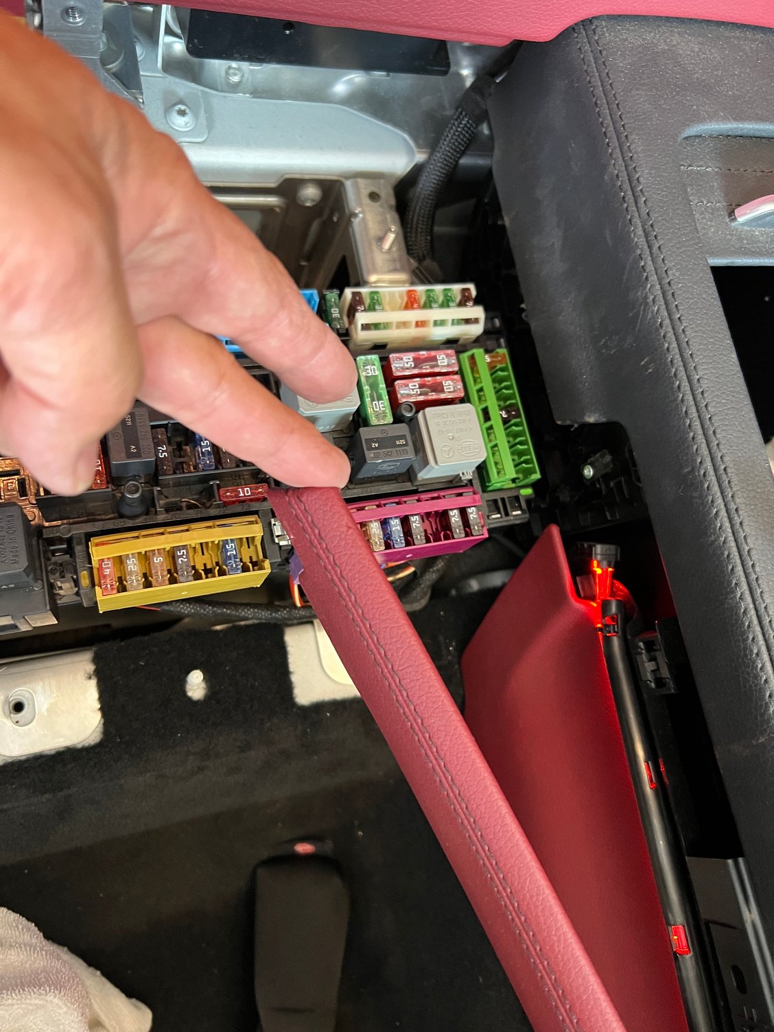

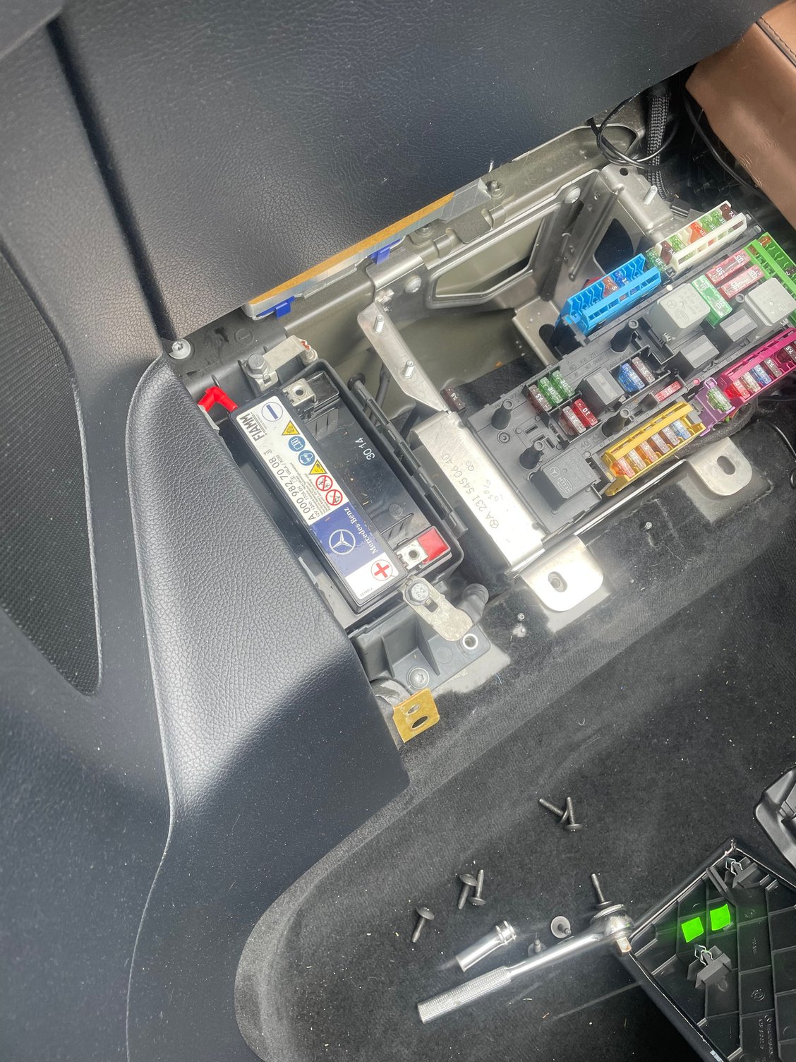

Originally Posted by ThatsMyDawg
Thankfully I was able to replace both of my batteries this morning. So glad I did it first thing, because it’s storming like no other right now. Everything went smooth and easy and was finished both in 30 minutes total.
I replaced both batteries today and want to thank everyone that posted here for the valuable info that was shared. TMD’s 30 minute record for swapping them out remains safe as it took me just under an hour to accomplish the task.
One additional tip I’d like to share is that I took my time on the aux battery because I didn’t want to cut those tabs if I could avoid it. I removed (only 1/2 way) the center console upper trim piece from the rear of the console, adjacent to the battery cage. By pulling that piece out I was able to gain a little more wiggle room to pry the two tabs away from the console and free them. I’ve attached a picture showing the trim piece disengaged.
Is it a case of just pulling it?
