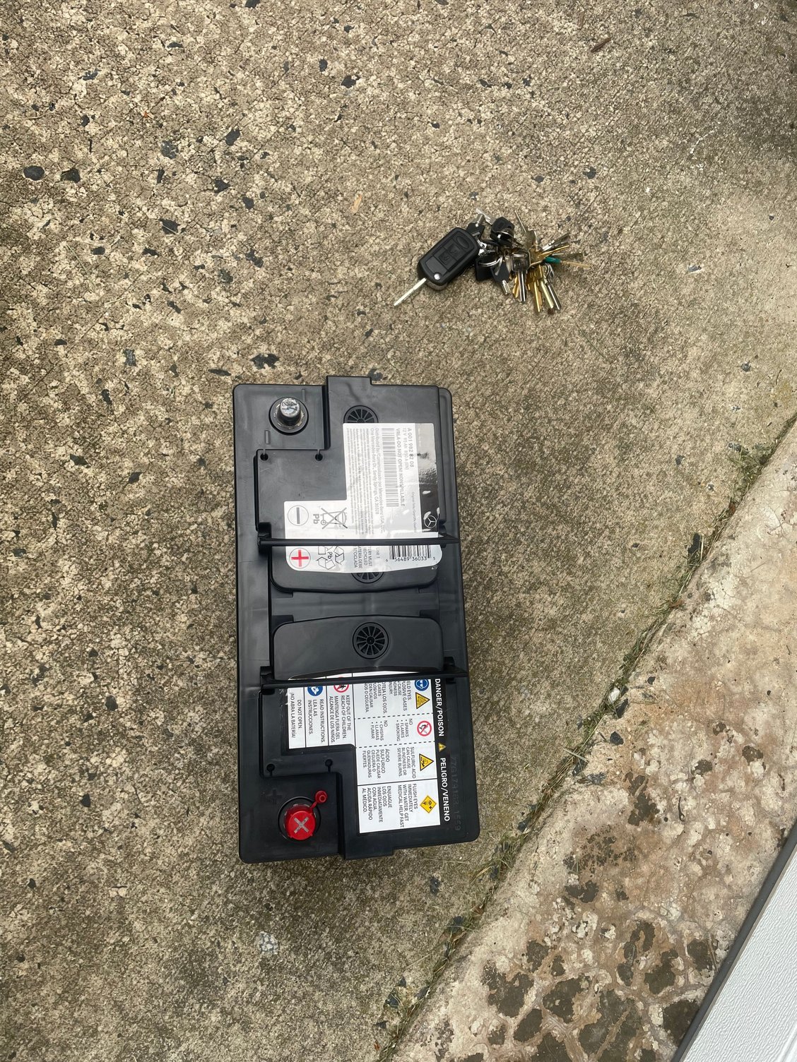

Old May 20, 2022 | 02:17 PM
rorywquin's Avatar
Joined: Jan 2017
Posts: 1,040
Likes: 234
From: God's County (Yorkshire)
Shanks’s Pony
If you go into the boot / trunk and keep removing liners, you will get to the cranking battery (2 layers and some polystyrene fillers).
Pigtails are a waste of time & a placebo effect. Use the jumper points as recommended by MB and you will be fine.
I’ve been keeping my batteries healthy from the jump start points for 5 years now (19,000 miles). I had the battery tested (because I’m getting "blind spot assist" & "lane keeping assist” warnings) at a Varta (MB OEM battery manufacturer) authorised tester yesterday and he says the batteries are perfect.
I’ve never had a problem with my batteries even, with the limited use my car gets.

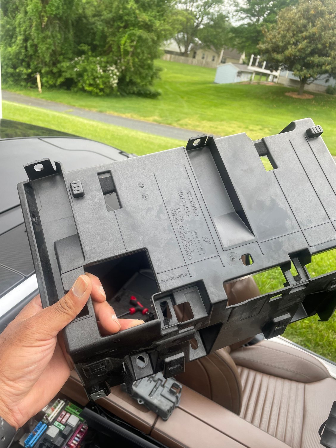

Yeah I just purchased the replacements for the two batteries yesterday from MB. I plan to install them Sunday, if it is not raining.
The small battery is easier to access if you put the top down. That way you're not squeezing in the tiny space behind the passenger seat.
FWIW, I did not have a lot of difficulty removing the plastic cage on the aux battery. You just need to jiggle stuff around. I did find, however, that the aux battery I got had the terminals in a slightly different orientation and I could not get the protective plastic cage back on. So, I didn't.

Shanks’s Pony
All good info thanks. I’m going to start with the AUX and see if that helps. As mentioned, I had a Varta (OEM in my car) agent test mine (cranking battery) and they said it is fine.

Buy the OEM battery if you want to ensure the terminals will be identical. Agree that it is much easier to install the AUX battery with the top down.

Thankfully I was able to replace both of my batteries this morning. So glad I did it first thing, because it’s storming like no other right now. Everything went smooth and easy and was finished both in 30 minutes total.
