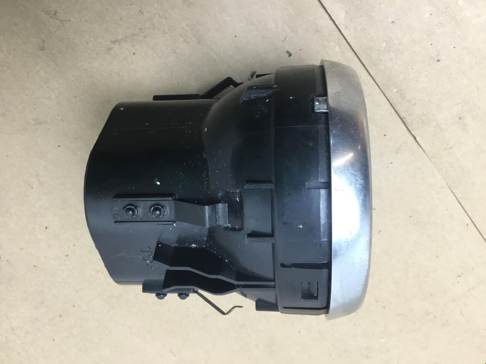

Anyone ever removed one of these? I can't find a YouTube video for the R231 but similar MB style vents pop out using some kind of pry tool. I'm trying to isolate a little rattle and I think it may be in one of the vents. Just trying to find out if any of out intrepid forum members have any guidance. Thanks.

Missed your post but, there are 4 clips holding it in.
Sometimes it helps to look at the part to understand how it’s held in place
Good Luck

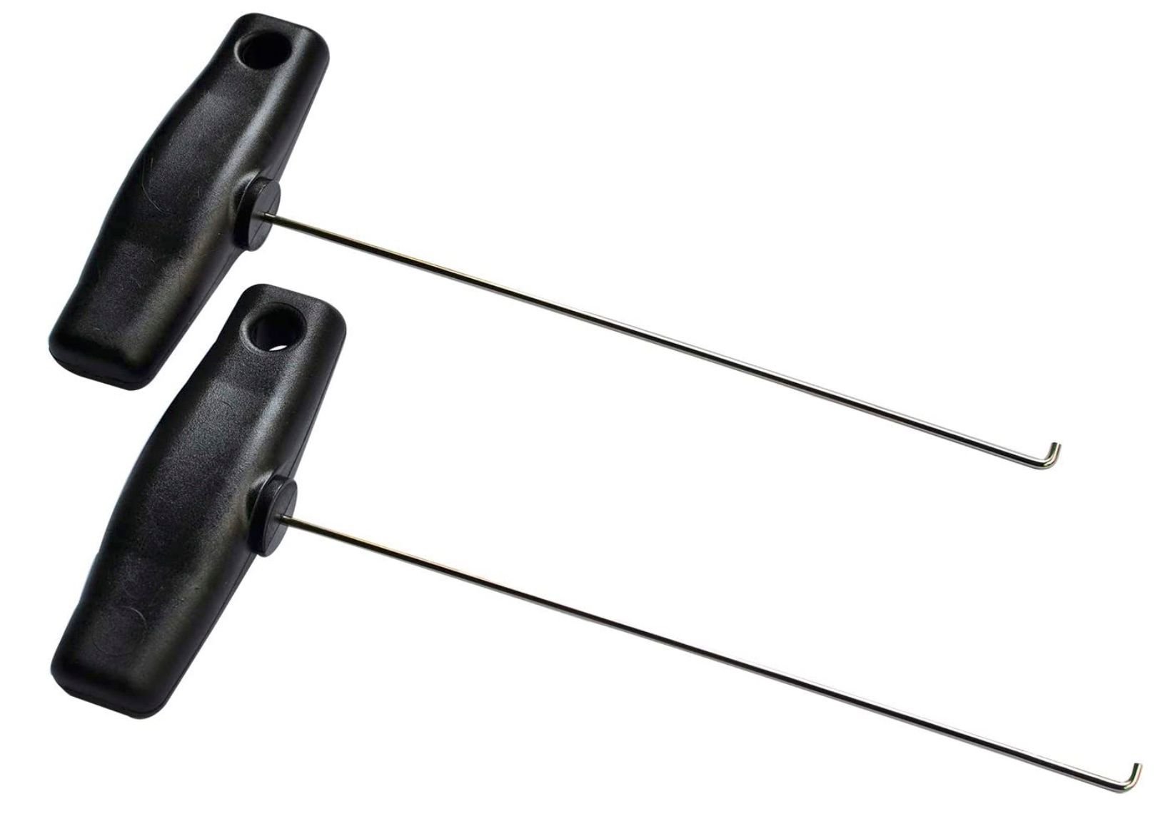

Trim pullers. Used as a pair they balance the forces on the fragile plastic trim pieces.

I could see those hooks working for that application. Smart!
I typically use thin flexible sheet styrene plastic (sometimes business cards can work too) and get them under the clips as I push the vent in.
I use one under each clip, in this case 4.
in case OP wants to try the hook method mentioned above:
Amazon Amazon
Good Luck

Once again, forum members to the rescue. Thanks, gentlemen, "pry pieces" ordered.
