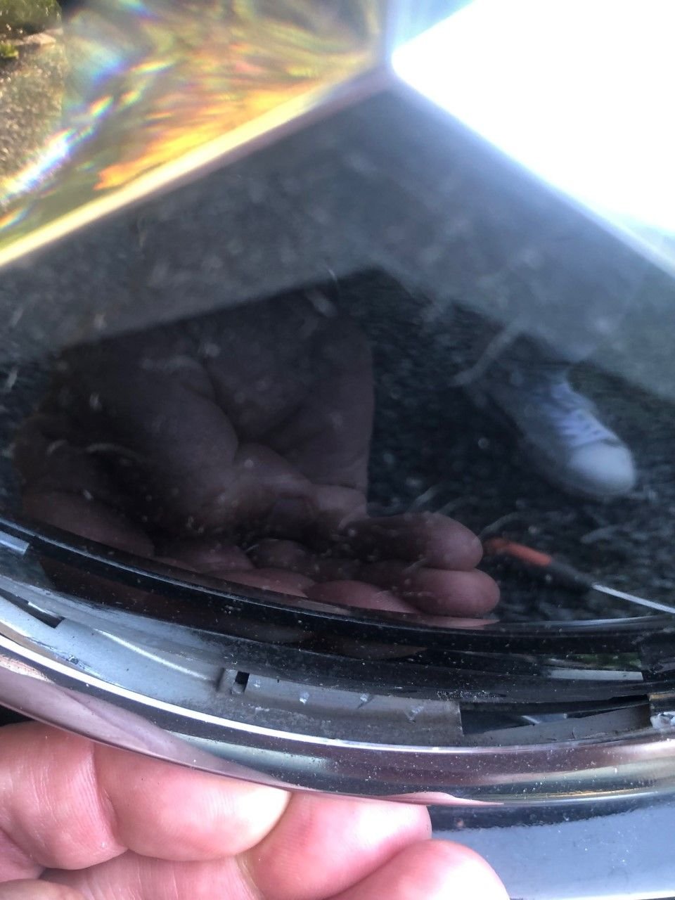

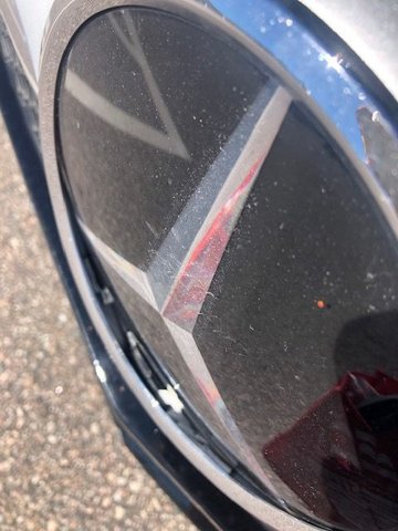

So I just noticed the MB star in my grille is pushed in a bit:
I was hoping I could open the hood, reach down and push it back into place, but that ain't happening. Anyone know how much of this I have to remove to get my hand behind the griolle?

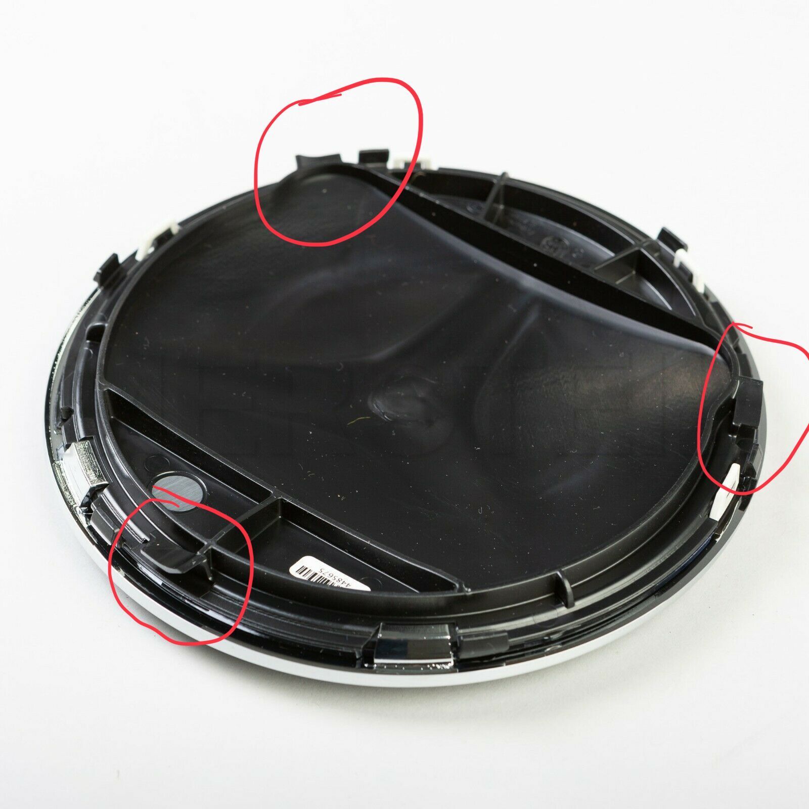

Here’s a pic below of the clips that hold the star onto the grille.

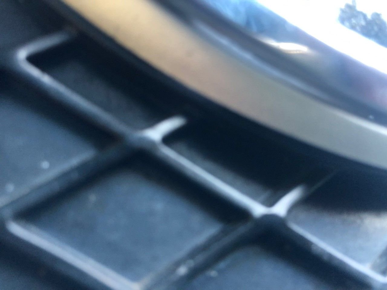

@crconsulting is correct it comes out the front with a twist. On my car i usually reach in and grab the back and apply pressure on both sides while turning.
Never seen one pushed in like that.
My grill from inside the hood.

Okay, suction didn't work, the star won't budge. There are three parts here: the "glass" star, the "chrome" trim ring, and the matte silver grille fin piece. I feel like I can pull the chrome trim forward, but I don't want to go so far as to remove it as I don't know whether that'll help me (or I'll break it). The matte piece feels like it's too far forward; I can fell a gap on the bottom between it and the black part of the grille, but I can't seem to push it back into place.

Yes, the same way. See pics. I posted above for the location of the tabs that hold it down.
