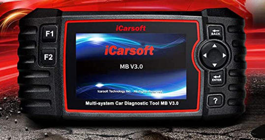

Get yourself one of these! It's small and fits nicely in the little storage behind the driver's seat. EVERY Mercedes owner should have one of these in their car all the time (or an equivalent scan tool). You would at least know what is causing the problem and maybe be able to temporarily (or permanently) "fix" the problem. Make sure you get V3.0!
