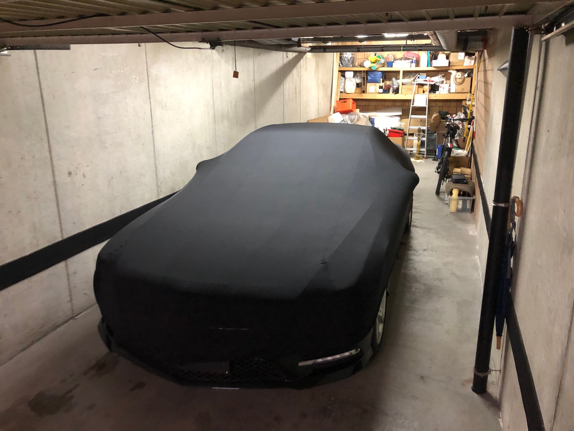

Hello,
I bought an SL 350 from 2012.
it will be delivered in 2 weeks and it will be put into storage for 3 months.
my question is how long will the car’s battery keep up just standing still so I can still unclock and start the car?
Is it better to keep the car unlocked so the alarm does not empty the battery even sooner?
there is no electricity in the garage for a charger. I will also leave the window a bit open to I can open the door even with a depleated battery.
any advice or experience welcome.
jan
