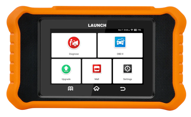

Originally Posted by RonNSoCal
I do not own a scanner.
Spend the $140 (or $160 from Amazon) and get the LAUNCH Creader Elite 2.0 BENZ. Then you'll never have to guess again.
https://kingbolentool.com/products/l...c-tool-scanner
Without the ability to do my own repairs, the only value I can see in having a code reader is to keep a repair shop from giving me bogus information. This forum is an invaluable resource for this and the independent repair shops available to me are reputable.
Totally up to you, but a proper scanner will help troubleshoot whether the problem is electronic/electrical or mechanical. If there are codes, that will help people help you and maybe keep you from wasting time poking around the wiring harness. If no codes, then it will help confirm you are on the right track. But, again, totally up to you.
