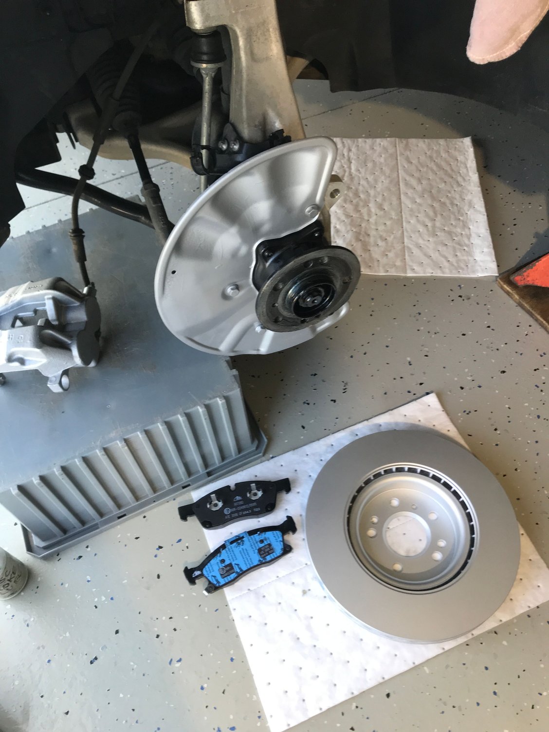

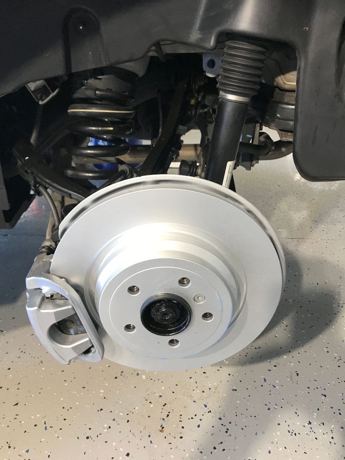

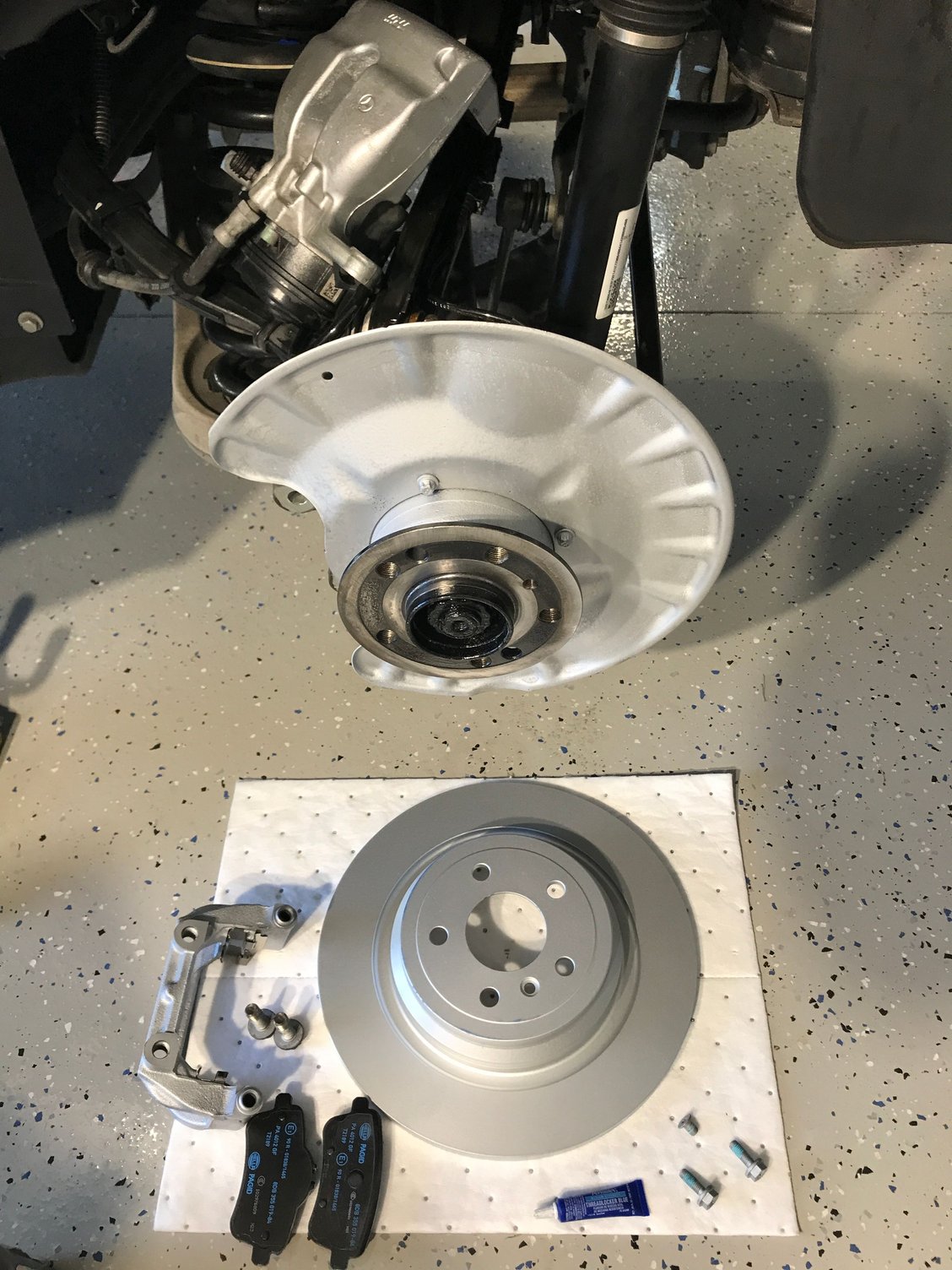

If you're replacing the rear brake pads/ rotors, you need to do some research on going into the menu and retracting the emergency brakes. It's real simple, all right there in there in the onboard menu. Incidentally, while you're there, FYI, you can flush the brake fluid in the R231 like old school. The pics attached are from recent work I did on my ML350. It has 44k on her, it didn't need brakes, I just was looking for something to tinker with as I'm an old MB tech/ restoration tech from many years ago. The pics are to motivate you, but don't go by what you see, I work on everything as if it's going into the Smithsonian Museum. All new brake parts were OEM ATE brand from Autohaus AZ that now ships from multiple locations.
Thor
