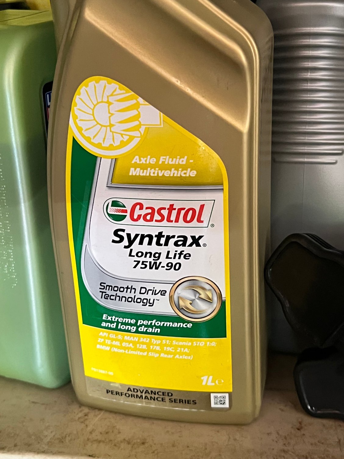

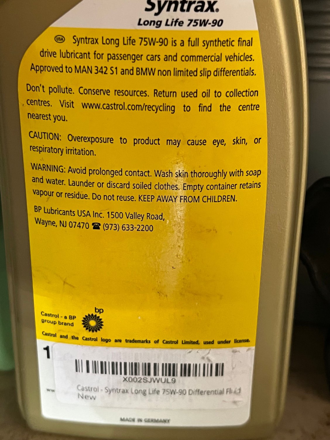

Rear Diff Fluid Change
I have 56,728 miles on my 2015 SL400 and decided to change out the rear differential oil. There’s no scheduled maintenance for doing that unless you have a limited slip differential. Mine is non-limited slip. To my surprise, the stuff that drained out looked like coffee (without cream and sugar). The stuff I put in was Castrol Syntrax 75W-90 and looked like golden honey.
Has anyone else change their rear differential oil and was it black?
