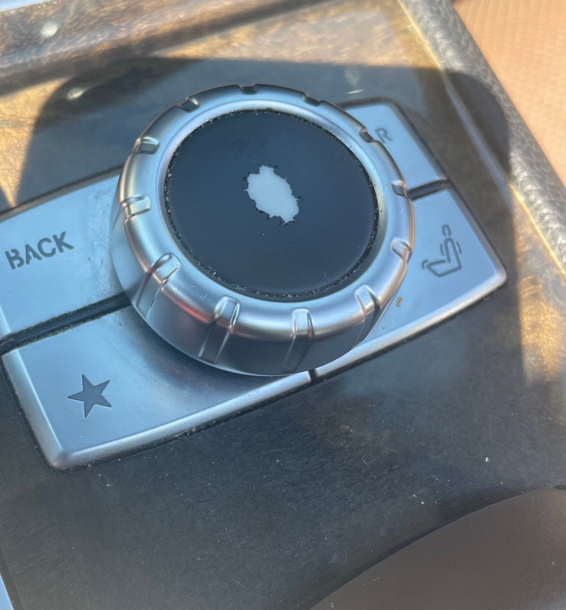

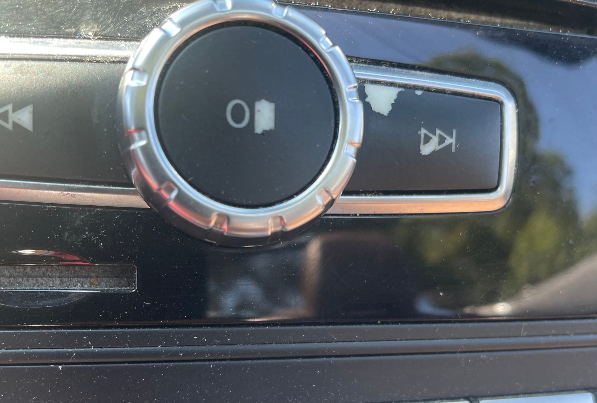

My buttons are starting to shed the black and show the white that is under them. The damage is from my fingernails. No matter how much I try to keep them trimmed they scrape the buttons over time. Radio button, the round knob by the center console, Steering wheel buttons, etc. I will make a project out of it and replace all, OR I might take all the black off and apply something like paint, or stickers, or I don't know it place of the black. Would you be interested in a how to video and that project?
Do you by chance use lotion on your hands? Could also be as simple as changing HOW you push the button.
Those are definitely going to be high wear areas no matter the mfg’er.
Also, with second hand cars, we never know the history. (i.e. what products used in detailing)
Good Luck

are your steering wheel buttons similarly worn?

No. I can see “hints” of them starting to wear/chip, whatever, but it’s barely starting. At the current rate it will be a few more years before they are noticeable like the others...

Most times I do not use lotion on my hands, but I do use it from time to time.
I have been trying to teach myself and get into the habit of pushing the buttons differently. The funny thing is I NEVER use those arrows to toggle right and left up on the radio, but they are still worn. I guess my other finger hits it when I’m turning the knob. I have started using the steering wheel volume up and down.
