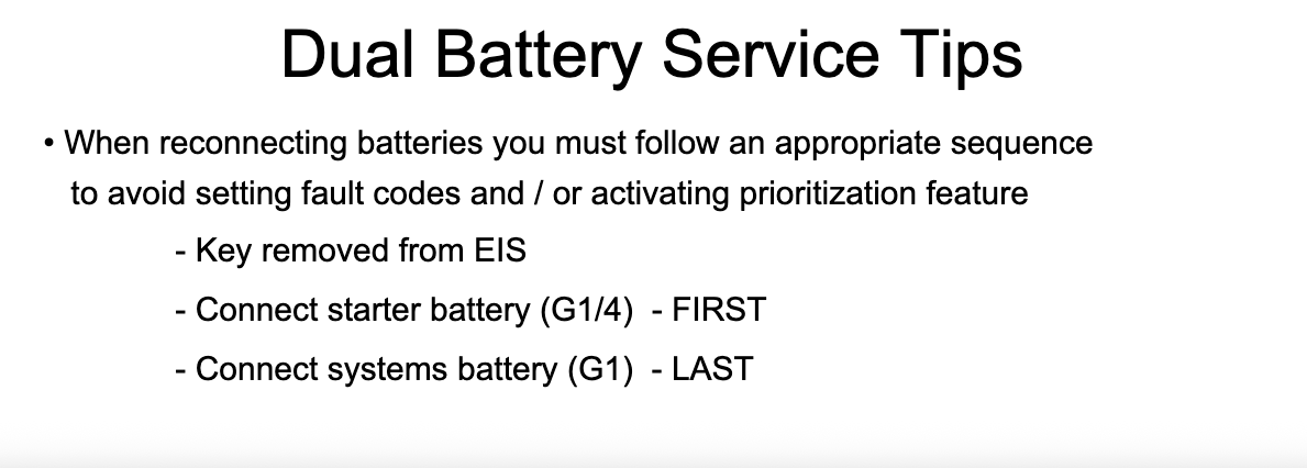

To answer your question, is it probably a good idea to disconnect the consumer battery. Read the attached document. It talks about connecting the starter before the service (consumer) battery. You can assume that it is OK, if not recommended, to disconnect the consumer battery when replacing the starter battery.

Below is a screenshot of the top of p. 37.
