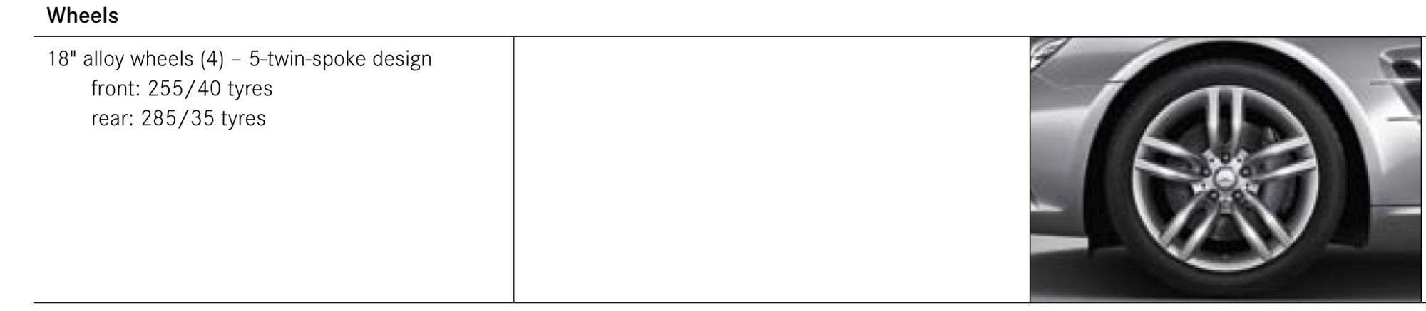

Thanks so much!
So what did the standard 18" rims look like on the 2013 and up? I don't think I have ever seen a pic of one with the non AMG wheels.

see below
