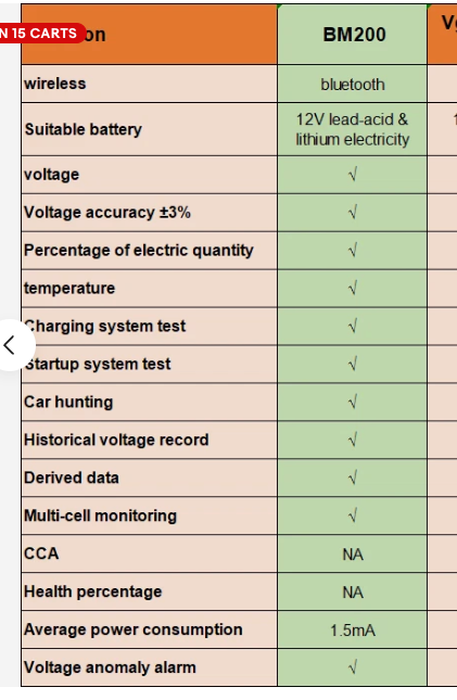

Good question. I think you can get some kind of battery monitor with a Bluetooth connection let you record current draw over time.
https://ebay.us/m/KvuuPn

I'm thinking you could review the historical voltage data with the doors open and then with them closed, and conclude whether it makes a difference.
